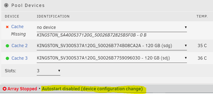

April 11, 20224 yr Author Thank you @limetech, I missed it in the rc3 or rc4 release notes but this has finally been implemented, screenshot is from v6.10rc4:
