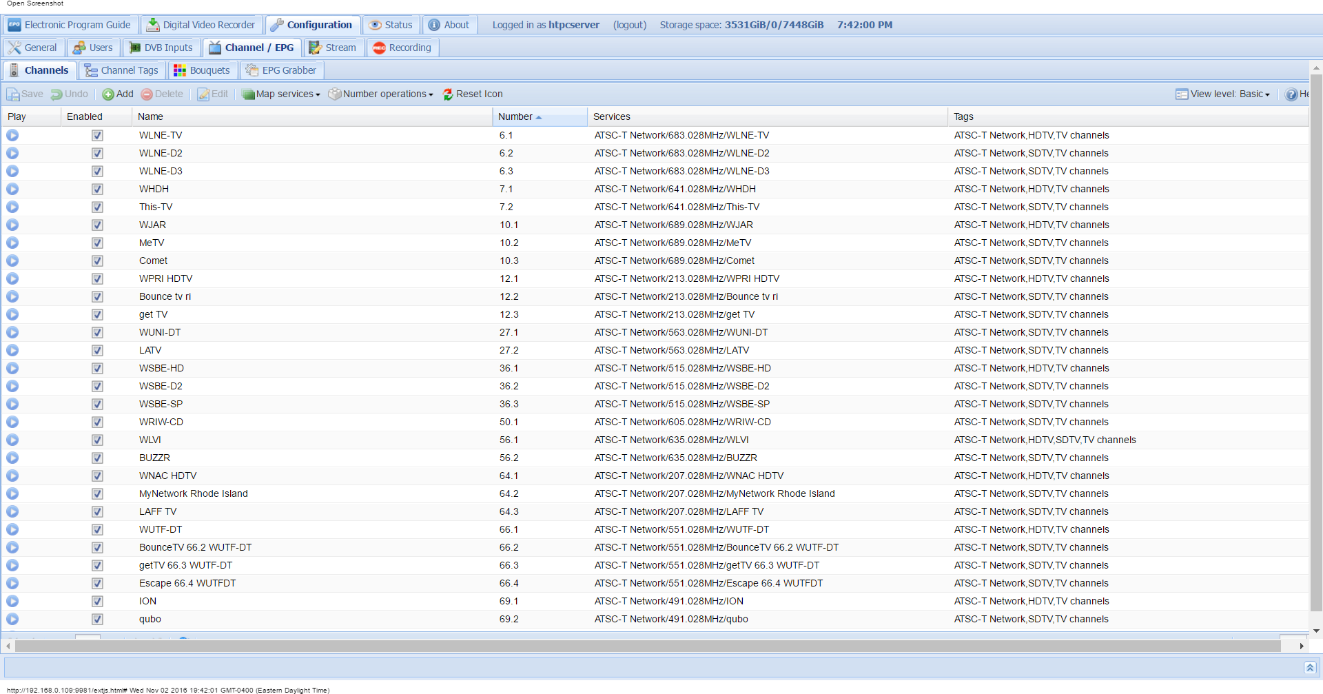

I was using tvheadend on Ubuntu and I'm trying to get it set up on unRAID along with all the other stuff I had running.  I have the basic functionality working but I'm running into an issue getting the guide data into tvheadend.  I'm using webgrab++ and think that is working properly.
I seem to be missing the EPG modules tab from tvheadend. I tried all view levels and I'm logged into admin account.  Any idea what is going on with this or what I could have done to lose the tab?
Configuration ==> General ==> Base ==> User interface level
I'm guessing it's set at basic....  ;)
Yup, and of course I only changed the view level on the individual pages...  :-[
Thanks!
