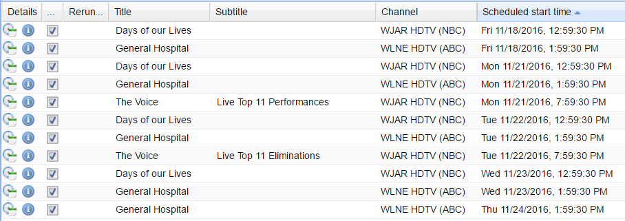

So, I think something is happening when the guide is updating.  There were only single recordings scheduled when I went to bed but now shows doubles again for today.  Here is the overnight log.  Is there some other log that shows more details?

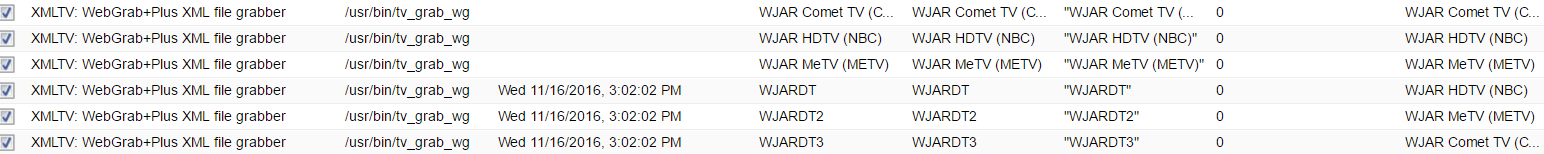

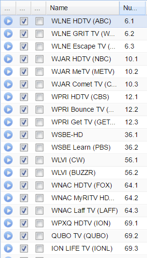

Do you have multiple channels of the same one configured?
I'll have to verity all this when I get home but I thought I had it set to update once a day. Apparently not.
I don't think I have multiples under the 'channels' tab but will verify this as well.

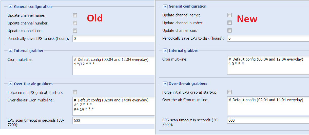

The config is in multiple files and I'm not very familiar with them, so better with screenshots.
So, it looks like I don't have duplicate channels enabled in the 'Channels' tab.
I did find duplicate entries in the 'EPG Grabber Channels tab.  I'll delete the ones that don't show any previous update time.
Added save guide to disk at 6 hours and changed cron jobs to only run once at 00:04 (I think).  Old and new settings attached.

Still getting the failed recordings due to 'time missed' error. New log from today is attached (zipped for size).
The upcoming recordings does not show any duplicates.
