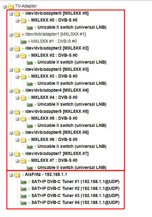

yes, works fine with TVH, Combo of SAT & Network Tuners, preferable SATIP Standard, but TVH also has native HDHR support afaik
5 hours ago, eric90000 said:
If anyone has a recommendation for a DVB-S2/DVB-T2combo tuner for Freeview & Freesat that is compatible with this TVheadend docker image (Unicable compatible for the satellite would be a big bonus) I would greatly appreciate the steer in the right direction!
im using a DD Max S8 as unicable card
here as sample from my setup, unicable pcie card and a network SATIP Tuner
Thank you very much, that is great to know a combination of SATIP and tuner cards works well for you.
I will check out those devices you mentioned. From what I gather from reading online, the general consensus seems to be that the SATIP approach is the easiest, as it rules out driver issues with physical PCIe cards. I had been trying to find a Digibit R1 SATIP device, which could be paired with something like a HDHomeRun for DVB-T.
I really appreciate the screenshot of your setup - it will be handy when I come to setting mine up.
and here is the config for my hdhomerun. Nothing special needed in the docker xml to make this work, and appears rock solid.

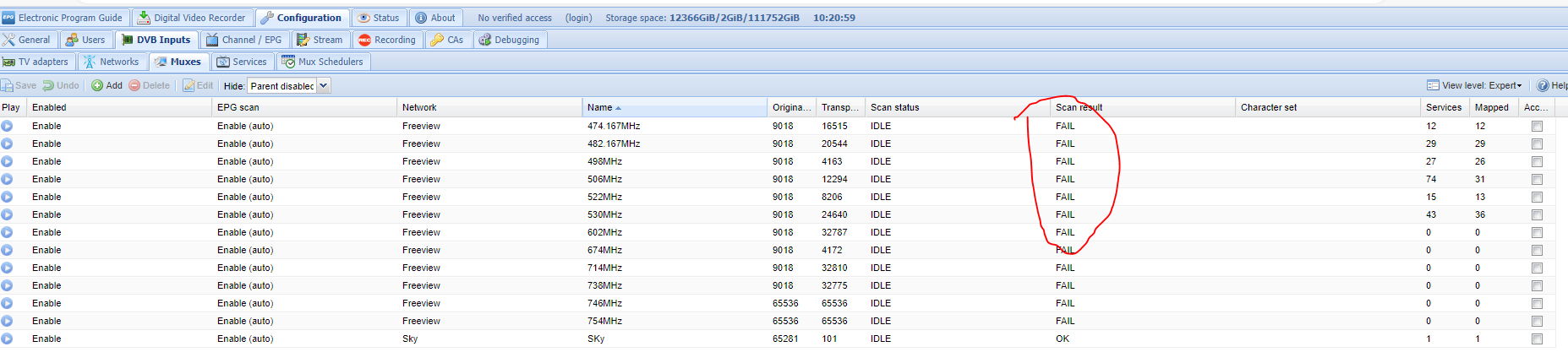

**** BELOW FIXED **** Turns out the HDHomeRun tuner was going faulty. Replaced tuner and now working
Hi, i've been using this TVHEADEND docker for many years without issue.
Tuner: HDHomeRun Connect Quatro HDHR5-4DT, Firmware latest - 20231214. I'm in the UK using DVB-T/T2.
This is used through Kodi and OSMC and I have just recently noticed I can't view any channel.
Checking the docker I can still see the HDHomeRun and get green lights on all 4 tuners.
However when I look at the Muxes the scan results are all set at failed. You can see I previously had services and these were mapped.
No matter what I try I cannot scan the Muxes which is why it is not working through Kodi. I also have an HDMI to iptv converter which allows for Sky to be distributed via TVHeadend and that still works OK.
I have tested:
- I do have a strong reception on my TV Ariel
- Using HDHomeRun software on the PC I tune into stations and can watch TV (So I know the HDHomeRun unit is working)
- Using HDHomeRun software on a Fire Stick I can watch TV so again the HDHomeRun unit is working.
There has been some Firmware updates on the HDHomeRun which were automatically applied. As I normally watch TV through Sky I did not take much notice as I don't the HDHomeRun as my daily driver.
Has anyone else using HDHomeRun Quattro or Duo running through TVHeadend noticed their system not working in the last few months?
Any suggestions on what I can do?
Many thanks

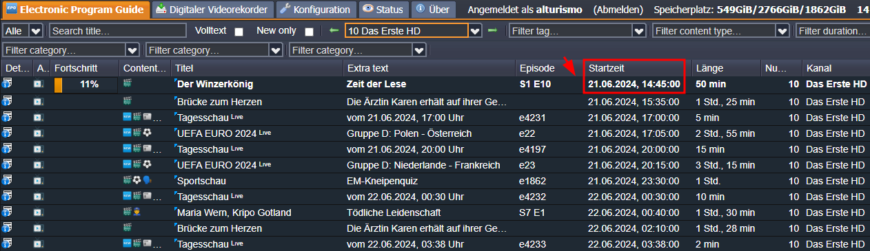

i assume we talk about this and you prefer to have the day (sample friday) written there
Exactly right. It is a lot easier ensuring no interfering recordings are set when you can see the day as well. To me anyway 😀.
