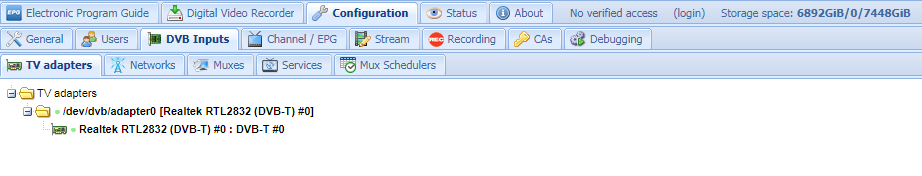

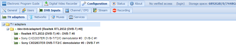

Unable to open /dev/dvb/adapter0/frontend1
So I have a DVB-T2 adapter with two frontends/chips - one can do DVB-T and the other can do DVB-T2 (and DVB-C, which I'm not using).
I can configure it in tvheadend and everything works fine. I'm mapping two networks - one onto each - and they work nicely, one doing DVB-T and the other doing DVB-T2. All channels are discovered and can be played.
So far so good. This is how the config looks like :
Now, I go and restart the container.
When it comes up, I see these log messages:
2021-03-22 17:43:21.775 [   INFO] linuxdvb: adapter added /dev/dvb/adapter0
2021-03-22 17:45:04.803 [  ERROR] linuxdvb: unable to open /dev/dvb/adapter0/frontend1
(note it waited about 90 secs between them). From that point on, frontend0 (Realtek chip) is functional, but fronend1 (Sony chip) disappears. Obviously the network/mux and other channels / services that are attached to it are not functional. In the configuration, you see this:
The second frontend is just gone.
Neither further restarts, nor Unraid reboot or adapter removal/insertion fixes this.
One way I found to work around this is to go to /config/input/linuxdvb/adapters in the container, remove the adapters config file, and restart the container. At that point the config file is re-created and lo and behold - both frontends are back in business. Obviously they have new uuids so I need to re-tie them to networks etc. - at which point they become functional again.
The next container restart loses the second frontend again. Every time.
Any help as to how to tackle this would be greatly appreciated.

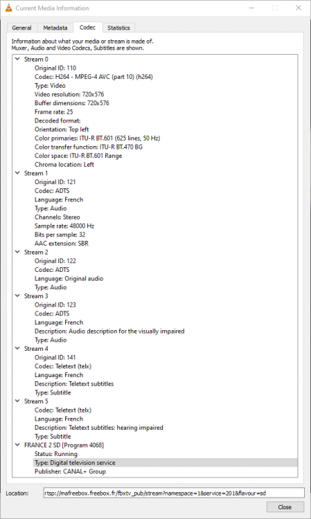

Hello
I'm trying to get an IPTV RTSP mux to work.
My Internet provider allows to stream local (French) TV channels from the "router box" (called Freebox). They provide a .m3u from which I extracted one stream for testing purposes:
rtsp://mafreebox.freebox.fr/fbxtv_pub/stream?namespace=1&service=201&flavour=sd
This URL works when opening in VLC.

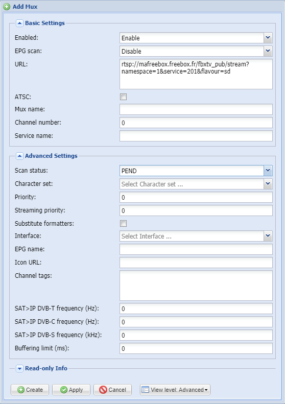

I created a IPTV network and a mux with the URL:
And scan fails:
2021-07-30 00:00:40.901 epggrab: rtsp://mafreebox.freebox.fr/fbxtv_pub/stream?namespace=1&service=201&flavour=sd in Freebox TV - registering mux for OTA EPG
2021-07-30 00:00:40.904 subscription: 0010: "scan" subscribing to mux "rtsp://mafreebox.freebox.fr/fbxtv_pub/stream?namespace=1&service=201&flavour=sd", weight: 5, adapter: "IPTV", network: "Freebox TV", service: "Raw PID Subscription"
2021-07-30 00:00:55.900 mpegts: rtsp://mafreebox.freebox.fr/fbxtv_pub/stream?namespace=1&service=201&flavour=sd in Freebox TV - scan no data, failed
2021-07-30 00:00:55.900 subscription: 0010: "scan" unsubscribing
I tried to use the local IP of the router (192.168.0.1) and I have the same error (works as well with VLC).
I tested and the Docker container seems to access the port with no problem:
root@Tower:~# docker exec -it tvheadend bash
root@21234e9f20e5:/# nc -vz 192.168.0.1 554
192.168.0.1 (192.168.0.1:554) open
root@21234e9f20e5:/# nc -vz mafreebox.freebox.fr 554
mafreebox.freebox.fr (212.27.XXX.XXX:554) open

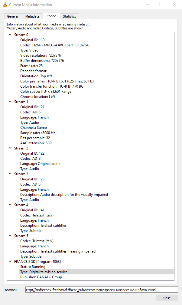

Here is what VLC has to say about the stream:
Any idea why this wouldn't work?

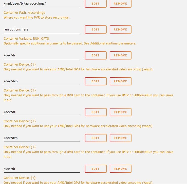

docker tvheadend container is getting corrupted. The dri/dvb lines from the template is enumerating a dozen times, not sure why.
I deleted the template and re-downloaded from scratch, and then removed the offending lines, as they are optional and not needed. But it keeps coming back.
Never seen anything like this before....
Look at attached screenshot...
I have the exact same issue when I updated the docker this morning.  Deleted the extra lines, but still does not work and unable to start, just get execution error.  This is not the first time either, but I think I just started from scratch last time.  I'm hoping not to have to take that kind of drastic action again. (It's a pain in the arse)
