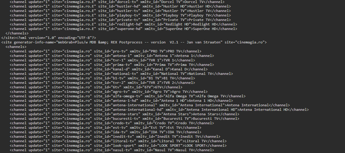

Hi all,
I am having some issues importing xml based epg guides (I hope I am saying that correctly) into TVHeadEnd. The built in tv_grab_huro works great, but I downloaded webgrab++ xml files and tv_grab_wb does not import them. I created the /config/data folder, and when I run tv_grab_wb from the console of the container I get what seems like correct results:
But when I run the internal grabber in TVheadend, it doesn't have any channels:
So, if am I doing something wrong? or does this mean that NONE of the links in the XML files are returning any content?
I am still not sure what I am supposed to do with the .ini files I downloaded from http://www.webgrabplus.com/epg-channels#stc_3D... All documentation I read from webgrab seems to want me to point webgrab to the xml files and that should be pulling in EPG content.
1 hour ago, huntastikus said:
Hi all,
Are you trying to import the config file of webgrab++ using the tv_grab_wg?
Webgrab++ is a standalone software you run to get the TV listing in an xml file that you import into tvheadend using the wg grabber.
.... so I have to run webgrab++ (such as the webgrab container from lsio) separately to generate another xml file that I import with the wg grabber?
Thank you, that was the perfect nudge in the right direction, got it working!

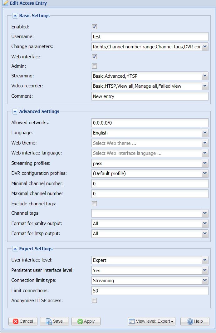

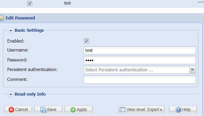

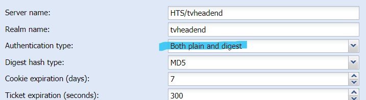

how to use TVH with user:password?
i grab channels with udpxy in my network and want to let watch them with auth.
I try http://login:pass@ip:port/playlist/channels
but VLC player still ask login password.
Other software without auth just say 401 and can't play.
Probably better to ask on the tvheadend forum.
