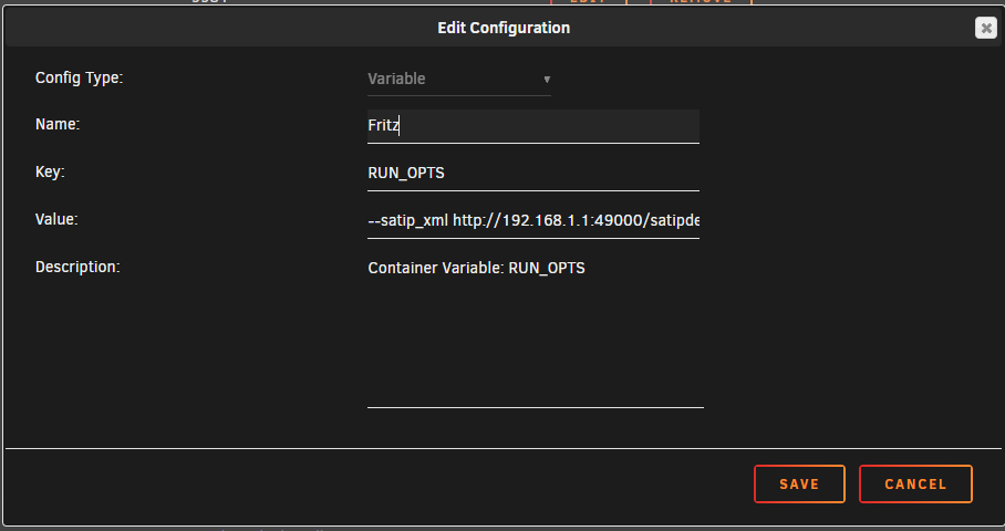

I didn't read well enough your earlier posts. It's not going in the extra parameters field, it's an env variable. Check the Readme on github in the first post for the info.
Did you try to push the discover satip servers in the satip server tab of tvheadend?
here is my variable
full line is
--satip_xml http://192.168.1.1:49000/satipdesc.xml
