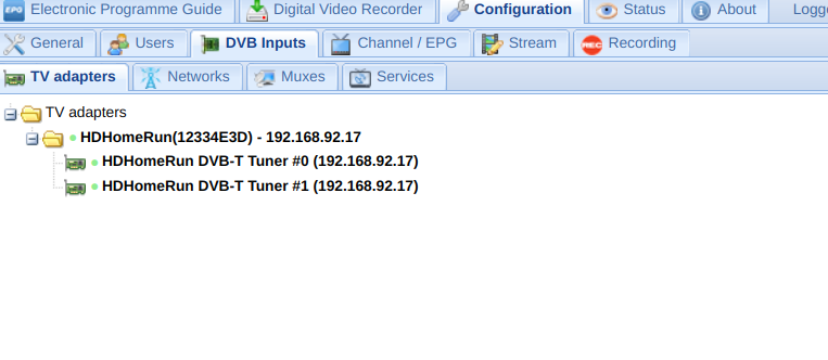

heres the screen from my tvh tuners, the fritz needed the xml variable ...

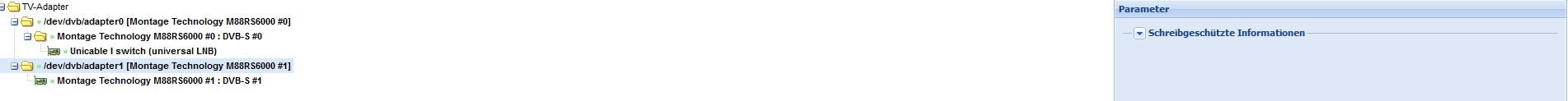

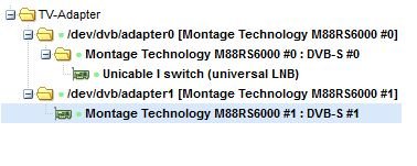

Hi i do have a problem with unraid DVB and TVHeadend.
Im not sure if its a problem of unraid DVB or TVH but part of DVB works so i decide to ask for help here first.
I use a SAT TV Card with 2 Tuners. I use a splitter to get my unicable signal in both tuners. Buf the 2nd doesnt work like it should. I TVH the 2nd Tuner also looks different and i guess thats why i cant get a signal. With the Adapter 0 everything works fine but it would be cool to see TV at 2 different Channels at the same time.
Hope you can help me with that. i attached a picture of my TVH.
thanks a lot!

Hi saarg,
i did every possible setting in TVH "dvb-inputs" but it seems to be two different "kind" of adapter and i dont get why.
i havent tried a different version of unraid dvb. without unraid-dvb it wasnt working at all. but i can remember that there was a time where both adapters was unicable (but the 2nd one wasnt working aswell)

You have to set it to unicable fof the text unicable to show. Hard to help when you don't post any screenshots of the settings.

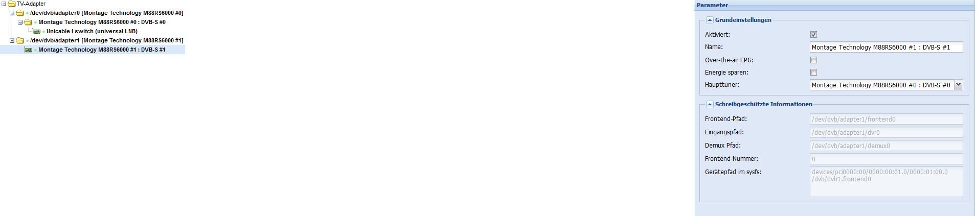

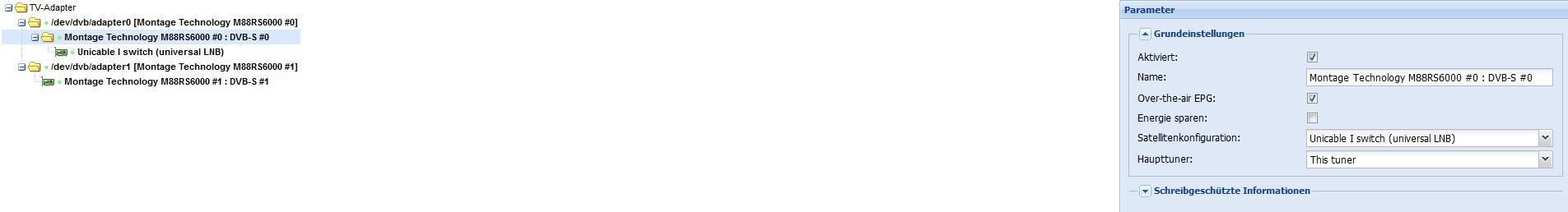

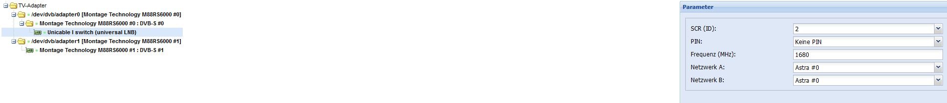

I attached a few screenshots with the config. the problem seems to be that i cant take any settings where i should be able to.
Would be great if you changed to English.
Have you tried disabling unicable on the first tuner?
erm yes sorry i forgot that switching language to english might be a good idea xD
the 2nd adapter didnt change in any way after i deactivate the unicable or set another method (which wont work then) 😞
Thank you very much for your will to help :)

//edit 2
found a similar problem in a german board.
solution is to delete the folder "input" now i have to setup everything again but at least the 2nd tuner is shown as it should
thanks for your time and suggestions!
