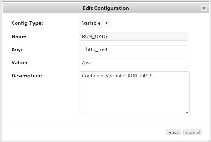

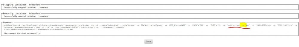

Hi guys,
I am having trouble setting up a NGINX reverse proxy for TVHeadEnd.
I followed some instructions back on P33.
It seems that when I create the variables with unraid, it is not producing the correct command line:
I have attached some images that highlight the issue.
I have read on this page that there needs to be an equals sign between the http_root and value for the root.
https://github.com/tvheadend/tvheadend/blob/master/docs/markdown/faqs.md#q-access-tvheadend-through-http-proxy
--name='tvheadend' --net='bridge' -e TZ="Australia/Sydney" -e HOST_OS="unRAID" -e 'PGID'='100' -e 'PUID'='99' -e '--http_root '='/pvr' -p '9981:9981/tcp'
Any ideas what I am doing wrong?

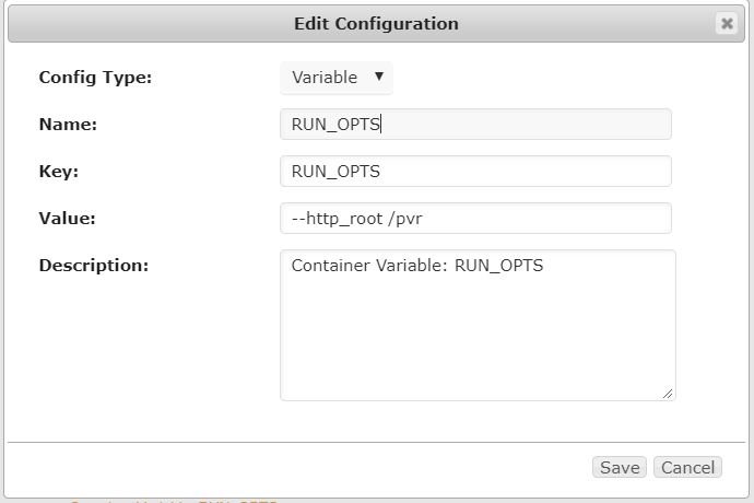

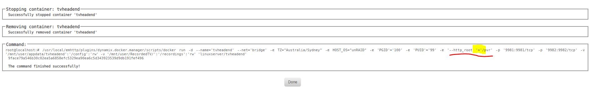

You set it up wrong. The name is, just a name. The key is RUN_OPTS and value is --http_root=/pvr
Thanks for the pointer.
To complete the story, this config is working November 2018 -  Unraid 6.5.3, TVHeadEnd 4.3-1517~g7fc6cba4d, NGINX
Config Type: Variable
Key: RUN_OPTS
Value: --http_root /pvr
**note that there is NO equals sign in the value
NGINX:
    location /pvr {
        proxy_pass http://192.168.0.88:9981;
        proxy_set_header Host $host;
        proxy_set_header X-Real-IP $remote_addr;
        proxy_set_header X-Forwarded-For $proxy_add_x_forwarded_for;
        proxy_set_header Upgrade $http_upgrade;
        proxy_set_header Connection "upgrade";
(Assuming that your unraid - tvheadend docker has the ip of 192.168.0.88)
