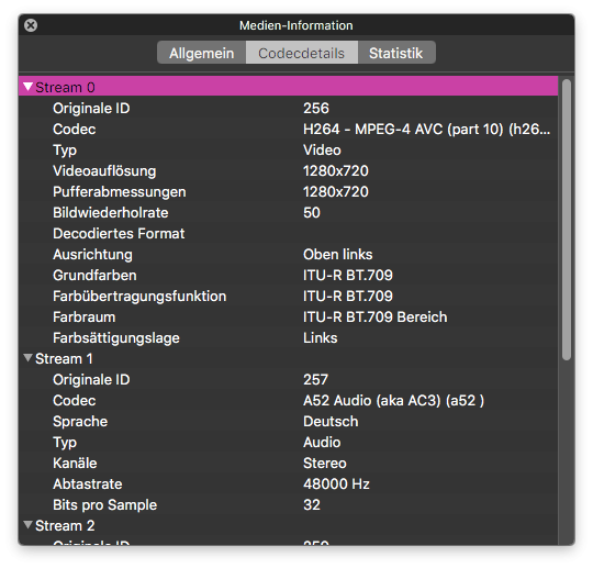

Anyone got this working with MagentaTV in Germany?
When I feed it the m3u for MagentaTV from this list it will find the muxes fine, but scanning FAILs and I cannot create services from the muxes.
The same m3u works just fine in VLC for example.
Most likely you are running the container in bridge network. If you use a multicast source, you need to use host networking.
Nope, didn't help. :(
Edit: attached screenshot of VLC's info dialogue about a sample stream.
Maybe it's a codec issue? The problem is going from mux to service. I don't even see a button to map the mux as service. (but maybe that's just the old, outdated UI in the video tutorial I tried to partially adapt)
Edited by Glassed Silver
Then I don't know. Probably best to ask on the tvheadend forum.
