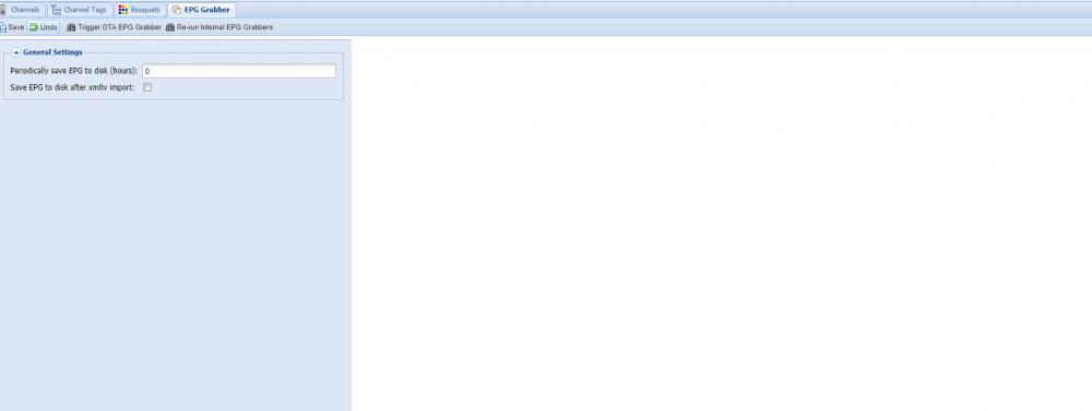

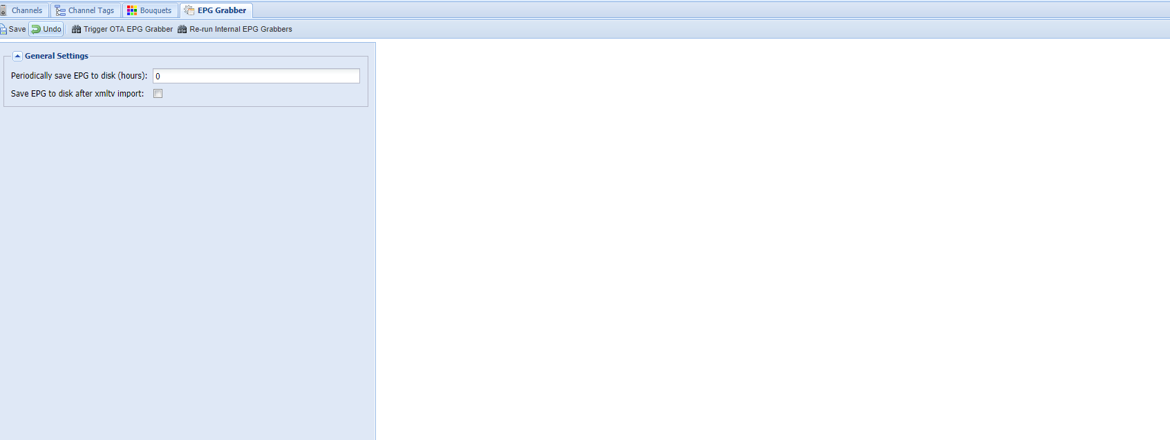

How is anyone else getting this to work? I'm lost....
root@Tower:/mnt/user/appdata/tvheadend# docker exec -it -u abc tvheadend /usr/bin/tv_grab_file --configure
/usr/bin/tv_grab_file: illegal option -- -
unknown option: -
unknown option: -
There is nothing to configure. It grabs the XML file in /config/data/
Yea, I had TVH on WSL but my Guide area is blank. Something not working....
Edited by Fith
Oh wait...I have no `config/data` ...Let me create that.....
Edited by Fith
Huh? Wsl? If you are not running unraid, this is not the correct place for support.
Containers running on windows isn't something we really support either. We only test on Linux.
So go to our forum or join our discord.
Read my previous post.
I'm on unRaid....I had it setup BEFORE in WSL....I'll try creating that directory...
root@Tower:/mnt/user/appdata/tvheadend# mkdir config
mkdir: cannot create directory ‘config’: File exists
Edited by Fith
I do have a directory called data
root@Tower:/mnt/user/appdata/tvheadend/data# ls -la
total 31044
drwxr-xr-x 1 nobody users       43 Jul  3 10:16 ./
drwxrwxrwx 1 nobody users     4096 Jul  3 11:57 ../
-rw-r--r-- 1 nobody users 31777651 Jul  3 10:16 guide.xml
-rwxr-xr-x 1 nobody users     1099 Jul  3 10:15 tv_grab_file*
total 31044
/config/data is inside the container. So the /config folder is the same as /many/user/appdata/tvheadend.
You have to add the guide.xml to that folder and then tvheadend adds the guide to it's internal EPG when the tv_grab_file grabber is set to run. You also have to enable it in tvheadend.
Did you copy the tv_grab_file in the data folder? That is not needed there.
Yea, That's one i have edited with a curl address for EPG that I use......One sec, I'll check the container
root@6cdb21ab5d3b:/config/data# ls -la
total 31044
drwxr-xr-x 1 abc abc       43 Jul  3 10:16 .
drwxrwxrwx 1 abc abc     4096 Jul  3 11:57 ..
-rw-r--r-- 1 abc abc 31777651 Jul  3 10:16 guide.xml
-rwxr-xr-x 1 abc abc     1099 Jul  3 10:15 tv_grab_file
yea, it's in there too...just not showing in TVH...I've restarted 30-40 times already :(
