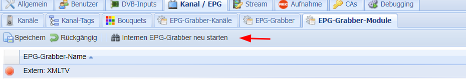

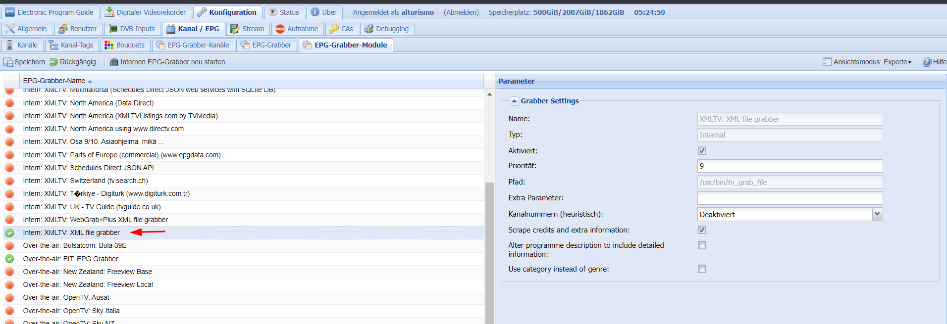

6. Go back to tvheadend go to the epg grabber modules, make sure you have enable the XMLTV: XML file grabber.
7. leave the extra parameters blank.
8. rerun the internal EPG grabbers
9. Then you should see at the bottom of TVheadend if you expand the log in the bottom right hand corner something like this:

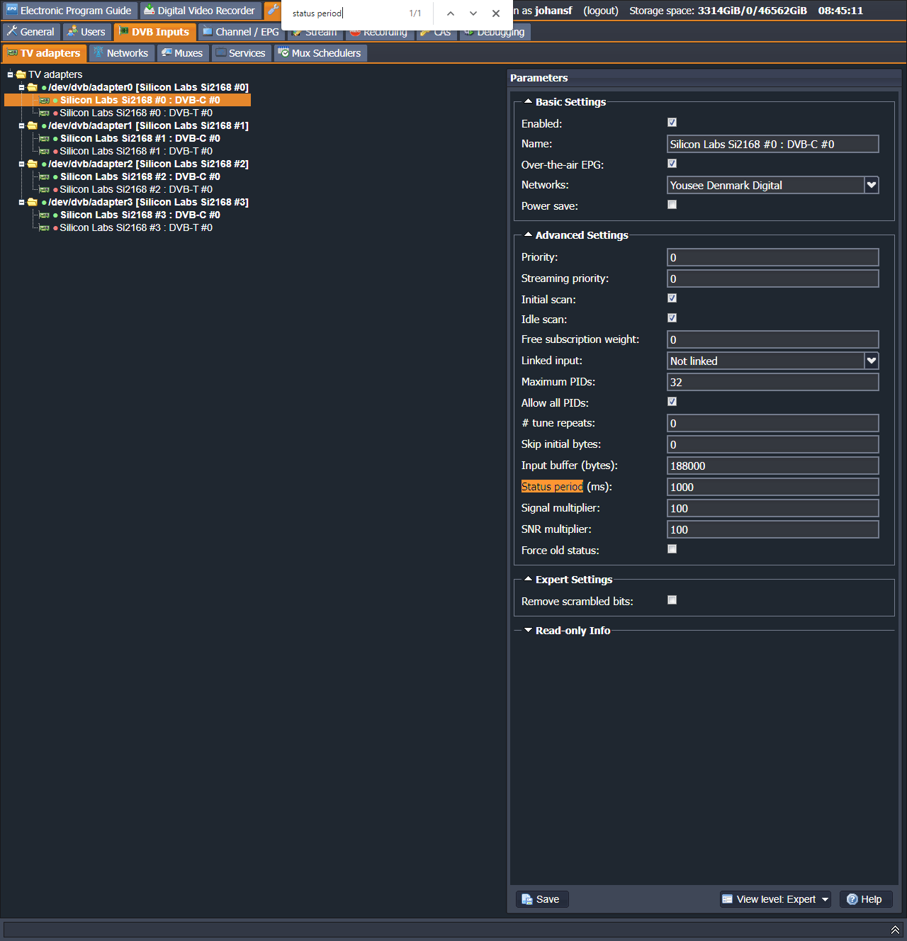

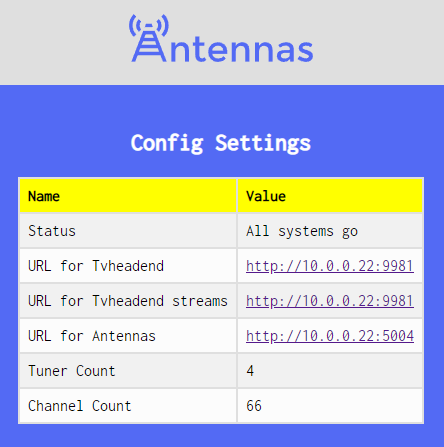

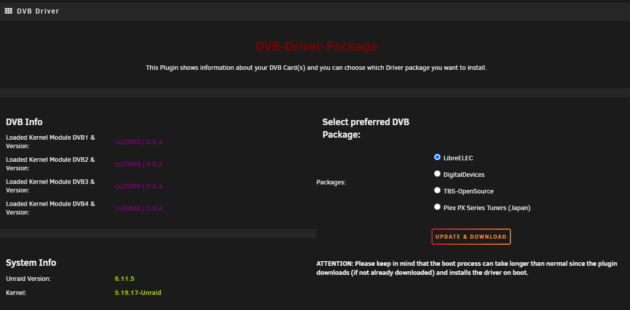

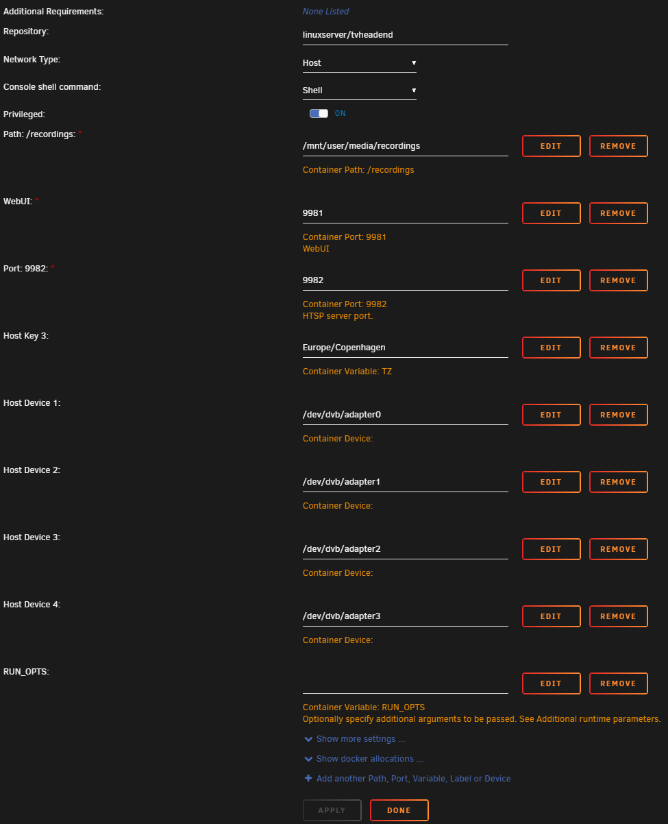

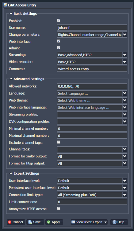

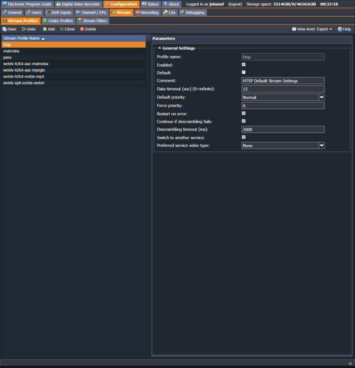

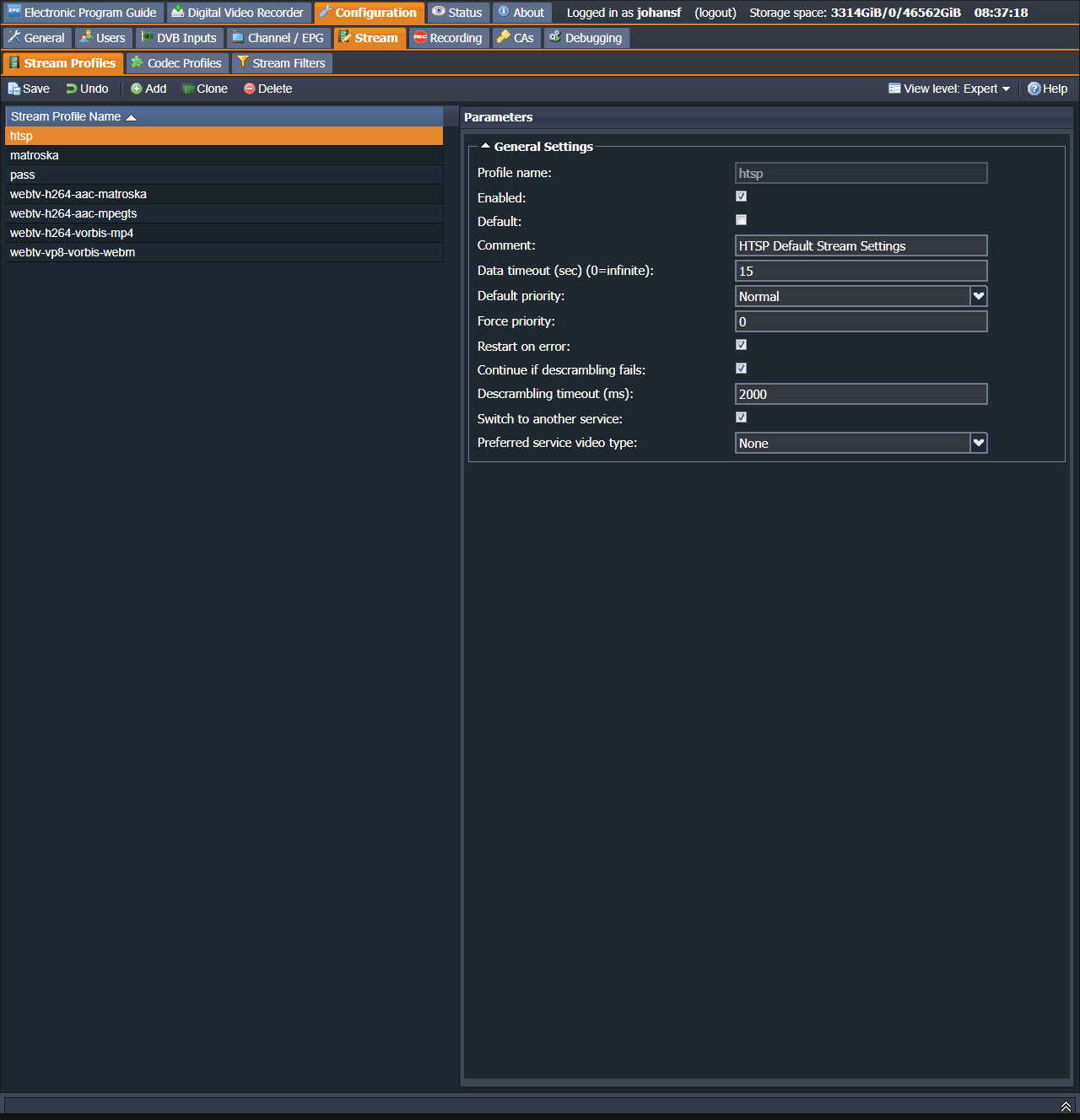

I constantly have to restart the tvheadend docker container when I want to watch TV.
When I simply try to tune a channel I usually get this:
tvheadend docker log when it doesn't work: https://pastebin.com/hU2e3rDc
After restarting the tvheadend docker container it works perfectly until a while has passed with no watching, and it will need a restart again.
tvheadend docker log while watching a stream: https://pastebin.com/B4GUSPyS
DVB Driver Plugin:
Container edit page:
My device is a Hauppauge WinTV-quadHD and I'm using antennas container to route tvheadend:
Please let me know if there is anymore information I can post to help solve this issue. It is a huge pain to deal with this on a daily basis.
Edited by JohanSF

I would be interested to see how these adapters are configured inside tvheadend.
Seems like a networking problem (DNS, DHCP) or something similar. Also how the users are configured too...
I use hdhomerun... and never have to reboot or reset. Very solid.

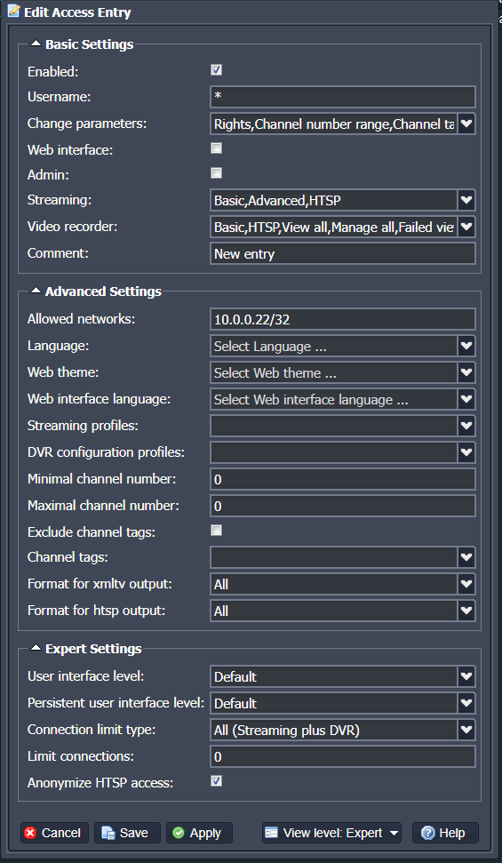

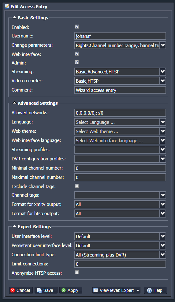

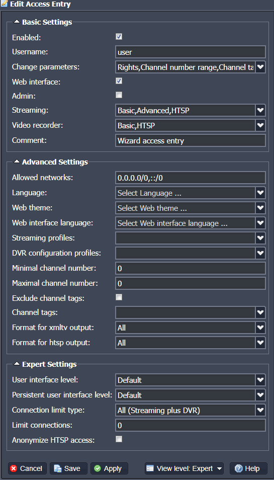

Here's the adapter configuration (status period marked cause I was googling and that might be of interest):
Stream profiles (don't know if the relevant one is selected here):
User settings:
image.thumb.png.82b43a5ee1e2c6e01d5ebf7ebdb6b2ab.pngimage.thumb.png.bf9e4ca5568578d6ab21fbde15355b9c.pngimage.thumb.png.4a185dbe594d2161e6f4f846fabdb5d8.png
sorry bud, but this looks ok to me... nothing comes to mind, though I continue to scratch my head on your behalf.
Frustrating I know...
