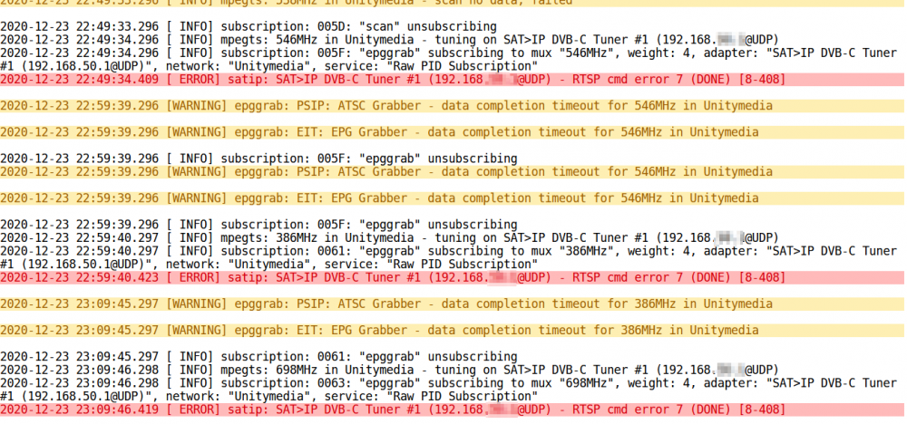

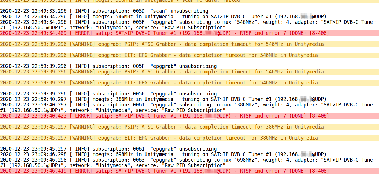

Hi everyone,
i have an issue with TVH and I hope someone can help me with that. I've installed it with the container variable RUN_OPTS
--satip_xml http://<myfritzboxip>:49000/satipdesc.xml
so that TVH can find my FritzBox Cable 6490.
I've added a new network 'Unitymedia' and selected the pre-defined muxes for Germany:de-Unitymedia.
In the tuner settings I linked the network, left the 'specinv' option on 'do not use' and set the 'tuner bind ip address' to my unraid-server-ip (I use the host network for this container). I just activated one tuner for testing if a connection can be established but always ran into the following error:
I don't know if it's important, my FritzBox Cable 6490 is the router of my DMZ. In this DMZ is a OpenWrt router which defines my private network where my server is acutally located. I just mention this as I don't think, this causes the issue*, but maybe it's relevant for further solution tracking.
*e.g. working fine in VLC with a FritzBox generated .m3u-playlist

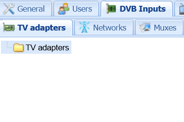

7 hours ago, alturismo said:
the tuners should come up automatically as long your tvheadend server is in host mode, may try that ahead.
I tried that way:
Deleted the container and it's config,
reinstalled as described in github-readme with host network and port options deleted (also in privileged mode and with PGID=0 and PUID=0 to exclude any permission error),
but no tuner shown up.
By adding an automatic IPTV network, with URL https://fritz.box/dvb/m3u/tvsd.m3u 97 muxes are found, but ends up with error:

EDIT: Just set up TVHeadend on a rasperry pi located in my DMZ and the tuners shown up automatically. So the error is somewhere in the network config or in the docker container config... will do further troubleshooting tomorrow.
Edited by Voss
great u found the bottleneck, now you just need to find a way through ;)
thanks :) If it's possible, I need some further help. I set up another raspberry pi TVH server in my private network and ran into the same issue as on my unraid TVH container. No tuners visible, so I suppose there is something with port forwarding and NAT. Sadly I'm not that familiar with NAT. Also trying to forward the ports 9981,9982,9983 and redirect port 554 to 9983 doesn't seem to be the solution - the only thing changed is my OpenWrt firewall looks like a swiss cheese now :D
I think this leads into something with NAT rules - do you have any suggestions how to solve this?
@Voss sorry, but this is here the wrong topic for sure and ... when u setup seperate networks, vlans, whatever ... its hard to help from outside and im not a fan todo such things at home as its (personally) just complicating things and there is no (personal) benefit.
simple port forwarding wont really help as its a broadcast from fritz u have to look for how to solve it, port 554 or 9983 are the satip server ports from tvheadend (as tvh can also serve satip, u see this when your network is fine and you run 2 tvh servers ... they will see each other as satip servers ...)..
@alturismo ok, thanks anyway for the support up to this point. I will try to build on your tips and work out a solution for me.

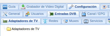

Hi. I am just arrived at unraid. I am trying to install tvheadend via docker. I have followed the thread and I see that I have to install it as host and put the variable --satip_xml http: // <mysatip>: 8080 /satipdesc.xml. I have looked for the satip_xml file to modify it but I cannot find it. Can someone tell me how to add the variable? Another question that arises is, how can I add a script to add the channel list and the EPG.
thanks.
sorry for my english I use a translator.
