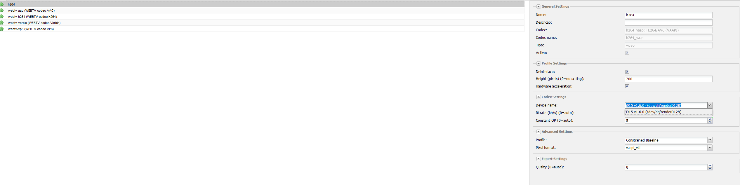

11 minutes ago, psycmos said:
I updated to Unraid 6.7 but i lost transcoding.
So i revered back to Unraid 6.6.6 and now are working good again.
So, somebody can give me the best place to report that issue?
Others user with PLEX are reporting the same issue in newer version of unraid 6.7 ( Transcoding with VAAPI not working).

I can confirm that's an Unraid issue because other topics that's are opened at this forum.
My setup is J4105M (Board with processor).
_______________________________________________________________________________
My Configs for transcoding at TVheadend:
syslinux.cfg:
label unRAID OS
menu default
kernel /bzimage
append pci=realloc=off initrd=/bzroot
At file Flash/Config/GO i used
#Setup drivers for hardware transcoding
modprobe i915
chown -R nobody:users /dev/dri
chmod -R 777 /dev/dri
#!/bin/bash
# Start the Management Utility
/usr/local/sbin/emhttp &
In DOCKER TVHEADEND use [ --device=/dev/dvb --device=/dev/dri:/dev/dri] under extra parameters
_______________________________________________________________________________________
I can see the device i915 v1.6.0 (/dev/dri/renderD128).
I think i will move this issue to General support because other users report this too in Unraid 6.7
About unraid logs,  how can i get it?
here its looking all good with hw transcoding, tested in tvh and plex, just as note.
unraid 671, i7 8700, intel gpu,
HTS Tvheadend 4.3-1795~g771dfd6be

Logs are in the diagnostics in tools. Just post the complete diagnostics.zip.
Also post the output of ls -al /dev/dri in both unraid and the container.
