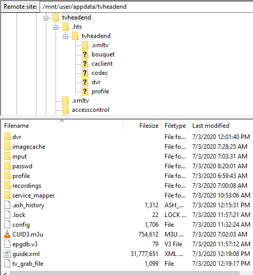

Yea, That's one i have edited with a curl address for EPG that I use......One sec, I'll check the container
root@6cdb21ab5d3b:/config/data# ls -la
total 31044
drwxr-xr-x 1 abc abc       43 Jul  3 10:16 .
drwxrwxrwx 1 abc abc     4096 Jul  3 11:57 ..
-rw-r--r-- 1 abc abc 31777651 Jul  3 10:16 guide.xml
-rwxr-xr-x 1 abc abc     1099 Jul  3 10:15 tv_grab_file

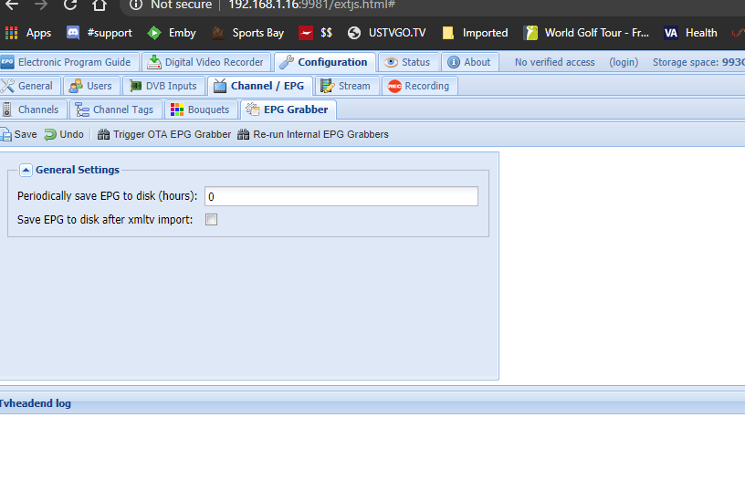

yea, it's in there too...just not showing in TVH...I've restarted 30-40 times already :(
What does the log say? You also have to connect the EPG data to the channels. It's not always done automatically if the name of the channel in tvheadend and the guide.xml is not the same.

Also the Guide is an exact match to the Network (m3u) I have loaded...It's just not showing up in TVH.

You need to read the documentation on how this works as you have not configured it correctly.
How do I know this? You don't have the EPG grabber modules tab. So read the documentation or find some guide on the internet for how to set up grabbing.
The XML file doesn't go in the /config folder. It goes in /config/data and you use the tv_grab_file grabber. But first read up on how to enable that module in tvheadend.

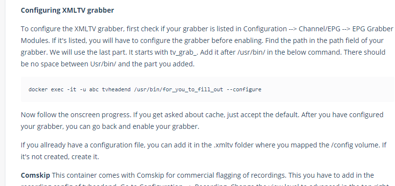

Gotta hint as to where those instructions are at?
This is all they have on the Docker Hub.......image.png.c075c6f99ad716857ee235c5afe7312f.png
Edited by Fith
I'm not talking about our documentation, butrhe tvheadend documentation, which is easily found using the help button in the tvheadend  webui or using Google.
The fix is really silly......in TVH go to
configuration, general, view mode
and turn on expert...then it shows up.....Sheesh...TVH, lol
Ticking the View Mode in the EPG Section does nothing...It's gotta be done from here.....image.png.08c4e701fac5a379f4e07cde844bde57.png
