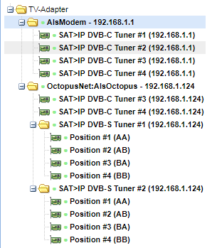

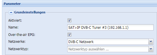

How many tuners are active in TVH ? DVB Inputs, Adapters ... all mapped to DVB-C ?
image.png.8e6469578631903860e55becaa95a8cc.pngimage.png.a8a0690450a13c46901a10685da78119.png
