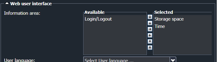

35 minutes ago, Marv said:
Switched from the Tvheadend plugin to this container and noticed that the currently logged in user, the logout button and the available space is not shown next to the ribbons in the webUI. Is this intended or a bug in the current container version?
This has nothing to do with the container. It's either browser specific or a change in TVheadend.
I think the plugin uses the stable 4.2 releases and if you just chose the latest tag when installing the container, you installed the 4.3 development branch.
Configuration->General->Base:
ahhh, thanks :)
