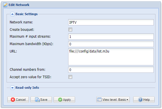

6 minutes ago, RedXon said:
How can I add a local m3u file to TVheadend? If I try every combination with file:// it doesn't work, if I try absolute path, if I try mapped path, no matter what I try, it doesn't work unfortunately.
You need three forward slashes. And you need to add the file where it's accessible to the container. In the tvheadend appdata folder would be a good place.
Create a new folder in appdata/tvheadend called data
drop the m3u in there
Add Automatic IPTV network
address is file:///config/data/filename.m3u
Thank you, I did exactly that
But unfortunately it does nothing, not when I hit Force Scan not on adding it, nothing. Anything else that could be wrong here? The file works in VLC and other apps. It also works if I enter the m3u url from where I got it, but it has over 10000 entries, so I edited it with only the ones I want. There should be about 200 in there...
For further clarification, I don't think there's a fault in the list, just in the way I put it in. I can for example load the list in Kodi with the Simple plugin included. It works fine but I unfortunately have no EPG there, that's what I try to do with Tvheadend. I hope that this can do that there.
Edited by RedXon
No need to scan or add muxes.
Make sure your view level is Expert and set Service ID to 1. Untick Scan After Creation and Idle Scan, tick Skip Startup Scan. That way it'll add all the muxes without scanning.
I actually found out what the problem was, by trying something completely different, thanks for all your help.
The file was encoded in UTF-8-BOM, which somehow was not compatible. I changed it to UTF-8 and tada, it works.

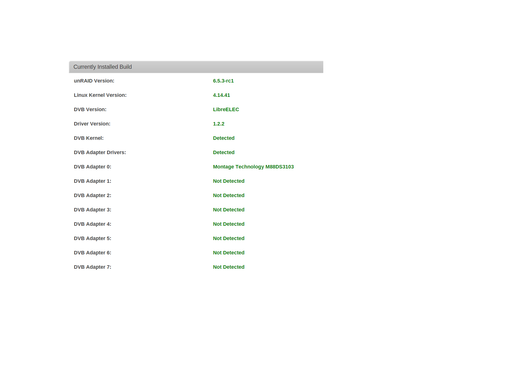

I dont get it. Since some days the adapter seems to be away (in tvheadend).
I use latest eleec unraid version. Didnt changed anything. If i ssh and look for /dev/dvb/ i can see adapter0... i added "device" pointing to /dev/dvb , like before, like i said, i didnt changed anything.
What else can i check?

yeah, ofc. I even upgraded it to the latest version to fix it.
Which unraid version are you on? Might be the permissions are wrong for the adapter.
permissons can be wrong for the adapter? XD like i said, the latest RC eleec

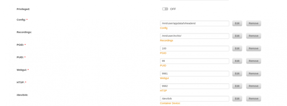

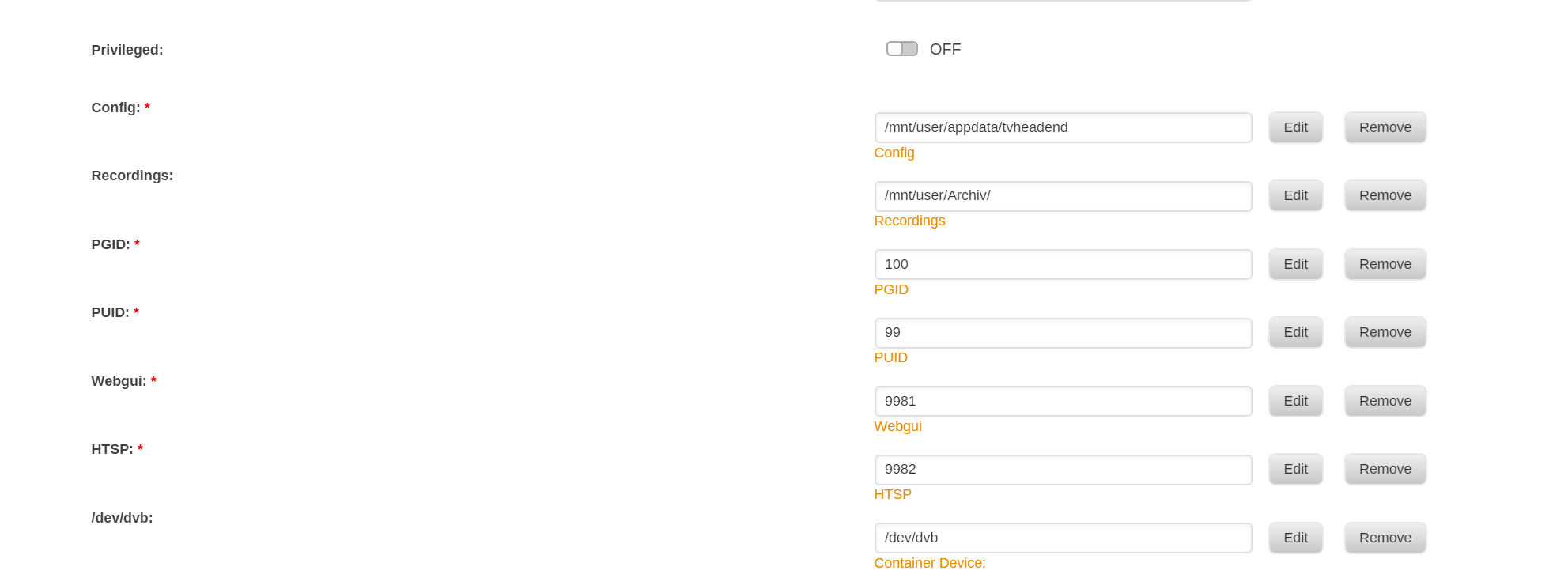

That's not how I have /dev/dvb. In Advanced View of the docker:
6 hours ago, nuhll said:
Tried, restartet tvheadend, nothing changed.
Can you post your docker run command?
Yea, but its right.
