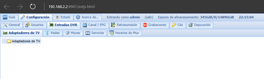

Not appear into tvheadend
root@localhost:# /usr/local/emhttp/plugins/dynamix.docker.manager/scripts/docker run -d --name="tvheadend" --net="bridge" -e TZ="Europe/Paris" -e HOST_OS="unRAID" -e "PGID"="100" -e "PUID"="99" -p 9981:9981/tcp -p 9982:9982/tcp -v "/mnt/disk6/Usuarios/Yo/tvheadend":"/config":rw -v "/mnt/user/Multimedia/Television/":"/recordings":rw --device="/dev/dvb" linuxserver/tvheadend
63a709e6dfc91a0ff2fb6e44b454873f78b448325088111beaccb3ff081bc45a
The command finished successfully!

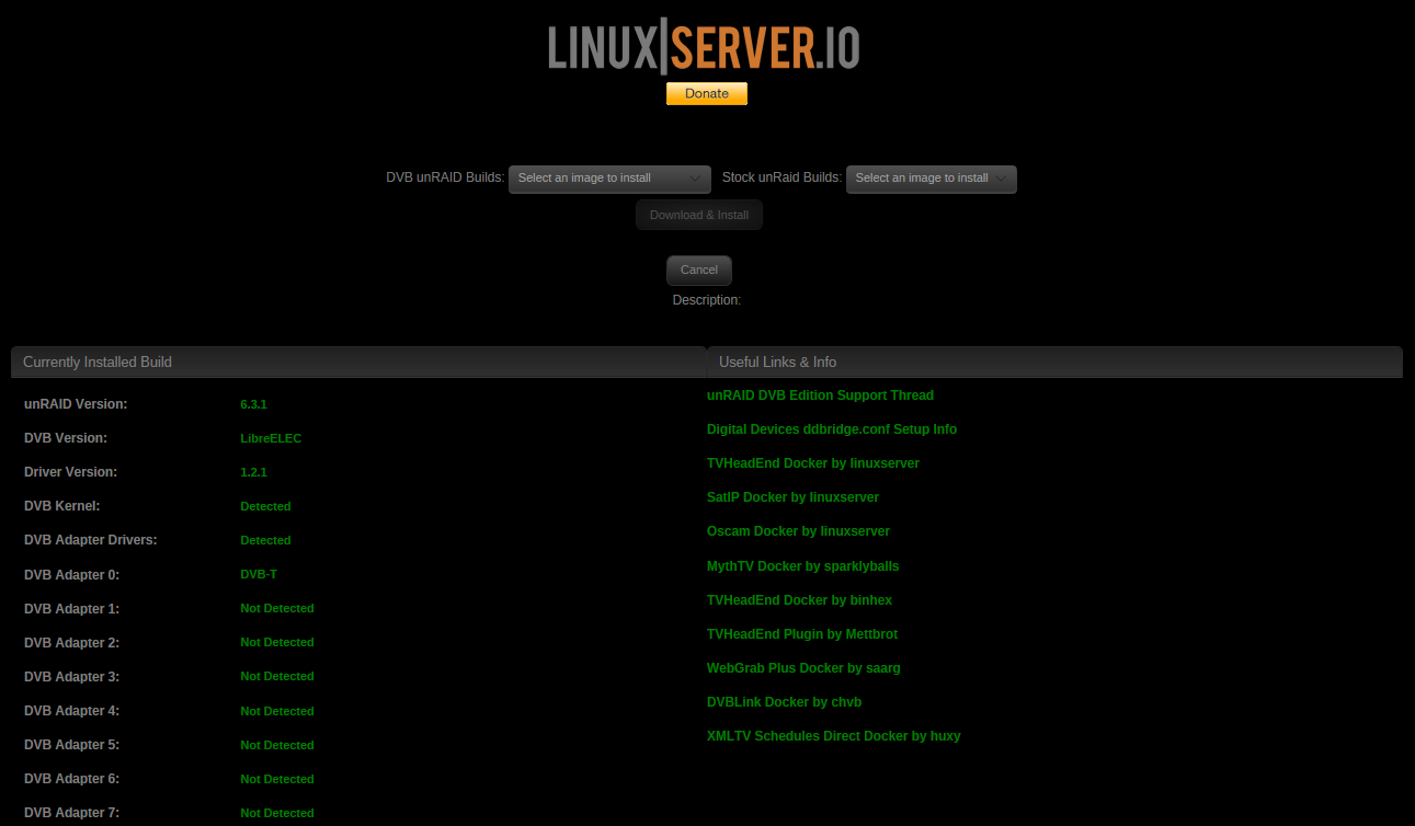

For some reason your adapter doesn't get the right permissions. Did you have the device connected when you booted unraid? If not, reboot while your device is connected.
The DVB plugin changes the owner of the device to nobody:users when it's installed.
Yes, I have the device connected when I booted unraid

System detect my usb
Bus 002 Device 002: ID 07ca:1835 AVerMedia Technologies, Inc.
It works perfectly on my laptop with Windows 10
It is hard to Google or search the forum I guess...
Click the dvb Plugin link in my signature and you will have your answer.

What is the name of your DVB device?

My adapter is: AverTv Volar HD Pro.
Add diagnostic

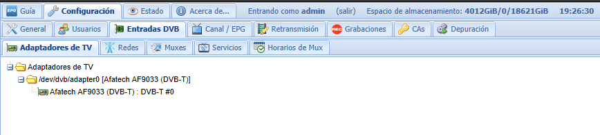

Then stop the tvheadend container and connect to your server through ssh/telnet and issue the command below.
chown -R nobody:users /dev/dvb
Then start the tvheadend container again to see if your tuner shows up.
Wow, its perfect!!!
One last question, do I have to do it every time I reboot?
Thank you very much for your help and sorry for my English

Did you remove the DVB Plugin? I can't find it being installed at boot in the syslog. If you removed the plugin, it's no wonder the permissions are wrong.
Yes, I delete the plugin and install the dock directly
