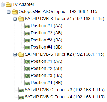

may s small question about the digital devices octopus drivers ... from meep.
i also switched to an DD Octopus Network Tuner and didnt install any dvb edition or any drivers, its now recognized as network tuner and all is working so far here.
Just wondering if it makes sense to use drivers in unraid for external tuners ? faster ? more possibilities ? couldnt imagine this makes sense at all ;)
ot did i missunderstand his topic ?
this is how my adapters are shown from DD Octopus ..
There is no reason for installing the dvb plugin since your tuner is a network based one.
The dvb plugin is only for tuners installed in the computer or USB based.
Meeps tuners is not sat>IP.
