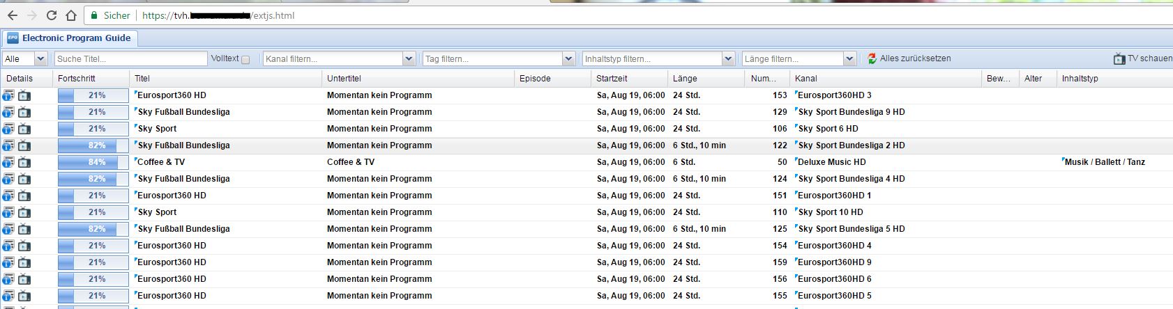

Hi, as im running TVH behind my apache reverse proxy and it seems to be broken since update from 04th or 5th august (only working EPG window) i would like
to ask if there is a way to rollback to a "older" build ?
i guess TVH changed something with their http header ...
it works when i use IP:9981 (internal and external), but not when i use my reverse proxy anymore ... then only EPG windows ...
thanks ahead fo an tip.
yep, noticed the change as well. since then, safari (on macOS) also only shows the epg-tab – nothing else (and btw. it even takes firefox a second or two before it displays the other tabs). before that change, both browsers did show all tab instantly.
true, the 1-2 sec. delay is also here when using IP directly ... reverse proxy as mentioned above ... chrome and IE.
what i also see is when keeping the epg window open it refreshes every few seconds and .. may that helps figure out ...
2017-08-19 11:10:40.046 [ ERROR] http: 192.168.1.2: HTTP/1.1 GET /comet/ws -- 415
2017-08-19 11:10:44.992 [ ERROR] http: 192.168.1.2: HTTP/1.1 GET /comet/ws -- 415
2017-08-19 11:10:51.233 [ ERROR] http: 192.168.1.2: HTTP/1.1 GET /comet/ws -- 415
ah, right – forgot that bug. safari shows this too – constantly reloading (and only showing the epg-tab); never completes and so can't use it. now i need to use a second browser (only for tvh). oh well...
I guess you guys use the latest branch? If you don't want any surprises I would go for the stable branch as there is a new development cycle now and it will take a while before a new stable is out.
thanks alot, changed to stable branch and all is good ;)
didnt noticed tags to choose ... my fault ;)
Edited by alturismo
