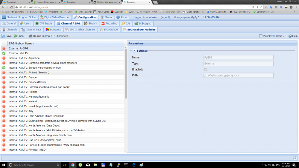

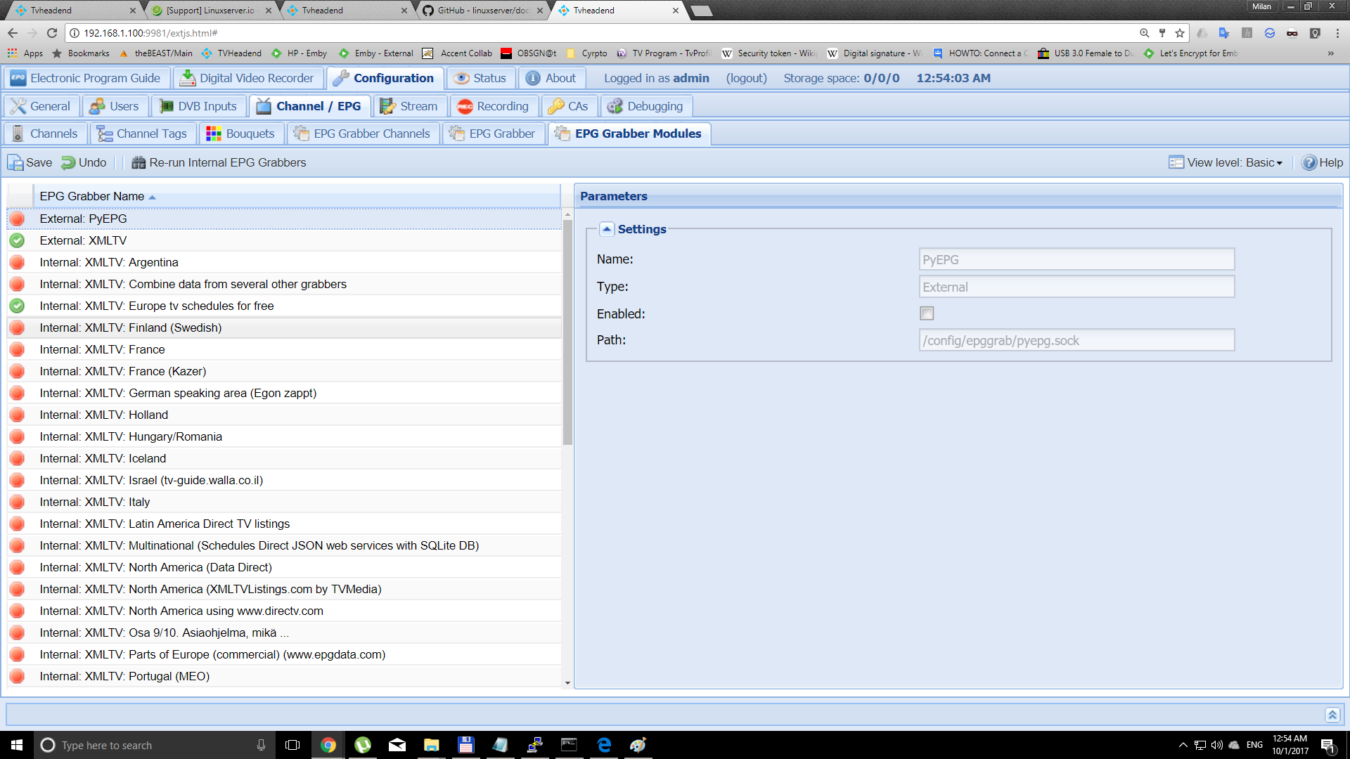

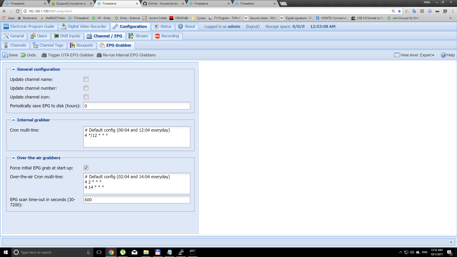

I am also confused. I run two tvheadend servers in parallel, one on libreelec, and one on Unraid.
After going to the web interface of the libreelec tvheadend server, strangely the tab with epg-grabber modules appeared.
Seems something was wrong with the browser. I could run the grabbers from
Anyways, I enabled the external xmltv grabbers from EPG Grabber tab->rerun  internal tv-grabbers.
On my libreelec tvheadend I run two grabbers:
- External XMLTV
- Internal: XMLTV (tv_grab_file).... This one is missing in the docker tvheadend configuration.
And I just wget my tvguide.xml half and hour before the schedule of tvheadends schedule and I have never had a problem.
I am completely new to dockers, and I am lost.
Below are screenshots of my previous strange situtaion, first one without the EPG Grabber tab, second one with it, same machine, same adress, same server.
no-tab.thumb.png.14b482298cc48be35ef1422982237219.pngtab.thumb.png.bad2adfcae93d150fe435f8726002034.png
The problem is most likely that you haven't changed the user interface level from basic. Then you will not see the epg grabber modules tab. The reason you saw it after going to the Libreelec on is probably browser cache.
