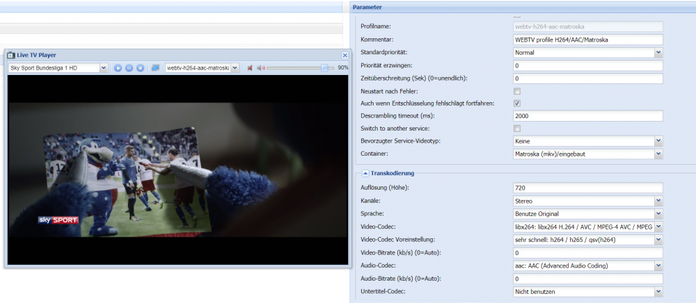

Hi all i am curious how much CPU is TVheadend docker using?
I have my first UNRAID BOX built with a CPU E3-1245 v5 @ 3.50GHz
I installed Emby docker last night but really disappointed with the high CPU usage when trans-coding +70% CPU with one stream.
I have 2 HD Home Runs and looking to use TVheadend as my PVR for them. My understanding is that it will still transcode from the HD Home Runs so i am curious how much CPU you use and also any specs of your CPU / Box if its working well :)
Thanks!
Thanks!
Tvheadend only transcode if you tell it to.
Thanks saarg,
Any experience with CPU usage within UNRAID?
I am trying to make the decision with I stick with the docker + TVheadend (and go through the learning curve)
Or stick with what I know and just set up a VM with Next PVR on my Esxi Server or UNRAID as a VM
5 hours ago, Frostyfruit said:
Thanks saarg,

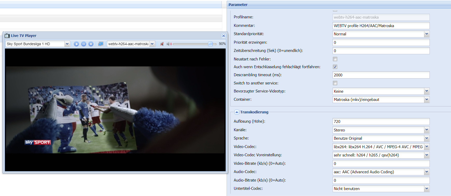

here a small example, 1080i source to 720p, matroska, it will depend from source to target ... 4 threads active for unraid, i 7-7700, base cpu is ~ 3 %.
Alturismo that’s pretty good! Are you doing any transcoding on emby or Plex or is that just tvhd?
alturismo,
i'm using TVH extensively for recording (as docker) and you barely can tell on cpu usage if it's recording or not. all functions except transcoding are extrem low on cpu usage.
transcoding uses lots of cpu in any solution (i tested emby, plex and a few other solutions). so you need to avoid it.
but: TVH offers quite a few possibilities; for example you can use VLC, or KODI (with TVH Plug-In) or the iOS app to watch live-TV and all without transcoding! it's also pretty cheap to grab a small android box with KODI/TVH plug-in and have a full blown TV appliance.
from an DVR solution point i wouldn't go back to any other solution (at least not on unRAID – and i wouldn't exchange unRAID for any other storage solution). you get quite a bunch of possibilities within one package and the community is great.
Edited by s.Oliver
@s.Oliver, me too ;) and yes, without transcoding theres almost no usage ...
and i also tested the transcoding featiures, just as note OT, if possible the intel quicksync with plex is working really nice here with hardware transcoding, just as note ...
my example was for @Frostyfruit cause he asked about it with transcoding ...
so, Plex hardware transcode or TVH software transcode is my personal favour if needed.
Plex software transcode was really bad here, TVH is quite good with transcoding and comskip on cpu usage (personally dont use it anymore since plex hardware transcode).
Edited by alturismo
