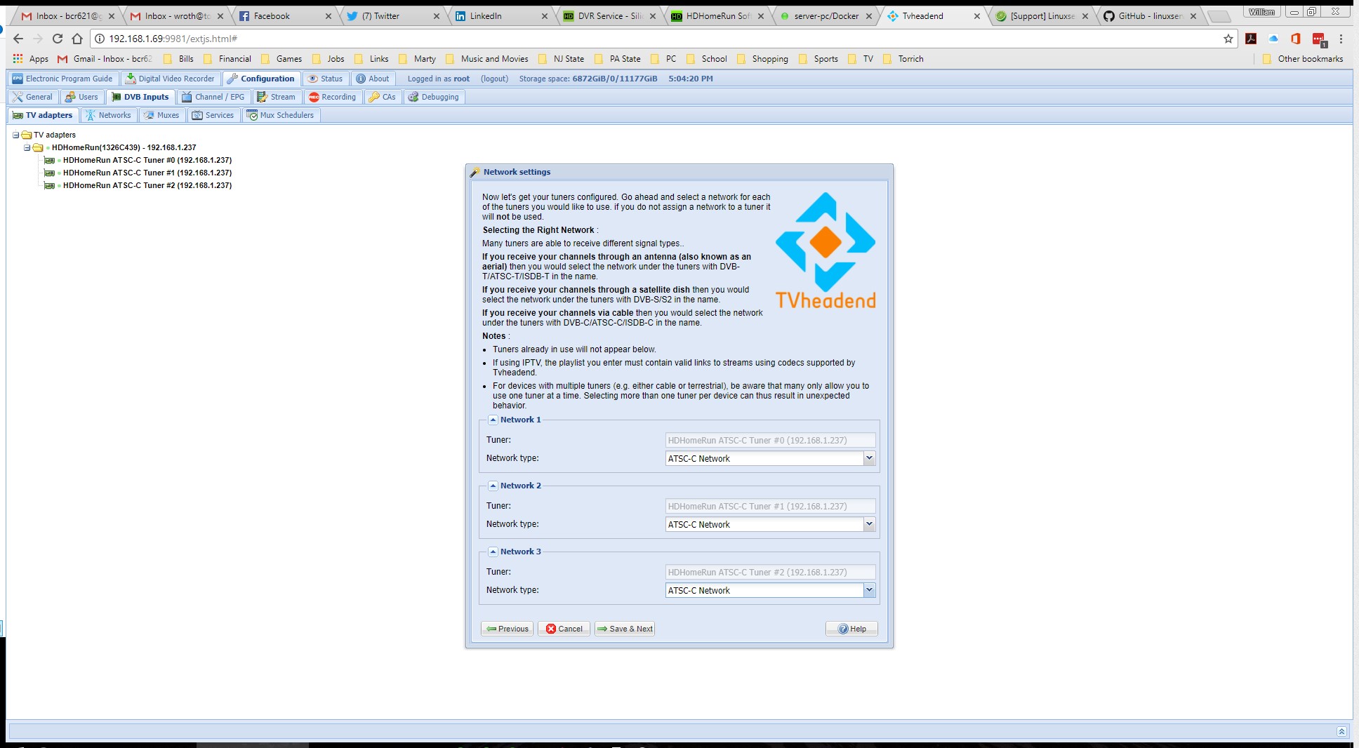

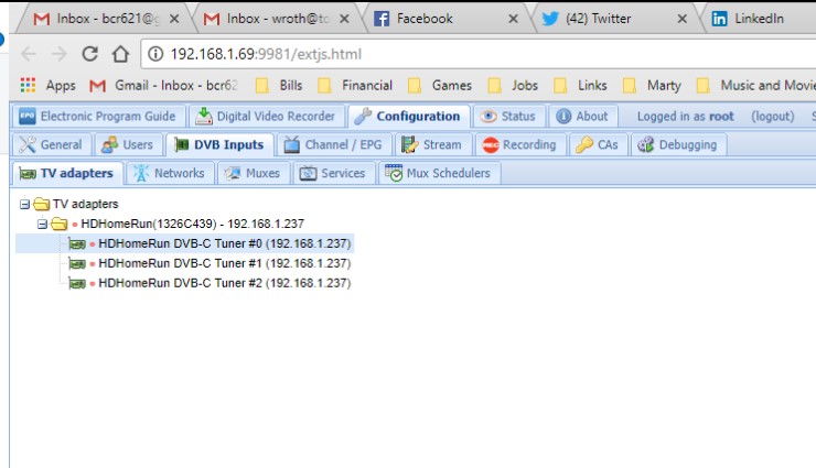

I have an HDHomerun Prime with a cable card from Verizon (I'm in the US). I've just installed the docker and run through the wizard. The Homerun tuners all come up as DVB-C instead of ATSC. What am I missing?
I don't know much about the hdhomerun, but don't you get a menu on the right side of the screen shot with some options?
Isn't there any option to choose ATSC in the wizard?
I found the option to change them to ATSC, it's in the HDHomerun folder, not the individual tuners.
However, there is no ability to choose in the wizard. I'm re-running the wizard now, the tuner section is grayed out. They show as ATSC now because I changed them manually. When I originally ran it, the tuners came up as DVB-C and there was no way to change it.

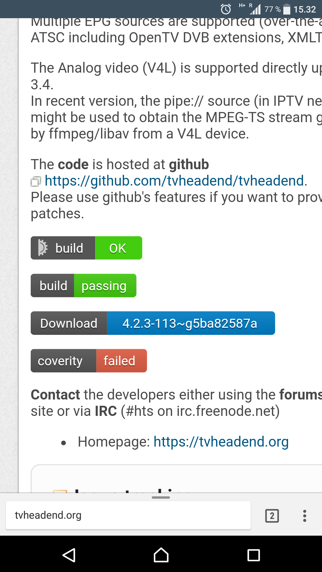

12 hours ago, s.Oliver said:
hey guys,
i reverted back to the "linuxserver/tvheadend:release-4.2" version and wanted to report/check for one failure/feature seen here with the update process of the docker.
my installation of TVH shows this version "HTS Tvheadend 4.2.3-39~ge195d1845" as installed (i guess it was that version from start on).
now, every time when dockers get checked for newer versions, i get notified that there is a newer one for TVH. letting it update doesn't resolve to any other/newer version – it stays the same.
while it's showing the updating dialog there doesn't get one new part downloaded (it takes just 2-3 secs); so actually it ends in a pure restart of the docker with the same version.
is it a known problem (bug) with version checking? has anybody the same?
thx. and have a good day.
That is an issue with unraid. Don't remember why it happens or the fix, but there should be some posts about it in the forum.

ya, saw it just a few secs ago also. and that's the stable release then, probably, right?
so mine is behind. will try to do a new install and see what happens then.
Deleting the image file when removing the container should download the latest available. But might not be the same version as on the tvheadend site.
Just downloaded the latest container and it's 4.2.3-95~g2bc61c904. Will be updated tonight though to the version on the tvheadend site.
Edited by saarg

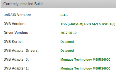

So I'm pretty new to unRAID, in fact I'm still in the testing period, but everything's working pretty well, except that tvheadend is causing me some headache.
I'm using a Digital Devices Cine S2 V6.5 and have installed the according drivers via the unRAID DVB Edition. Live TV is working until I start a recording. The recordings don't seem to finish and blocks the tuner (unfortunately only 1 tuner can be used), even though the recorded file are way too small (I think the longest recording was about 1 hour long). Following recordings are missed and Live TV doesn't work anymore. Even when I stop the recording in the WebUI Live TV doesn't work anymore. Restarting the docker doesn't help either, but a reboot solves the problem until the next recording starts.
I hope it's clear what I'm trying to say. unfortunately I'm also new to Docker, so my knowledge in that area is also limited. Maybe someone knows what the problem might be or point me in the right direction.

Which version of tvheadend are you running? If running release-4.2, then try the latest and vice versa. If that doesn't help, it might be an issue with the driver. If you dare, it might be worth trying the 6.4 RC of unraid.
I'm running the "latest" version. But I will try the 4.2-release, but shouldn't they be the same, as 4.2 is the latest stable version?
I'm not shy about trying a rc-Version, but is there already a DVB Edition available?
Latest is not the stable version, but latest from github master. Release-4.2  is the latest stable.
I don't really recommend to use the latest version as there might be lots of bugs until the have added all the new features and stabilized it.

OK, just tried various constellations. I actually had the 4.2 stable installed and tried to switch to latest. The problem still persists.
Next thing I tried was installing unraid 6.4 rc9. I haven't tried recording something yet, as I was watching soccer but after approximately 1 hour the stream stopped and I couldn't restart it.
It seems like it is some kind of driver issue. The card worked flawlessy until 2 weeks ago (with Win10 and dvbviewer). Any ideas or suggestions?

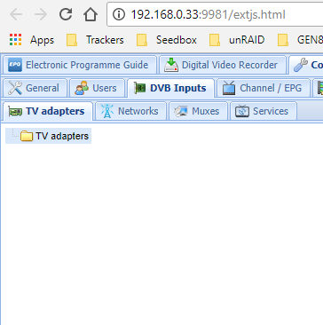

I have been experimenting with TVHeadend and this docker and had problems with it utilizing my DVBSky S952 card (only 1 tuner worked) it was recommended that I try the plugin instead but I also changed the unRAID DVB OS so not sure what fixed it but it worked! I would prefer to use the docker so I have uninstalled the plugin & rebooted several times but this docker no longer recognizes my DVBSky card? it is detected in unraid DVB OS so I presume the plugin is somehow hanging onto the card? can anyone throw some suggestions my way please?
Many Thanks
Many Thanks
Have you added --device=/dev/dvb in the extra parameters box in the Tvheadend template?
Perfect! Many Thanks! :-)
For those of you who are struggling with getting your HDHomeRun Prime working nicely with this docker (I was one), I found the two items below as a key to getting them to work:
1.  Make sure you set the view to Expert at the Application level...not just by setting it on the individual tab you are on.  This was preventing me from seeing the full EPG Grabber options.
2.  Once I had that done, this article was perfect.  If I had found this early on in my searches, I would have avoided a whole lot of head scratching and would have saved a lot of time.
