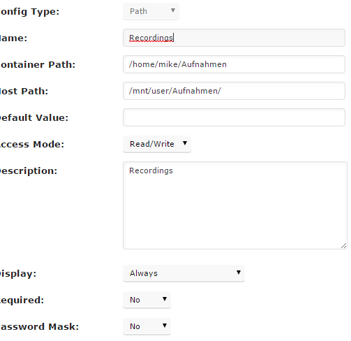

ok, i tried a little bit.
1. create the docker with recording mapping container path: /home/mike/Aufnahmen (like the path in ubuntu-tvheadend) and host path: /mnt/user/Aufnahmen/
2. copy all the files and folders from .hts in ubuntu to /mnt/cache/docker/tvheadend/ where my docker config is.
3. start docker and.....: no recordings, no configs. only 2 users are there, the stream profiles 2 times now and ok, the network and services are there.
Edited by himisk71

when i look in the recording config, there stand "/recordings/" as the recordingspath, in the old tvheadend "/home/mike/Aufnahmen"

Don't change the container side path for volume mountings in that way
You can change the ownership on the host side but the path /home/mike in the container will be owned by root and have no permissions passed to subdirectories

As @sparklyballs says, permissions will be wrong using /mnt/user/Aufnahmen as the container path. I just tested with tvheadend to see if it cared about the full path of the recording or just the current set recording path and it looks for the full path. So that means you will not really be able to import the old recordings to the container.
Is there a reason you want to have the recordings in tvheadend? I always move them into my TV Show share. Then I have much easier access in kodi to the show
