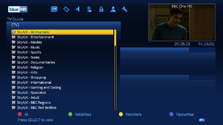

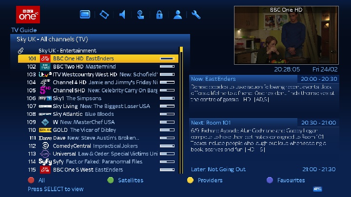

Basically yep;
channel numbers are automatically assigned to be the same as the provider and it updates itself when numbers get changed around.
everything is categorised and easy to find and it's all automated.
When I first started playing around with this stuff it took too much babysitting, when providers moved channels around things broke. This I just set and forget.
So it's a UK thing 9_9 as @j0nnymoe also love bouquets....
To be serious, I watch too few channels to use it. I mostly record stuff and the live TV I watch is mostly football.
I've never bothered with bouquets either. Maybe I should take a look.
bouquets is only really a DVB-S thing as on DVB-T(2) channels are restricted via frequency.
Yeah, I realised that, still got to setup the DVB-S card in my HTPC though, just need to find the time.
They're especially useful when having multiple satellite feeds, without them I'd have a list of 3500 random channels to scroll through!

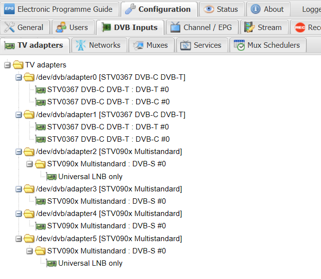

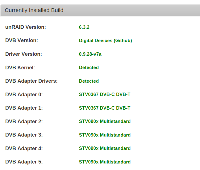

I have a TVHeadEnd hardware config question hopefully someone cn help me with....
Until recently, I was running TvHeadEnd in a plugin with my Digital Devices Octopus and DVB-T and DVB-S tuners all running on UnRaid DVB Edition. A recent power cut brought down my server and, on restart, I couldn't get my DVB-T tuners to work (they showed up OK but didn't receive a signal).
Having planned for some time to migrate to this Docker, I figured this was the opportunity to bite the bullet.
I updated unRAID DVB to 6.3.2 and installed the docker. DVB Edition reports all my tuners present but when I look at the TvAdapters tab  of TVHeadEnd, there's an oddity. (images attached)
Tuners 0 and 1 are DVB-T and they work OK.
Tuners 2 and 5 are on one Octopus daughtercard and they show up and tune channels.
However, tuners 3 and 4 show up strangely. On the working DVB-S, the tuner device is shown under 2 directory levels, whereas on the non-working DVB-S tuner, it shows under 1 and has a 'folder' name (if that makes sense). The upshot is that I cannot assign a network to these tuners so I'm down to 2x rather than 4x DVB-S tuners.
Any thoughts on this appreciated!
This is most likely something to do with the dvb drivers and not tvheadend I think.
You updated unraid and it have a new kernel. Did the driver version also change?

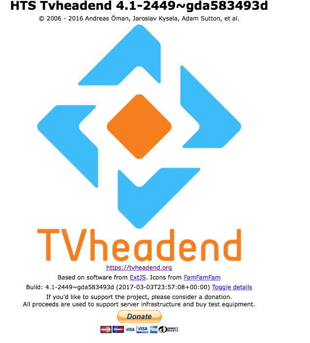

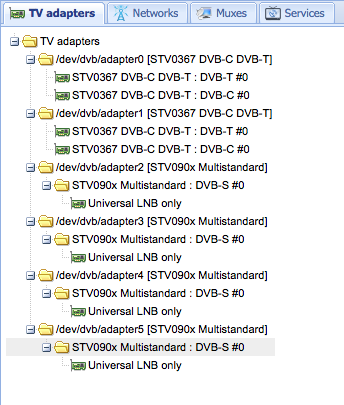

So it turns out it may be TVHeadEnd after all.
I reverted to the 4.09 Stable Docker (I had initially installed Default/Latest in which I had the described problem). Immediately, the tuners all showed up as I would expect:
58bf2f9519fa7_ScreenShot2017-03-07at22_01_03.png.12634b10a48d8ce9be2ae3a7b9ae7cae.png
I ran the Docker update and now I'm on tvheadend 4.1.x. Don't quite understand how that happened but the tuners are still correctly displayed. This is on the latest unRAID DVB 6.3.2 (stock DD drivers);
58bf2fb43273b_ScreenShot2017-03-07at22_04_36.png.aa61a5c98aad424de70b587b6701ea1e.png
So I guess the question is, why would the Default/Latest TVH Docker have the problem and the older version dos not?
