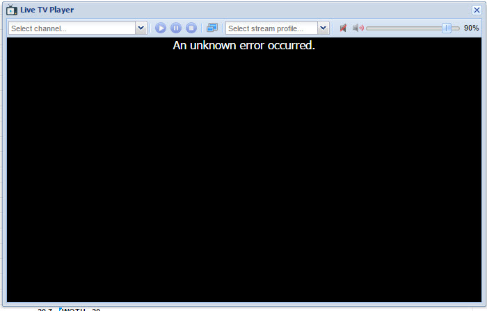

Sorry let me elaborate, If I try to access it via Port 9982 it says Site can't be reached.
I can login and authenticate via port 9981, then if I click Watch TV, it opens a new windows and it gives the screenshot attached.

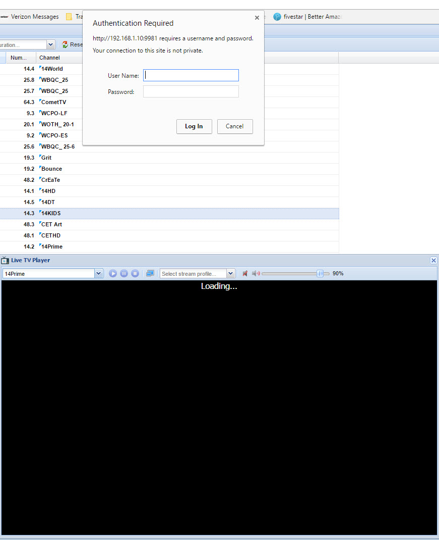

If I select a channel, I get the Authentication Required (screenshot attached) I try to login using admin credentials, and it just keeps asking to login. Not sure what you mean by play button, unless you're referring to recording. I haven't bothered to test that yet till I'm able to stream.
I've attached updated log file
Port 9982 is only for htsp clients, like kodi, to connect.
Which users have you created and what rights do they have?
Which user do you log in with when you try to watch a channel?

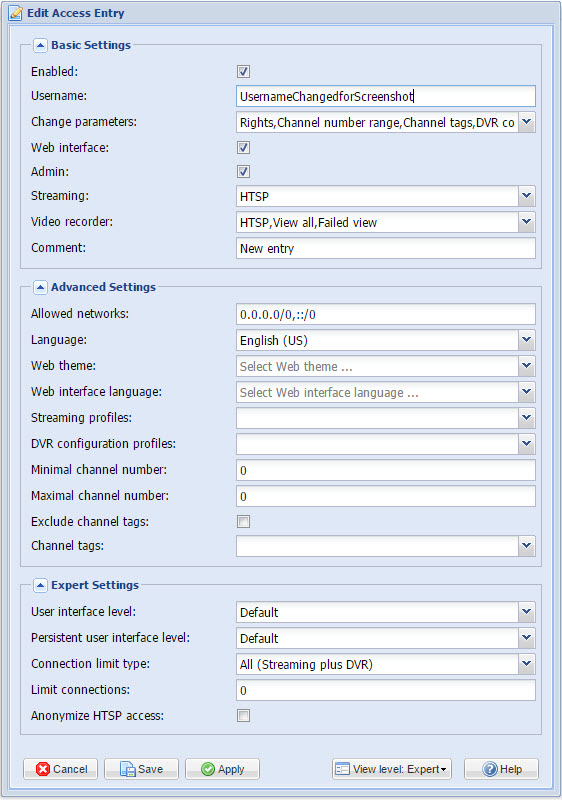

I created an Admin account, and I'm using that account to login
I wanted to add, I just added the Kodi Plugin, and used the admin credentials and it's streaming, so I did something right. But can't stream via the web.
Kodi plugin? I guess you mean the tvheadend client plugin in kodi.
Did you give the admin user the rights to stream in the webgui?
Yes, sorry for using the wrong working, the Tvheadend Client Plugin in Kodi works fine, watched TV last night without issue. Oddly though I can't watch on the Web Interface
You only configured the user to stream through HTSP,  so no wonder it doesn't work in the webgui. Select basic or advanced also and it should work.
Ahh, Duh, sorry! Thank you for the help! Works now obviously :)
