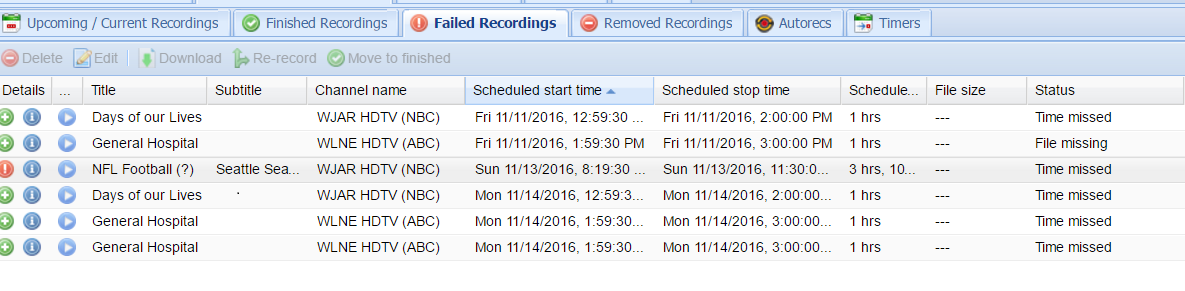

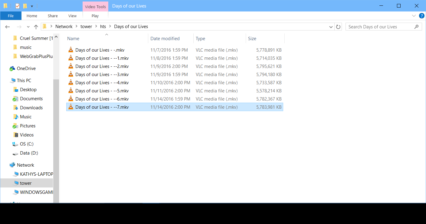

Hi guys, I'm having an issue with recordings and though I'd ask here if anyone knows what I'm doing wrong.
I have several auto-records scheduled but they always seem to end up as failed recordings with a status of 'time missed'.  The odd thing is that the .mkv files are saved to disk and play fine if I use VLC.  For some reason they are not showing as completed recordings in TVHeadend or any of it's clients (Kodi).  One other thing I noticed is that some times the error while trying to record is 'no input source available', but if I start a recording of the same show manually at the same time, the manual recording will complete as it should.
The tuner is a HDHomerun on the network.

Could you click the two arrows in the bottom right of the tvheadend webgui before the scheduled recording starts and paste the output here?
It might be that it takes too long to tune the channel and time missed comes, but it still manage to start the recording as tvheadend doesn't give up until the scheduled recordings end time.

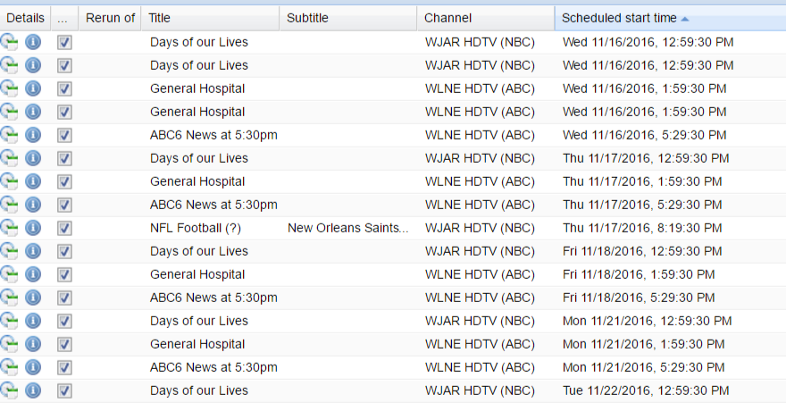

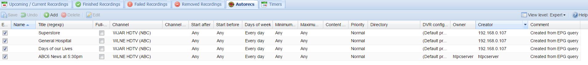

You have two scheduled recordings of the same show. Is there a reason why?
General hospital is not recorded as the days of our life is not finished and that means you have no free tuners.

As for the dual recordings, I have no clue why that happened.  They should all be created from the auto-record settings.  It only shows double recordings for some days and not others.  I'll try deleting all auto recordings and scheduled recordings and re-create them and see what happens going forward.
