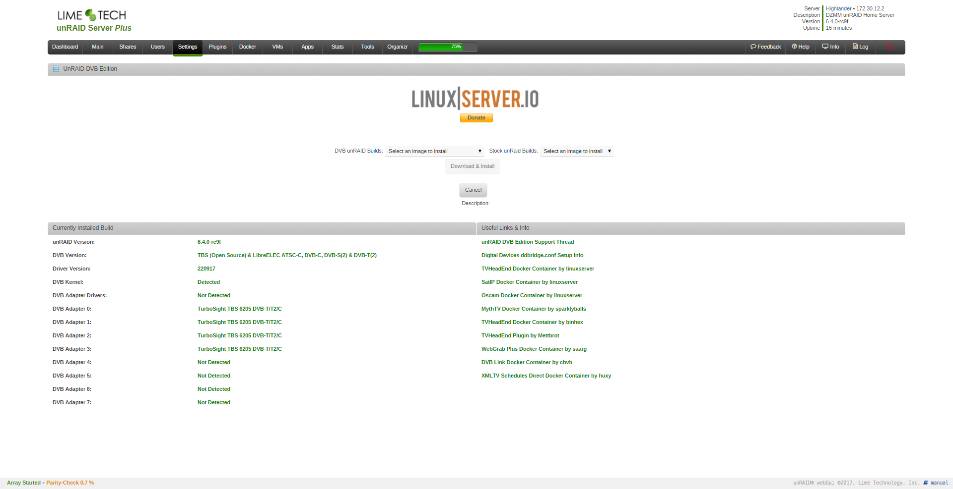

I had this docker working fine and then after moving my tv card to another slot the docker stopped working.  I've tried reinstalling, but I get this error:
Command:
root@localhost:# /usr/local/emhttp/plugins/dynamix.docker.manager/scripts/docker run -d --name="tvheadend" --net="br0" --ip="172.30.12.70" -e TZ="Europe/London" -e HOST_OS="unRAID" -e "PGID"="100" -e "PUID"="99" -e "TCP_PORT_9981"="9981" -e "TCP_PORT_9982"="9982" -e "TZ"="Europe/London" -v "/mnt/cache/appdata/tvheadend":"/config":rw -v "/mnt/user/tv_recordings/recordings/":"/recordings":rw -v "/mnt/user/tv_recordings/timeshift/":"/timeshift":rw --device=/dev/dvb/ linuxserver/tvheadend
65e25772644732cf830e16f1139416f68f07d59f10a773e6d63ea83f3b5676b9
/usr/bin/docker: Error response from daemon: linux runtime spec devices: error gathering device information while adding custom device "/dev/dvb": lstat /dev/dvb: no such file or directory.
The command failed.
The card is detected by unraid dvb edition:
59f24bf92ae7c_FireShotCapture50-Highlander_UnraidDVB-http___172_30_12.2_Settings_UnraidDVB.thumb.png.6e326c34d779ac95a6b6e28d674a7a1f.png
Confused - help please!
highlander-diagnostics-20171026-2155.zip

Just noticed, no DVB adapter drivers found!  Weird thing is, I'm using exactly the same card, it's the one card that actually does get tested before I push the DVB builds......
Confused as hell now.  Tried re-downloading the build?
Just thinking through things again, the only way I can explain this is the card is being snatched by a VM or dropping off or something.
The DVB adapter driver checks for the presence of the drivers each time the DVB web page is loaded.
The individual cards are detected at boot only and, if present, recorded and are static, so if the card drops off or is being used by a VM that change won't be reflected in the individual card statuses.
What's the output of
ls -la /dev/dvb/
Edited by CHBMB
That was it - with the card moving around, one of my VMs grabbed the TV card rather than a USB controller.  Sorted - thanks.

hmm not totally out of the woods yet.  My wife just tried to watch tv and it wasn't working and I actually opened the docker (thought launching was enough) and the adapters aren't showing in TVH.
I get from
ls -la /dev/dvb/
total 0
drwxr-xr-x  6 root root  120 Oct 26 22:57 ./
drwxr-xr-x 16 root root 4040 Oct 27 11:45 ../
drwxr-xr-x  2 root root  120 Oct 26 22:57 adapter0/
drwxr-xr-x  2 root root  120 Oct 26 22:57 adapter1/
drwxr-xr-x  2 root root  120 Oct 26 22:57 adapter2/
drwxr-xr-x  2 root root  120 Oct 26 22:57 adapter3/
I'm guessing the 0 is bad?  Do I need to reboot or is there another solution? I'm in the middle of a parity check so I can't do that for another 6 hours or so if that's the solution.
I get from
ls -la /dev/dvb/
total 0
mine looks mostly identical, but watch the permissions closely. i guess (and think to recall that) you need to modify those to match mine.
drwxr-xr-x  2 nobody users  120 Oct 24 15:04 adapter0/
drwxr-xr-x  2 nobody users  120 Oct 24 15:04 adapter1/
drwxr-xr-x  2 nobody users  120 Oct 24 15:04 adapter2/
drwxr-xr-x  2 nobody users  120 Oct 24 15:04 adapter3/
i think your docker can't access those, because of insufficient permissions.
Thanks - how do I change the permissions of adapters?  Never done that before
stop the docker first, then run this command as root (mostly your root anyway in unRAID console):
chown -R nobody:users /dev/dvb
afterwards restart the docker.
Edited by s.Oliver
thanks - that did the trick
