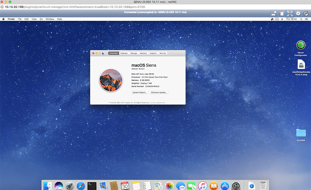

Hi @1812 not updated as yet. just downloading the combo update seems to be very slow coming down.
But this is what I am going to do.
1. remove nvidia webdrivers
2. update clover to latest
3. install combo update     https://support.apple.com/kb/DL1910?locale=en_US
4. install newest webdrivers https://images.nvidia.com/mac/pkg/367/WebDriver-367.15.10.45f01.pkg
5. keep fingers crossed

I'm not using web drivers so i did the following
update clover via clover configurator
rebooted to verify clover update---- no joy after boot menu
side question: is the "combo" different than updating via the app store? (it downloaded in about 2-3 minutes for me.)
Edited by 1812
