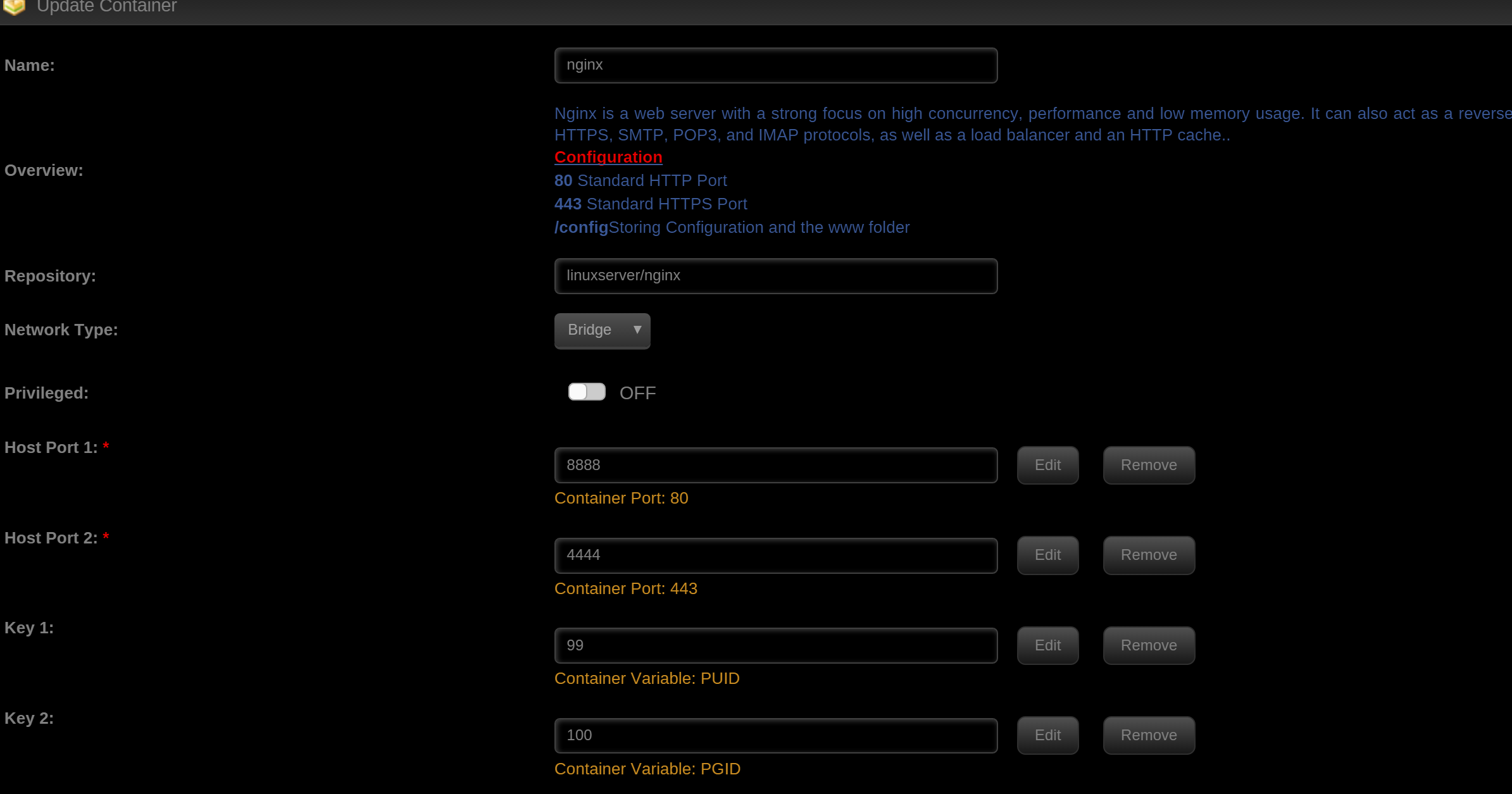

Good Evening all,
I'm pulling my hair out trying to get nginx work as a reverse proxy only, i have a wildcard cert ill use :) Ill say it now but thanks for anything you can suggest!
I have an old nginx server running on a vm that i'd love to move to a docker, moving yet another device over to all that is great (unraid) but its deceiving me as to how in the heck to make it work :)
error in nginx logs is
"nginx: [emerg] bind() to 192.168.1.82:8888 failed (99: Address not available)"
I have port 80 forwarded to 8888 (my unraid box)
my config file

If 192.168.1.82 is the IP of you're unRAID server, you are doing it wrong.
a docker container gets its own IP in a totally different subnet and its dynamic depending on what oder the container gets started up
You should make the nginx configuration be the default_server (ie any interface IP), that way it don't care about this detail.

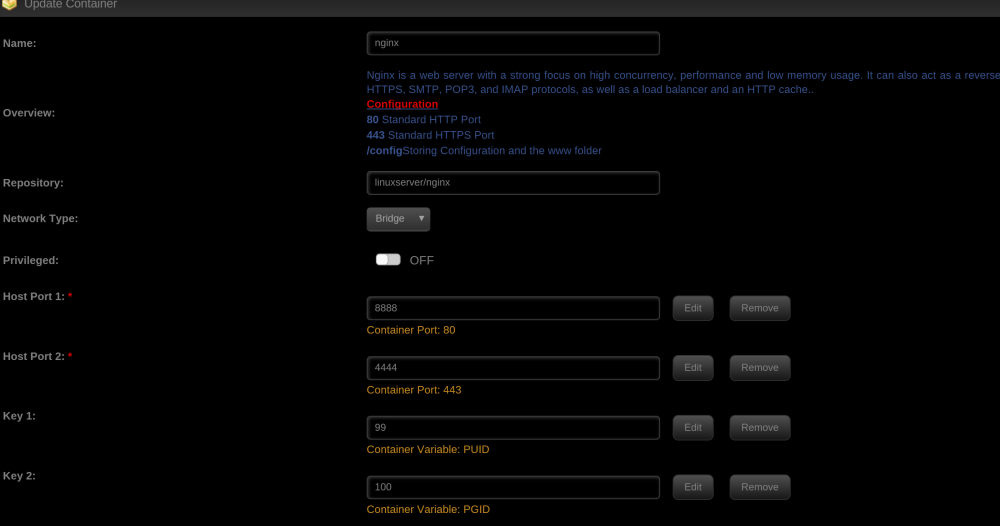

82 is my unraid box, all my other dockers ive just set a different port, perhaps im hosing up life there, ive got plex, ombi, nextcloud all running that way
I guess i should say the only things i want external facing are my nextcloud and my ombi
Edited by acbaldwi
Docker is forwarding port 8888 to 80. Nginx inside the container will see/listen on port 80. There won't be a connection coming from/to localhost
Drop the listen lines, and just use server_name ones
