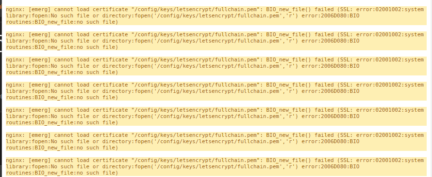

July 21, 20215 yr I recently swapped out my Cache drive and moved all Appdata files to the array, Dashboard said the disk was empty and i couldn't see any files after checking in MC. But now I keep getting these errors from Swag. I've reinstalled the docker container but it hasn't done anything.
July 21, 20215 yr 10 hours ago, xxbigfootxx said: I recently swapped out my Cache drive and moved all Appdata files to the array, Dashboard said the disk was empty and i couldn't see any files after checking in MC. But now I keep getting these errors from Swag. I've reinstalled the docker container but it hasn't done anything. Either the cert file doesn't exist or the permissions on it are incorrect.

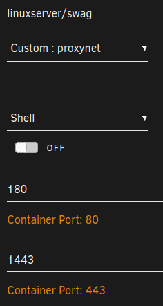

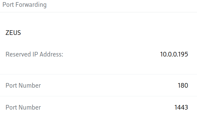

July 21, 20215 yr Attached images of what I have set up. Do I need to use cloudflare for dns auth? Is there a better solution maybe?

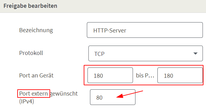

July 21, 20215 yr assuming your unraid server is running on ip 10.0.0.195 you need to forward external 80 to 180 and external 443 to 1443, this looks more like a simple 180 forward rule, so you could reach your swag only by http://whatever.mydomain.com:180 or http://whatever.mydomain.com:1443 which ir prolly not what you want ... and wont work as swag wants to generate cert(s) and needs http and https for usage like https://whatever.yourdomain.com like described ... in the readme and many times here in this thread, so check your router howto use it and forward
July 21, 20215 yr 14 minutes ago, moose1207 said: Attached images of what I have set up. Do I need to use cloudflare for dns auth? Is there a better solution maybe? When you try and go to subdomain.duckdns.com that is pointing to your router on port 80 or 443, so you need to forward 80 and 443 from your router to your docker host at port 180 and 1443. From a quick google it doesnt look like your comcast router supports port forwarding to different destination ports, so you need to put the container on a custom network which it looks like you already did but didn't assign an ip. Once you assign an ip to the container you just forward 80 and 443 on the router to that ip address.
July 21, 20215 yr 2 minutes ago, alturismo said: assuming your unraid server is running on ip 10.0.0.195 you need to forward external 80 to 180 and external 443 to 1443, this looks more like a simple 180 forward rule, so you could reach your swag only by http://whatever.mydomain.com:180 or http://whatever.mydomain.com:1443 which ir prolly not what you want ... and wont work as swag wants to generate cert(s) and needs http and https for usage like https://whatever.yourdomain.com like described ... in the readme and many times here in this thread, so check your router howto use it and forward Got it! So unfortunately with the freebie router that comcast provides they have removed access to manage it, and now you can only do a simple forward rule Port X to Port X, and NOT Port X to Port Y. I have forwarded 443 on my router and now it seems to be working right. I think I'll just buy a proper router I can manage, and ditch the comcast supplied one. Thanks!
July 21, 20215 yr 3 minutes ago, Lygris said: When you try and go to subdomain.duckdns.com that is pointing to your router on port 80 or 443, so you need to forward 80 and 443 from your router to your docker host at port 180 and 1443. From a quick google it doesnt look like your comcast router supports port forwarding to different destination ports, so you need to put the container on a custom network which it looks like you already did but didn't assign an ip. Once you assign an ip to the container you just forward 80 and 443 on the router to that ip address. I'm still learning and loving it lol. I didn't realize I can set up a unique IP address for the docker and use that for navigation/forwarding. I'll try that out. Thanks!
July 21, 20215 yr 5 minutes ago, moose1207 said: I'm still learning and loving it lol. I didn't realize I can set up a unique IP address for the docker and use that for navigation/forwarding. I'll try that out. Thanks! You will have to enable bridging on the network settings page for your interface and then set the "Ipv4 custom network on interface brX" in docker settings to your internal network space, then assign the ip to the container in your internal range. It will appear just like any other thing connected to your network at that point and you can use port 80 since it's on a different ip than unraid is using. another option would be to change the port unraid is using for the webgui to something else so the container can use 80, but the bridge network way is what i prefer Edited July 21, 20215 yr by Lygris
