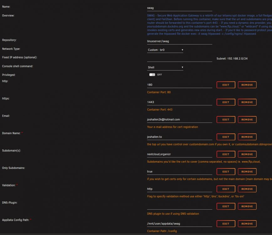

July 10, 20215 yr On 7/7/2021 at 10:10 PM, joshallen2k said: Hi all - I'm having difficulty troubleshooting what looks like a port forwarding issue. My SWAG reverse proxy was working fine until a week ago. I was getting BTRFS errors in my docker.img, so deleted it and created from new. After reloading my apps, I noticed my reverse proxy was not working anymore. In my SWAG logs, I saw this error: int: The Certificate Authority failed to download the challenge files from the temporary standalone webserver started by Certbot on port 80. Ensure that the listed domains point to this machine and that it can accept inbound connections from the internet. Some challenges have failed. Ask for help or search for solutions at https://community.letsencrypt.org. See the logfile /var/log/letsencrypt/letsencrypt.log or re-run Certbot with -v for more details. ERROR: Cert does not exist! Please see the validation error above. The issue may be due to incorrect dns or port forwarding settings. Please fix your settings and recreate the container My port forwarding seemed to be correct for port 80 (to 180) and port 443 (to 1443) as per my SWAG docker template. I went to a number of port testing sites, and they all showed blocked for 80 and 443. So at this point I contacted my ISP (Bell Canada) and they said they have not changed anything. Where should I go now to figure this out? Thanks all. Any ideas here anyone? Or have I messed up some way in how I posted

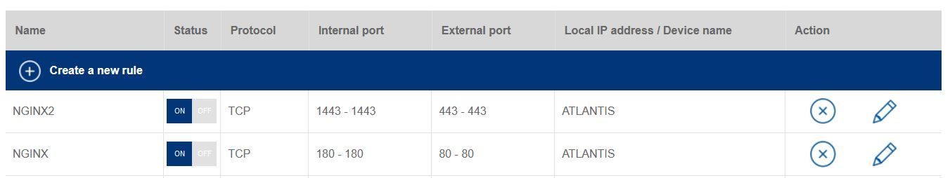

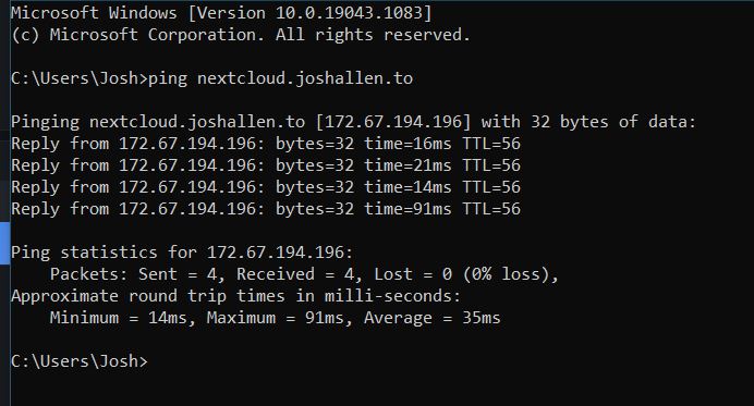

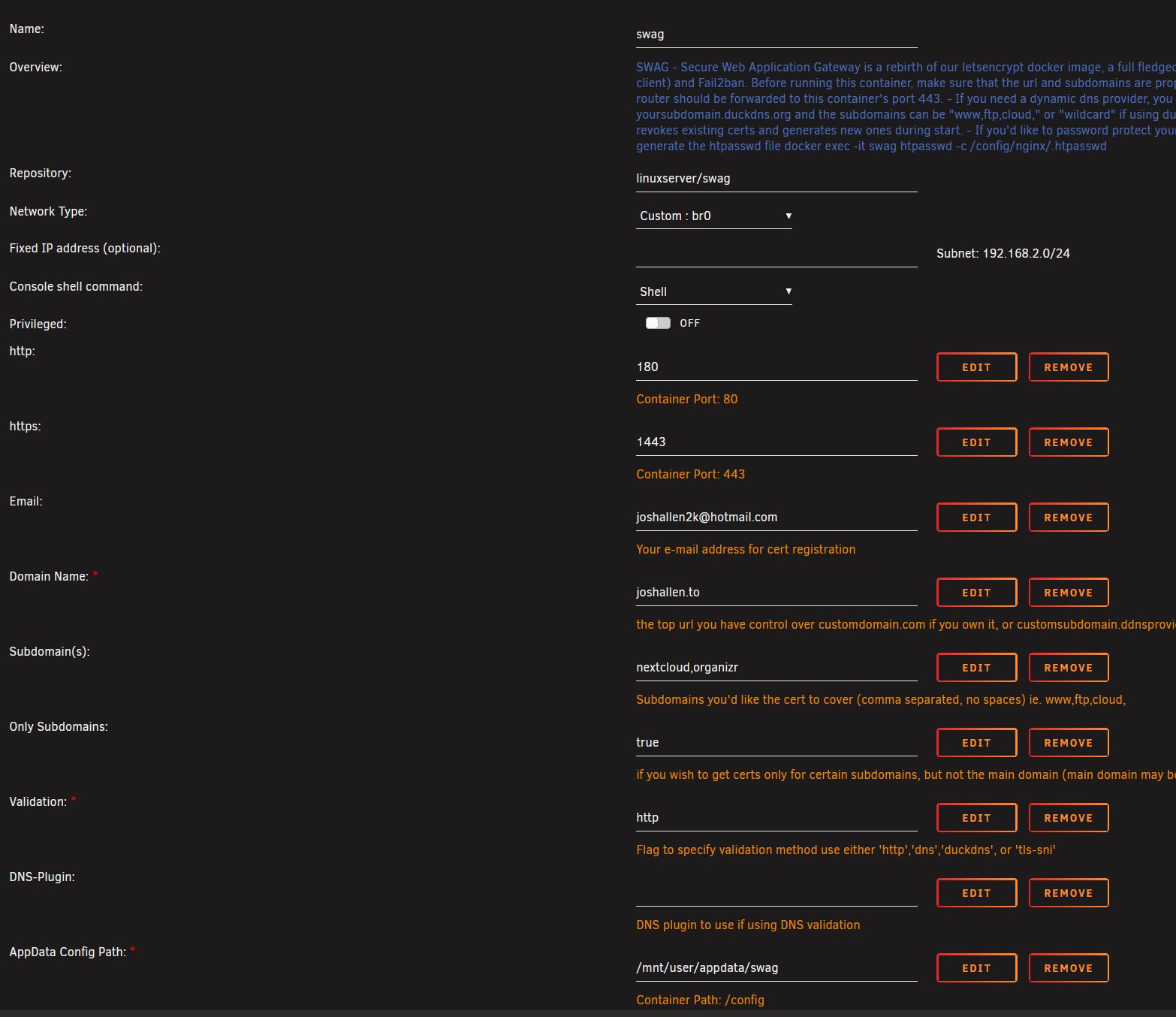

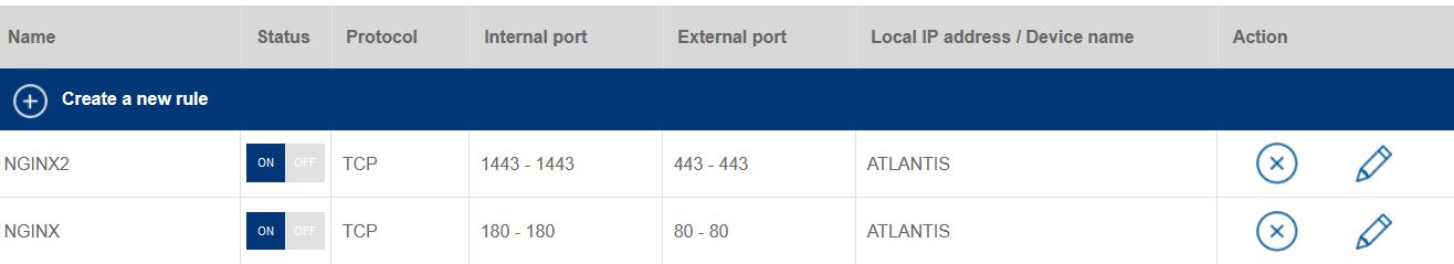

July 10, 20215 yr 2 hours ago, joshallen2k said: Any ideas here anyone? Or have I messed up some way in how I posted ping SUB.MYDOMAIN.COM and check if dns fits andpoint to your external ip post a screen from your docker rules post a screen from your routers forwarding rules for swag ...
July 10, 20215 yr 1 hour ago, alturismo said: ping SUB.MYDOMAIN.COM and check if dns fits andpoint to your external ip post a screen from your docker rules post a screen from your routers forwarding rules for swag ...

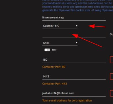

July 10, 20215 yr when i see your template, custom br:0 but no ip ... when your docker crashes it will also remove your custom ip setup ...
July 10, 20215 yr so, add your custom ip's again (dont forget the other reversed dockers ...) that should solve your issue and i meant "when your docker image crashes" ... custom bridge settings are gone and may your "old" forwarding to "ATLANTIS" doesnt fit anymore as the ip may changed may ping ATLANTIS and see if the internal ip still fits for your forwarding Edited July 10, 20215 yr by alturismo

July 10, 20215 yr 3 hours ago, joshallen2k said: Thanks for the reply. I double checked my WAN IP and its fine. For some reason my router when I specify an IP it resolves to the host name. WHat I'm unsure of is where you say to add my custom IP's again in the SWAG template. I don't think I specified anything there before. What should it be? when using custom br0 most likely to assign static ip's for the docker(s) in your home net like 192.168.1.0/24 in terms you stay on dhcp, your port forwarding goes to ATLANTIS, now, when u ping ATLANTIS locally, does it resolve to your swag ip ? your swag docker will have its own ip in the subnet like 192.168.2.25 as sample, so your port forwarding have to match it. as when your docker image crashes or you rebuild it, all network setups will also "reset", so may your swag docker will use a different local lan ip now, you can check in your docker tab on which ip swag is listening to ... and make sure your routers port forwarding for rules 80 and 443 are leading to 180 1443 to that local ip.

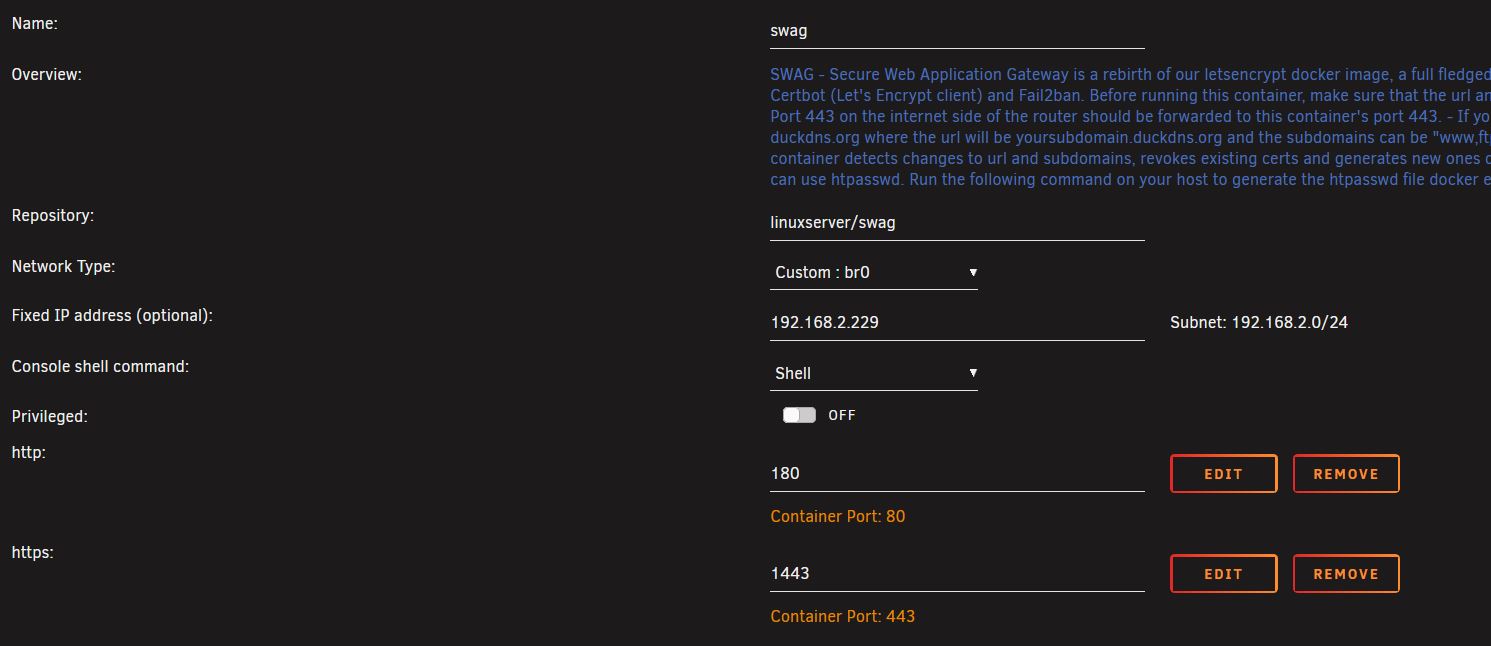

July 11, 20215 yr 3 hours ago, alturismo said: when using custom br0 most likely to assign static ip's for the docker(s) in your home net like 192.168.1.0/24 in terms you stay on dhcp, your port forwarding goes to ATLANTIS, now, when u ping ATLANTIS locally, does it resolve to your swag ip ? your swag docker will have its own ip in the subnet like 192.168.2.25 as sample, so your port forwarding have to match it. as when your docker image crashes or you rebuild it, all network setups will also "reset", so may your swag docker will use a different local lan ip now, you can check in your docker tab on which ip swag is listening to ... and make sure your routers port forwarding for rules 80 and 443 are leading to 180 1443 to that local ip. Thanks for the clarification, but I'm still having difficulty. With the setup in the screens below, the SWAG docker container fails to start with Execution Error 403. Note the fixed IP I specified in the template is the IP of my Unraid server (192.168.2.229). The IP of "ATLANTIS" is 192.168.2.229 Edited July 11, 20215 yr by joshallen2k added detail
July 11, 20215 yr 4 hours ago, joshallen2k said: Thanks for the clarification, but I'm still having difficulty. With the setup in the screens below, the SWAG docker container fails to start with Execution Error 403. Note the fixed IP I specified in the template is the IP of my Unraid server (192.168.2.229). The IP of "ATLANTIS" is 192.168.2.229 you cant assign it to the same ip as unraid has it already, change to bridge instead custom br0, then you dont have to worry about ip's and your docker port mappings are valid, also your other docker(s) then rather to bridge instead custom:br0, when i see what you try todo, i guess you didnt used custom:br0 before, you prolly either used bridge or may even did the proxynet bridge from the common tutorial video fro @SpaceInvaderOne which is also gone when your image broke and you have to start over ... you can pretty easy check how your configs look like, in bridge mode you cant use dockernames as targets ... Edited July 11, 20215 yr by alturismo

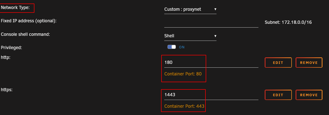

July 11, 20215 yr 11 hours ago, alturismo said: you cant assign it to the same ip as unraid has it already, change to bridge instead custom br0, then you dont have to worry about ip's and your docker port mappings are valid, also your other docker(s) then rather to bridge instead custom:br0, when i see what you try todo, i guess you didnt used custom:br0 before, you prolly either used bridge or may even did the proxynet bridge from the common tutorial video fro @SpaceInvaderOne which is also gone when your image broke and you have to start over ... you can pretty easy check how your configs look like, in bridge mode you cant use dockernames as targets ... Yes, it was the @SpaceInvaderOne tutorial that I originally used for the setup. I changed my network to bridge and had the same error. I just used the troubleshooting guide https://www.linuxserver.io/blog/2019-07-10-troubleshooting-letsencrypt-image-port-mapping-and-forwarding which suggests using the Nginx docker to test connectivity and forwarding. Using nginx seems to work - I can reach the standard web page, and when I use a port checker, port 80 and 443 are open/green. When I delete the nginx docker and launch swag (using the same port forward and network settings), then port 80/443 are showing up as closed.

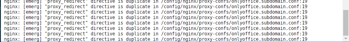

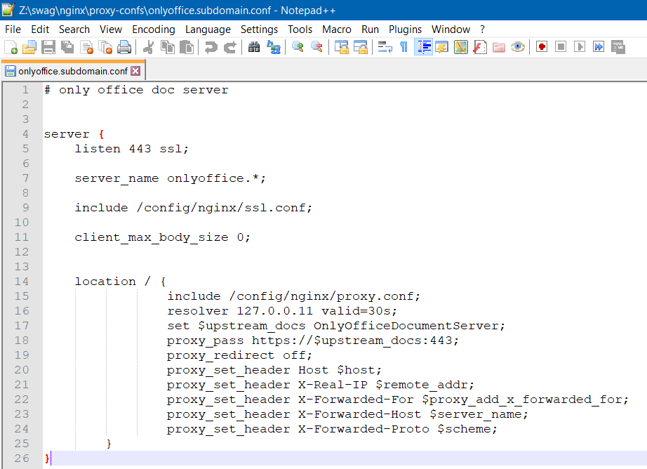

July 14, 20215 yr I found out today my swag broke. It was working properly in the past until today. Does anyone encounter the same issue? If so, do you guy know any fix? My swag broke with this log error. This is my CONF. file setup for only office subdomain
July 14, 20215 yr I found out today my swag broke. It was working properly in the past until today. Does anyone encounter the same issue? If so, do you guy know any fix? My swag broke with this log error. This is my CONF. file setup for only office subdomain Comment out the “proxy_redirect” line in the OnlyOffice CONF. Restart Swag. Profit.
