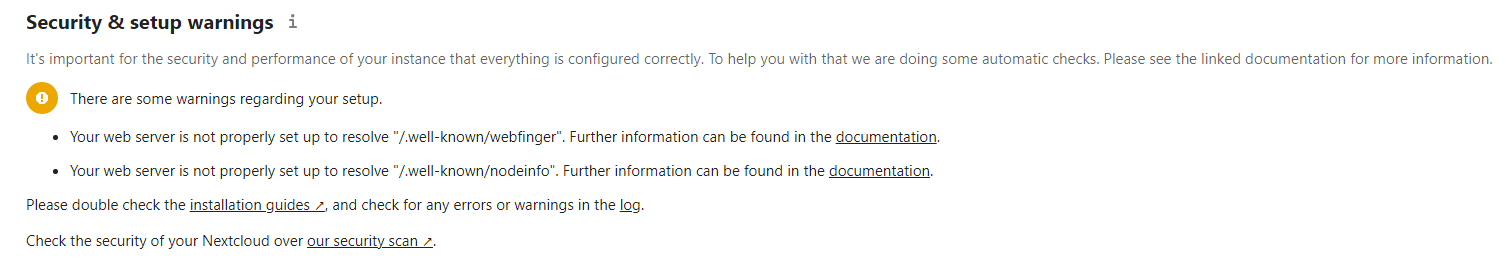

Configuration change needed after latest Nextcloud update to Nextcloud 21.0.1
Error message:
My existing configuration in Swag:

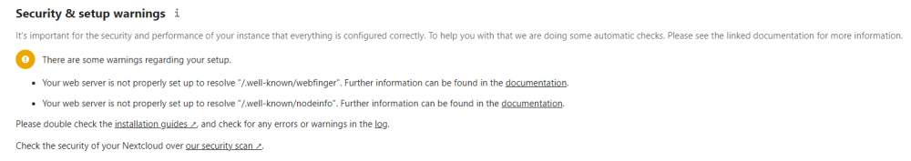

I have found different solution on the net that I cant "translate" into my SWAG configuration file
To be more precise, I have added the following lines to my nginx config file:
    location = /.well-known/webfinger {
            rewrite ^/.well-known/webfinger /public.php?service=webfinger last;
    location = /.well-known/nodeinfo {
            rewrite ^/.well-known/nodeinfo /public.php?service=nodeinfo last;
Or this one:
location ^~ /.well-known {
        location = /.well-known/carddav     { return 301 /remote.php/dav/; }
        location = /.well-known/caldav      { return 301 /remote.php/dav/; }
        # Anything else is dynamically handled by Nextcloud
        location ^~ /.well-known            { return 301 /index.php$uri; }
        try_files $uri $uri/ =404;
If anyone have this working then it would be great if you could share your configuration file ;-)

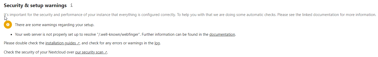

Update I tried this:
server {
    listen 443 ssl;
    listen [::]:443 ssl;
    server_name maindomain.dk;
    include /config/nginx/ssl.conf;
#   add_header X-Frame-Options "SAMEORIGIN" always;
    add_header Strict-Transport-Security "max-age=15768000; includeSubDomians; preload;";
    client_max_body_size 0;
    location / {
        include /config/nginx/proxy.conf;
        resolver 127.0.0.11 valid=30s;
        set $upstream_app nextcloud;
        set $upstream_port 443;
        set $upstream_proto https;
        proxy_pass $upstream_proto://$upstream_app:$upstream_port;
        proxy_max_temp_file_size 2048m;
    # Make a regex exception for `/.well-known` so that clients can still
    # access it despite the existence of the regex rule

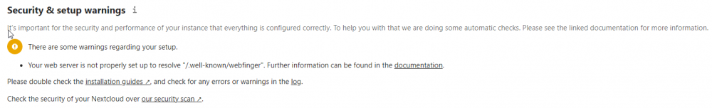

And I got it reduced to this last one:

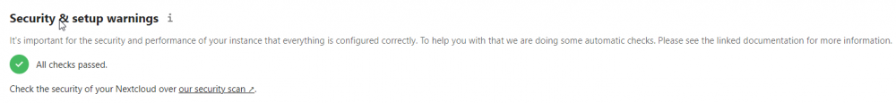

To anyone finding this "webfinger" error
Last error is related to cache (In chrome do the following) Open Dev Tools (F12), and while this is open right click on "normal" refresh button on your top left and select Empty cache and hard reload.
And all us ok ;-)
