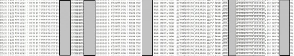

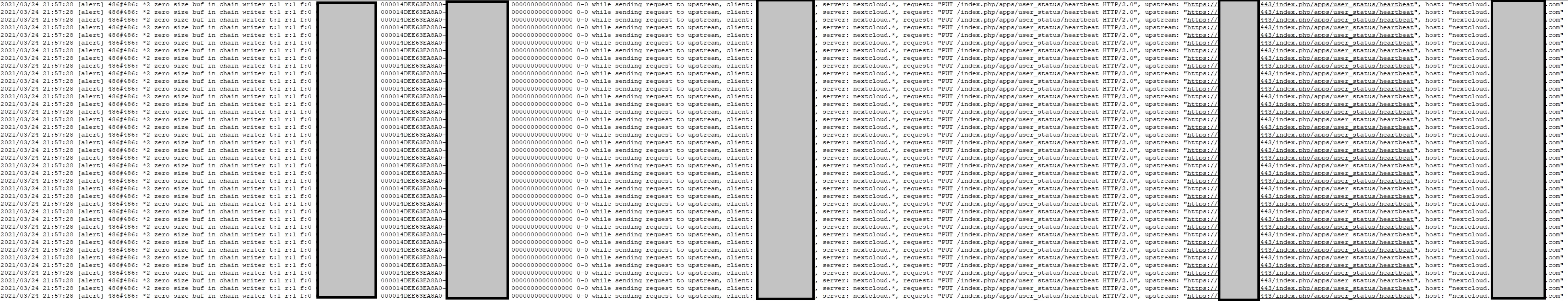

I have an issue with SWAG nextcloud and cloudflare keep getting these in the log, by the thousands, the log file got to 200 GB in one day, and then nextcloud is not responding anymore, any ideas what's wrong ?
I see this alert "zero size buf in chain writer t:1 r:1 f:0", I googled it but cannot find any resolution!
Does anyone here had a similar issue ?

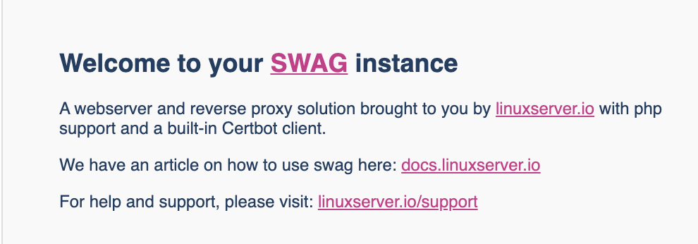

From outside my home network, going to https://my-ip takes me to the Swag splash page.
Right now, I have 4 unRAID dockers set at duckdns.org, and those all work. I was just surprised to see that my home ip by itself does this.
Is this OK?
19 hours ago, volcs0 said:
Is this expected behavior?
Is this OK?
That is normal.

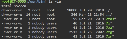

22 minutes ago, ThereIsNo said:
As I understand it p7zip is located at /usr/bin/
You must have installed it yourself from Nerd Pack.
You can get to the console inside any of your dockers by clicking on its icon and selecting Console.
But it doesn't look like p7zip exists inside the SWAG container.
Thanks for the fast reply!
I installed it from Nerd Pack and yeah, it does not exist inside SWAG. I dont know any other way than building swag myself with p7zip inside. And I dont think I am advanced enough for this or doing this frequently after swag updates. :/
chown or chmod also had no positive effect.

I have tried also with server_name photoprism.lan*
Although the internal docker dns works ok resolving the container name, I have tried also setting the proxy_pass with the final docker IP and port with no luck.
When I try to go to http://photoprism.lan I got redirected to a https://photoprism.lan/ and see the default nginx webpage:
Welcome to our server
The website is currently being setup under this address.
For help and support, please contact: [email protected]
Is this because by default only https is being configured to be proxied?
Any way of allowing http for internal lan without compromising security?
My certs are subdomains, as stated above, like nextcloud.mydomain.com but the photoprism is not in the same domain but photoprism.lan, does this cause the failure?
Thanks!
