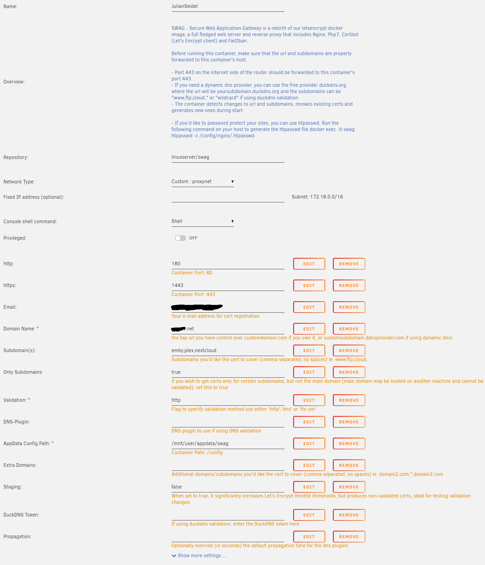

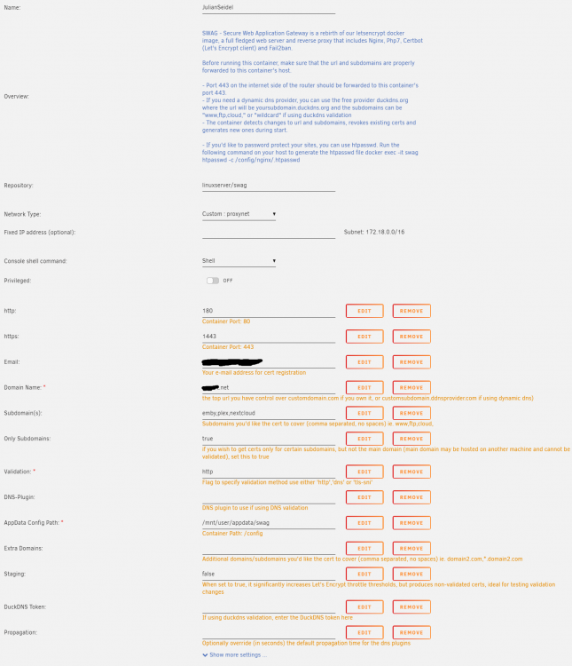

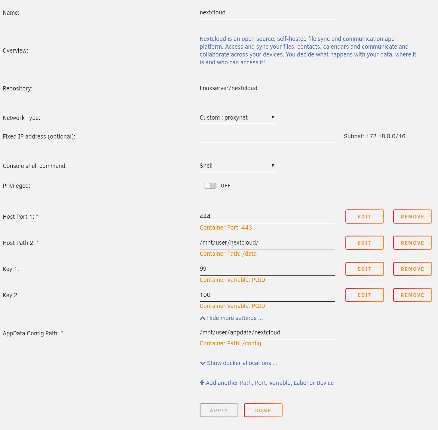

I'm just gonna post a few screenshots here..
These are my 'swag' container settings:
This is my 'nextcloud' container:
Then I went into the appdata\swag\nginx\proxy-confs folder to edit the nextcloud.subdomain.conf file (while erasing the .sample to make it a .conf file):

The subdomain is pingable, so I think that should not be the problem. The plex and emby docker are working fine with their own subdomains, but if I try to reach nextcloud, I'm always getting a "502 Bad Gateway  nginx/1.18.0" error message..
I'm really at a loss here :(

You are changing things you should not change. Change the port back to 443 and protocol to https in the proxy conf.
Edited by saarg

On 3/21/2021 at 10:33 AM, saarg said:
Swag can't connect to nextcloud, so it's probably not on the same custom bridge.
Thank you! I changed the bridge in the docker for the nextcloud container and upon restart it worked. I can now access it remotely, however I cannot seem to get it to work locally however. When I go the corect IP in firefox it tells me "The page isn't redirecting properly". I have changed in the config to add to the array the IP: '192.168.1.*' but still no luck.
Do you have any suggestions as to what is causing this?
I don't know why.

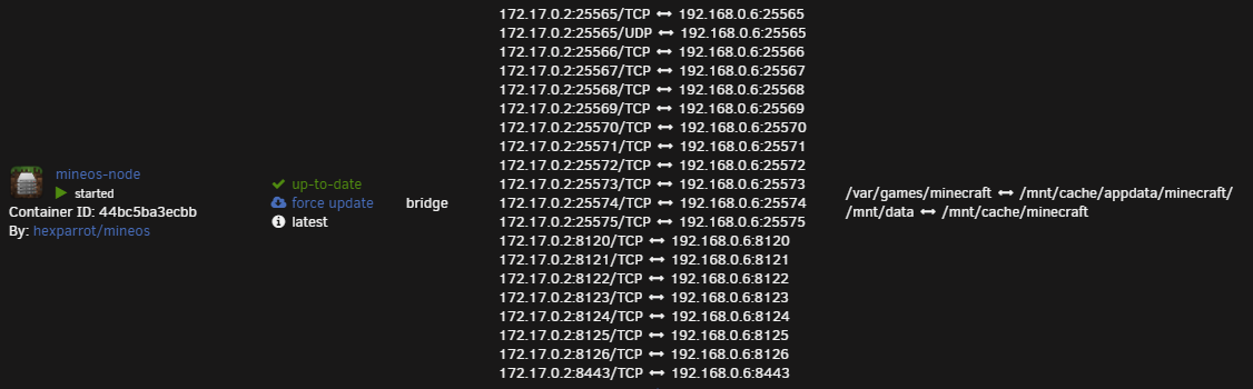

Thanks @saarg totally forgot about the capitol letters (The name came from the Docker pull)
But still seems like I am missing a connection (If anyone have any input to what I am missing then please give me a shout)
Swag is working for all other dockers (And I am getting cert. on all domains and sub domains)
The webserver is running and working 192.168.0.6:25568 (This port is also listed below on the docker)
The mineos docker creates a minecraft folder in the appdata (Not a mineos folder) don't know if this makes any difference
My config file is now:

Keep getting:
Kind of stuck here have tried allot of different things but end up breaking Swag for all other containers 😞
UPdate found this: https://gist.github.com/DmitryRendov/1efb672a0733aca5314dc3332d9823ac
But this seems to overcomplicate a simple link to port 25568 (In the above example the default port is 8123)
OK this works!
