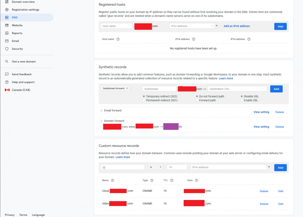

crusemm Posted January 23, 2021 Share Posted January 23, 2021 Solved it, CNAME in DNS wasn't configured correctly Quote Link to comment

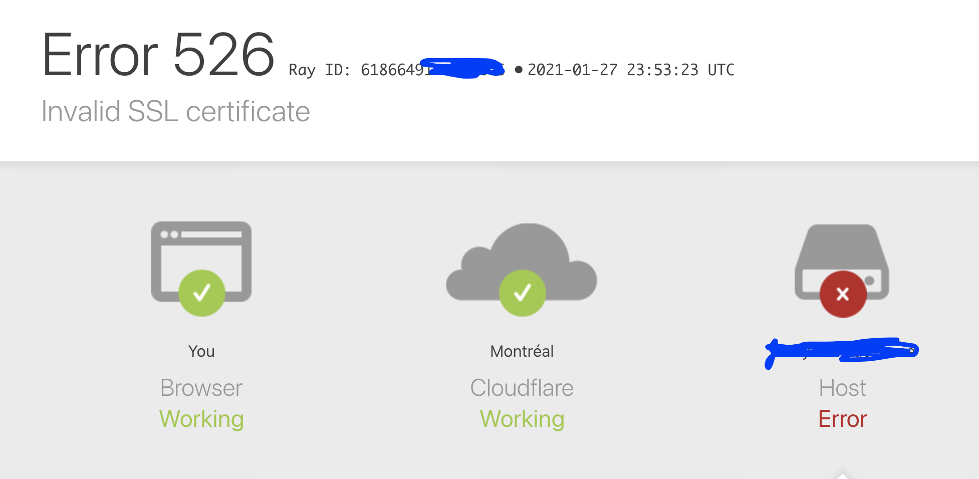

Moka Posted January 27, 2021 Share Posted January 27, 2021 Hi, I created a Cloudflare Origin Certificates pem and key. Which folder I need to put them? Quote Link to comment
saarg Posted January 27, 2021 Share Posted January 27, 2021 1 hour ago, Moka said: Hi, I created a Cloudflare Origin Certificates pem and key. Which folder I need to put them? For what? This container handles getting the certs. Quote Link to comment
Moka Posted January 28, 2021 Share Posted January 28, 2021 (edited) 1 hour ago, saarg said: For what? This container handles getting the certs. I want use Swag with Cloudflare in Full (strict). When I enable Full (strict), I get Invalid SSL certificate. Any idea how to fix that? Edited January 28, 2021 by Moka Quote Link to comment

saarg Posted January 28, 2021 Share Posted January 28, 2021 17 hours ago, Moka said: I want use Swag with Cloudflare in Full (strict). When I enable Full (strict), I get Invalid SSL certificate. Any idea how to fix that? I don't know what full mode is, but if you need to use certs you get from cloudflare, then I don't think it's possible with swag. Join our discord and you can ask there, as there are more people with more knowledge about swag. Quote Link to comment
