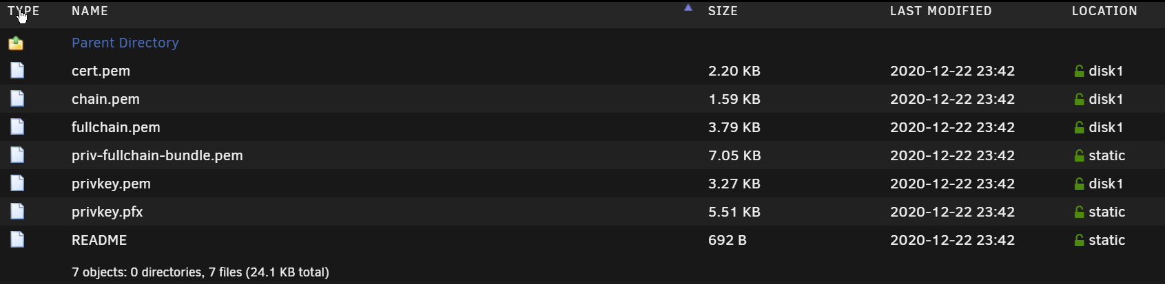

nginx: [emerg] cannot load certificate "/config/keys/letsencrypt/fullchain.pem": BIO_new_file() failed (SSL: error:02001002:system library:fopen:No such file or directory:fopen('/config/keys/letsencrypt/fullchain.pem','r') error:2006D080:BIO routines:BIO_new_file:no such file)
I got this error yesterday and I can not find out how to fix everything was working fine I kept getting emails saying my certificate was about to expire
Ok fixed it wiped old config and reinstalled now everything is good

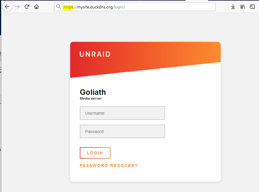

Good morning. Ok so what I mean by login section is this:
I can access the above screen over https when the default file contains the code:
    location ^~ /login/ {
        include /config/nginx/proxy.conf;
        proxy_pass http://192.168.1.222:80/login;
        #rewrite /login(.*) $1 break;
However it does not allow me to login to my server, on entering username/password it just refreshes the screen - I dont think its submitting the data as when entering incorrect login info it doesnt say that the data userame/pass was invalid. I can connect remotely to the login via normal http and it will submit the login details. However obviously I dont wish to do this over http so this is not currently a solution.
Thank you!! I hadnt set up a custom bridge, that was the issue I was having with the 502 error. Jellyfin and deluge are now working as expected. Now if I can only get the login screen to work then I think I'm good with Unraid.
SP
SP
Please don't reverse proxy your unraid webgui. It's not a hardened system. If you absolutely need to access it remotely, do so only using a VPN.
When using a custom bridge for swag you can't talk to unraid, so it will not work.
Edited by saarg
Hi Saag, well why am I able to access the web gui via http? Shouldnt it be disabled then if it poses a security risk?
SP
SP
You are exposing it to the whole world, that is not the same as having access on your local network.
I've just moved my appdata to its own cache drive (long overdue).  SWAG is the only thing I can't get to totally move, I guess its because the certs are loaded/protected?
I set the share to prefer the static cache drive, and disabled docker in settings and run the mover.  If i disable docker again and manually move these files will I break something*? (probably :D
*I should say i have read the readme and its pretty clear:
WARNING: DO NOT MOVE OR RENAME THESE FILES!
         Certbot expects these files to remain in this location in order
         to function properly!
However does moving the files to the same place on the cache count as moving them?
Edited by alexdodd
As long as you choose the new path in the appdata field in the container, you can move the files around as you want.
If you are only using the cache drive you should set it to cache only. Cache prefer will move the files in some situations to the array.
Yeah I set it to cache prefer only to move the bulk of things, and now its set back to cache only, and i'll manually move these files from the disk1 to static, wish me luck :D
The appdata path has never changed, just the underlying physical disk, which i'm not even convinced letsencrypt knows about, so this "move" isn't what the readme is referencing.
//Edit:  Sweet, nothing exploded, certs still valid, and everything still works!
