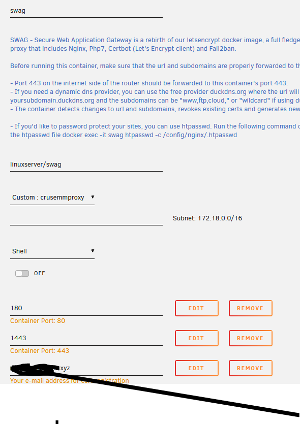

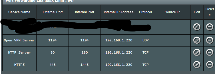

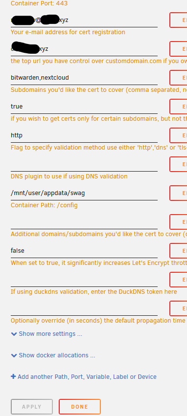

Need Help Setting up swag for the first time . I have my own domain, and I have the DNS through my provider point the subdomains bitwarden.XXXX.xyz and nextcloud.XXXX.xyz at mydomain.duckdns.org. I currently have openvpn running, and when i go to my server address with openvpn enabled, it gets through to the server, so I'm pretty sure that the duckdns part is working.
Not sure what I'm doing wrong1899836940_SWAG1TS1.thumb.PNG.5084851d685d31f59cf0adbad8c80c79.PNG1762041178_Swag2TS1.thumb.PNG.8bdecfb86c0bb5326ddfa879a257c822.PNG664081158_gandiTS1.thumb.PNG.1540048ef3dd9da3d5897d5834983c0b.PNG

Ok, now openvpn isn't working either

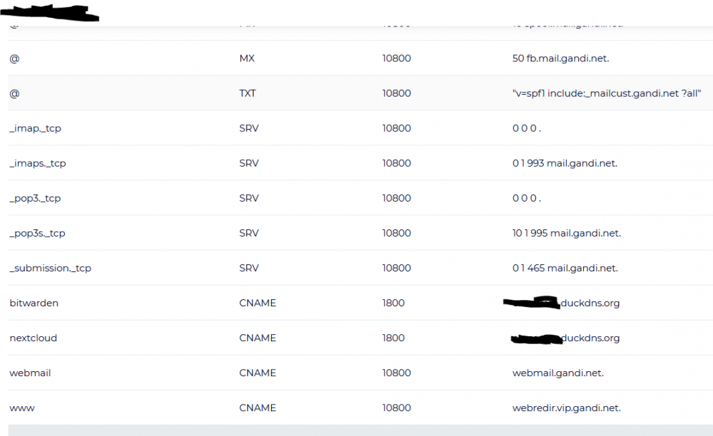

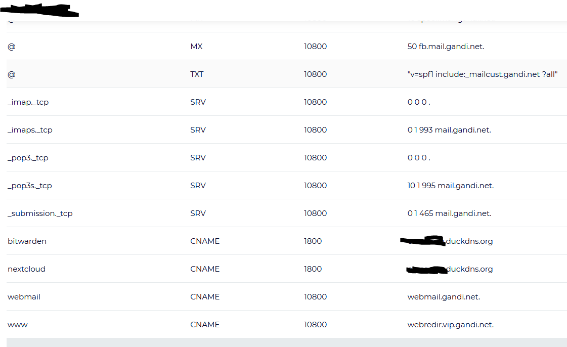

So I got openvpn working again, but I still can't get the certificate to issue I get the following error
Domain: bitwarden.XXXXX.xyz
Type: dns
Detail: DNS problem: NXDOMAIN looking up A for
bitwarden.XXXXX.xyz - check that a DNS record exists for this
I have Gandi liveDNS set to redirect from bitwarden.XXXXX.xyz to XXXXX.duckdns.org using CNAME
NAME         TYPE    TTL       VALUE
bitwarden CNAME 10800 XXXXX.duckdns.org
