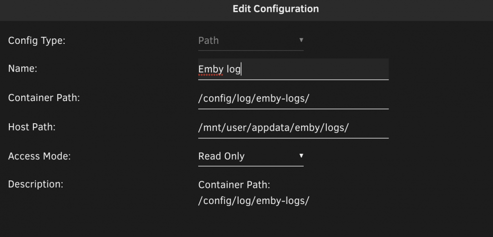

I am trying to understand why fail2ban ban is not banning.
fail2ban.log:
NOTICE [emby] Ban xxx.xxx.xxx.xxx
However, I am still able login immediately after the ban.
[DEFAULT]
# Changes the default ban action from "iptables-multiport", which causes issues on some platforms, to "iptables-allports".
banaction = iptables-allports
# "bantime" is the number of seconds that a host is banned.
bantime  = 600
# A host is banned if it has generated "maxretry" during the last "findtime"
# seconds.
findtime  = 600
# "maxretry" is the number of failures before a host get banned.
maxretry = 5
[emby]
enabled = true
filter = emby
logpath = /config/log/emby-logs/embyserver.txt
port = 80,443
# Fail2Ban for emby
[Definition]
failregex = AUTH-ERROR: <HOST> - Invalid user
HTTP Response 401 to <HOST>.
ignoreregex =
I also try to ban manually the ip, but I was still able to access to emby
 >fail2ban-client  set emby banip xxx.xxx.xxx.xxx
>1
>iptables -L
Chain f2b-emby (1 references)
target     prot opt source               destination
REJECT     all  --  xxx.xxx.xxx.xxx      anywhere             reject-with icmp-port-unreachable
RETURN     all  --  anywhere             anywhere
Edited by Moka
