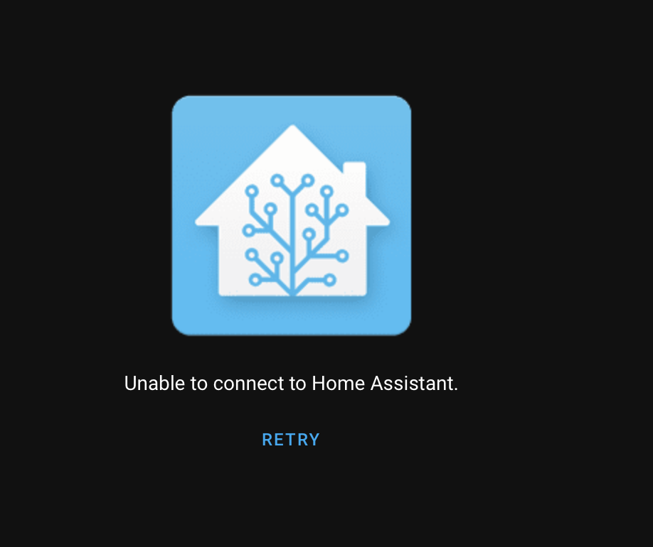

I have multiple services running behind a reverse nginx proxy. But I am having issues with home assistant. The UI loads but the calls don't get forwarded and error out
Failed to call service homeassistant/turn_off. Unable to find service light/turn_off
I am running https://hub.docker.com/r/homeassistant/home-assistant on Unraid. This is the nginx config. The site loads but gives errors when I try to turn on lights.
# make sure that your dns has a cname set for homeassistant and that your homeassistant container is not using a base url

This is the command used to run the container:
usr/local/emhttp/plugins/dynamix.docker.manager/scripts/docker create --name='HomeAssistant' --net='proxynet' --privileged=true -e TZ="America/Los_Angeles" -e HOST_OS="Unraid" -p '8123:8123/tcp' --device='/dev/ttyUSB0' 'homeassistant/home-assistant'
 I am not sure if its more suited for home assistant?
Edited by BoKKeR
Link to post

You have the name wrong for the container. You have to name it homeassistant with small letters.
Link to post
25 minutes ago, BoKKeR said:
thanks I tried that also. Same result I can resolve home assistant over nginx, but all the service calls fail.
We don't have the /api location in our proxy-conf and I'm not sure why you need it?
Link to post
9 hours ago, BoKKeR said:
Removing the block rebooting SWAG, I get even less access. I get to the login page. After login I am greeted with
Did you set homeassistant to use https om that port? If so, change it back to http. There is a similar problem like this fixed on this page.
Link to post
I cant find this option, but to make sure I made a new container with a new config location and adjusted the config in swag, restarted swagger. I get the https login page on the subdomain, upon login I end up with the same error page.
Link to post
