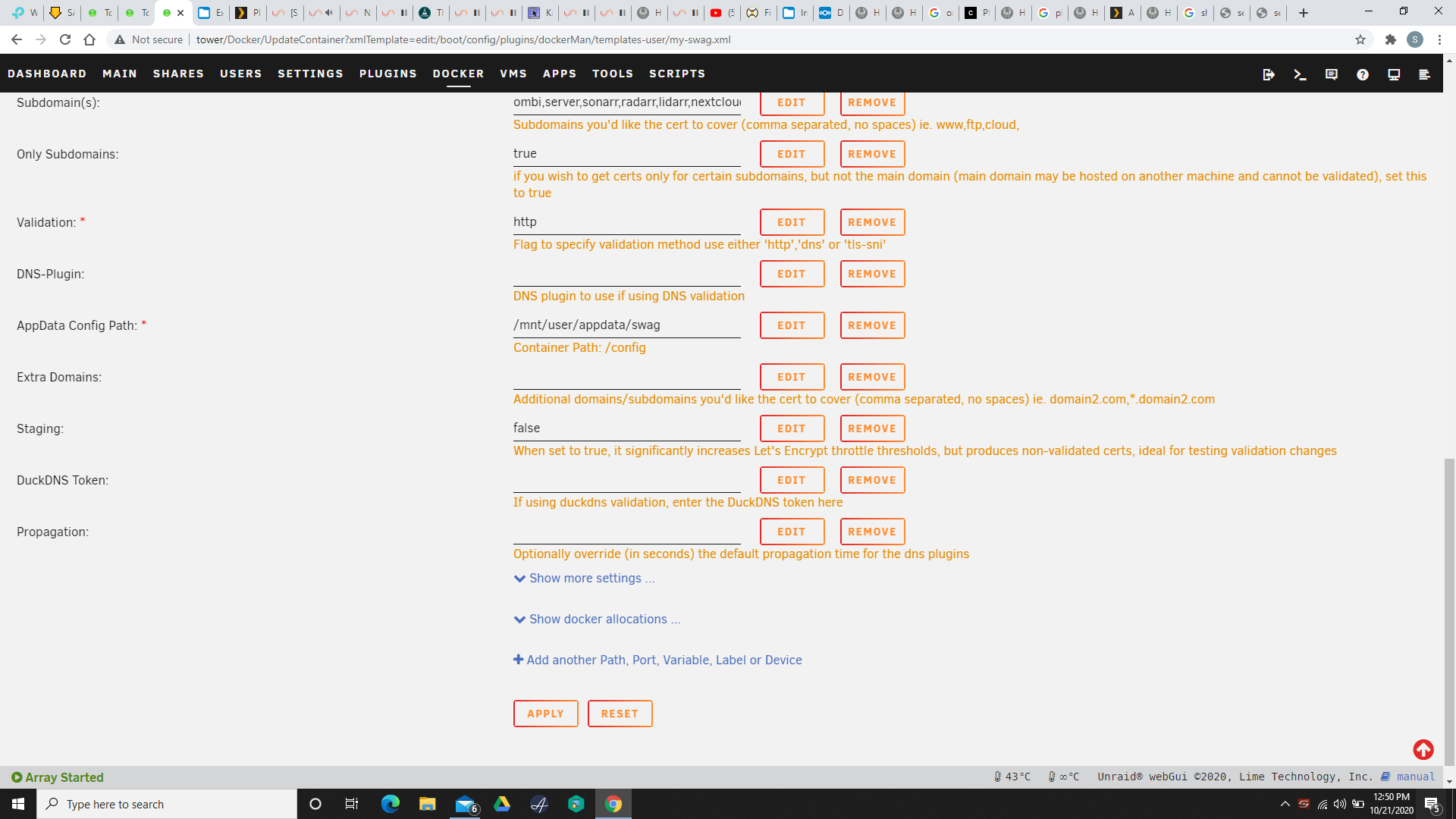

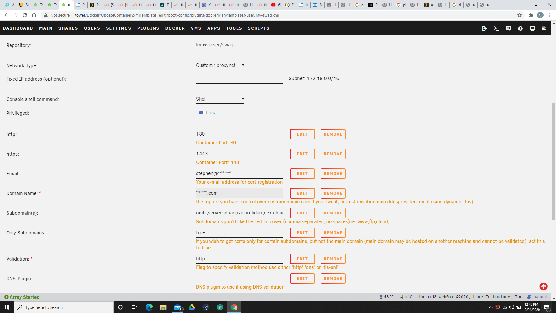

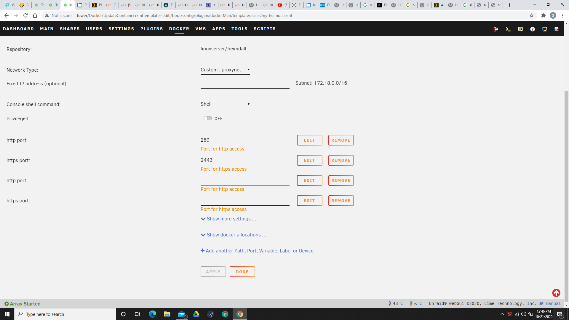

On 10/20/2020 at 2:06 AM, saarg said:
As I have said before, turn off swag and then see what happens if you go to the wan IP. If it still loads Heimdall, you have a port forwarding issue. If nothing loads, you have configured something in swag that makes Heimdall load.
I was able to look at this again this morning. I stopped Swag and here is what I get.....if I go to heimdall via the internet using my custom url it says "the website cant be reached".  If I go in Unraid to dockers/heimdall/webui then it just opens another instance of Unraid.
Heimdall is setup in the template to use the custom network type for reverse proxy, just like the other apps (radarr, sonarr, etc)....is that a issue? Should i not have set heimdall up in the reverse proxy network?
Here are screenshots of the templates......
Heimdall:
SWAG:

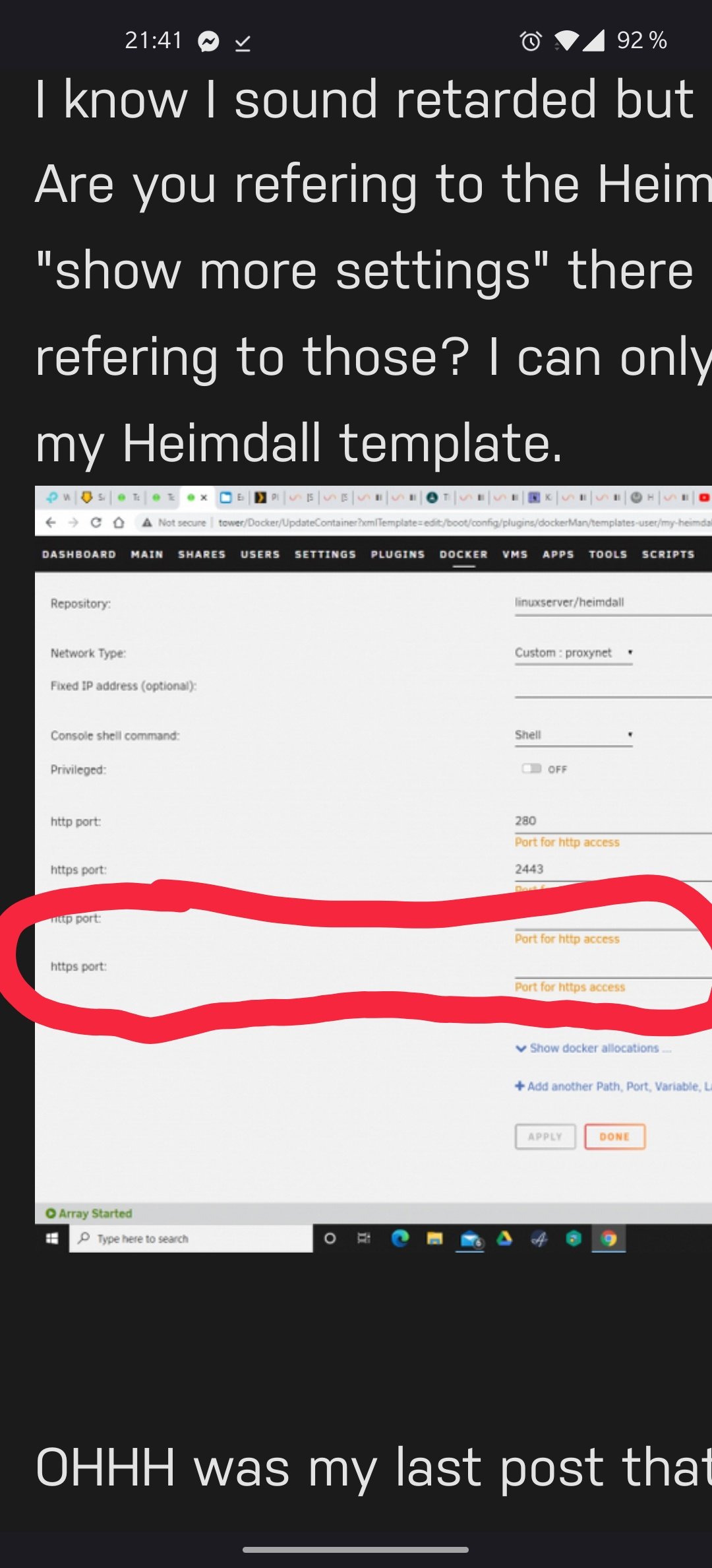

I'm a total newbie to these things so I'm trying to figure this stuff out.....
How would you go about ditching dynamic DNS (duck dns)?  Are you saying it's better to create a static wan IP and use A records instead of cnames that point to the dynamic dns? If so, what are the benifits?
The biggest domain registrars usually have an API to update the IP in case you don't have a static IP, so you don't need a static IP even if you buy a domain. And you can always use the free cloudflare DNS. They also have an API to update your IP.
Link to post
Heimdall:
SWAG:

1 hour ago, SPOautos said:
Hey @Saarg I just thought I'd quote this post, I think you may have not seen it since there were other posts after it. Hoping to get your input on it when you have some time. Thank You!
It should be like that if you stop swag.
And if you use the wan IP, you get the same respons?
You have double up for ports in your Heimdall template. Delete the extra set.
If I stop Swag and go to my WAN address over the internet it does "this site cant be reached".
I'm not following you regarding the Heimdall template ports. I only see one set of ports the http (280) and https (2443)....do you mean that I only need one of those, not both?
You have two http and two https in the container template. The two on the bottom can be deleted.

7 hours ago, SPOautos said:
I know I sound retarded but I cant find a second set.  Are you refering to the Heimdall template?  Under the "show more settings" there is a PUID and PGID, are you refering to those? I can only find the one set of ports in my Heimdall template.
OHHH was my last post that had the template images confusing because I had Heimdall and Swag templates in the post back to back?
I think you need to go check your eyes. Don't you see on the left side you have http port and https port twice?
Link to post
Confusion......do you mean to remove the line item with "remove" to the right?  I thought you were meaning to remove any actual port number.
How would those have got there if they aren't supposed to be there?? Does the fact that its duplicated mean there may be something wrong with the install?
