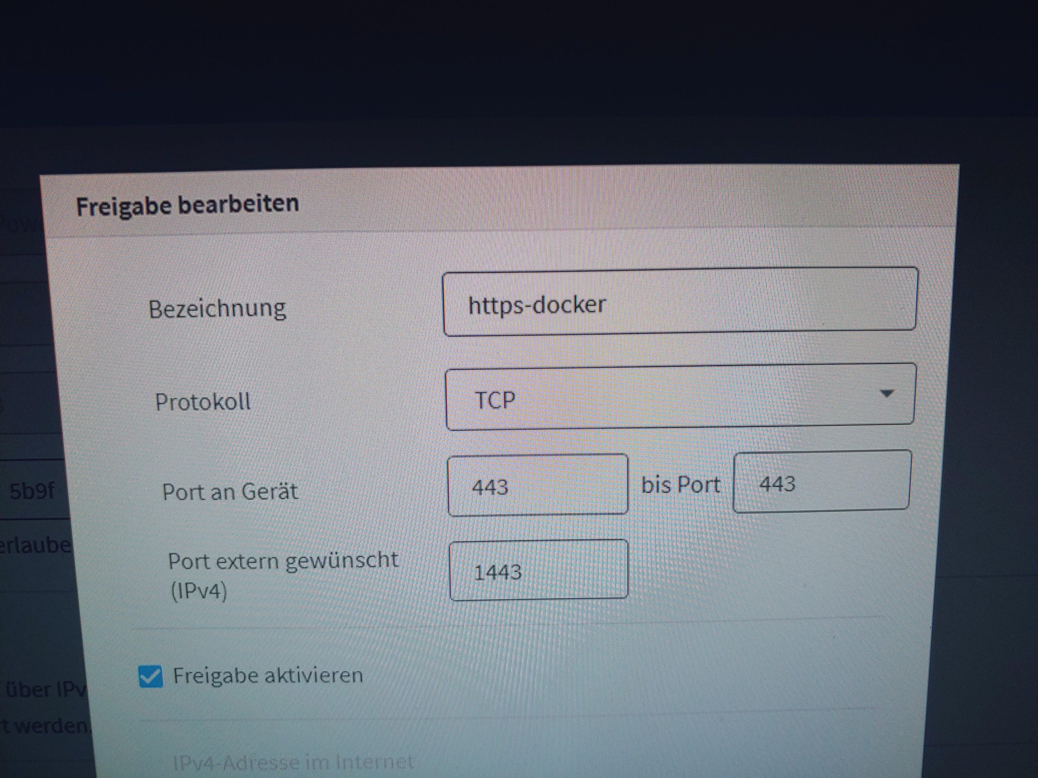

hello guys, total noob here...
i followed SpaceInvaderOnes tutorials on youtube to create a certificate using duckdns.org and swag
i did it before on a ubuntu server, but on unraid everything fails.
i did exactly as he was telling:
- created proxynet
- created 3 domains on duckdns (let's say jelly.duckdns.org, nextcloud.duckdns.org and syncthing.duckdns.org)
- put my email adress
- duckdns.org is the domain name
- jelly,nextcloud,syncthing are the subdomains
- true only subdomains
- validation http
- duckdns token entered
on duckdns docker:
- jelly.duckdns.org (tried only jell, tried putting all 3, etc.)
- entered the token
tried many other ways with wildcards and such, still it's being refused...
i think the issue might be my router (port forwarding) but now i've already reached the limit of tries for this week :(
i attached a screenshot of my router setup, which again followed on youtube.

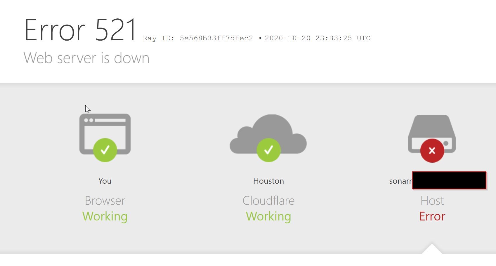

First off I am a novice at any of this proxy network setup stuff with very little experience and understanding of what I am doing or what I am doing incorrectly, so please be patient (and if possible gentle) with your replies and comments. :)
So I followed the guides by @SpaceInvaderOne , namely these three below merged together, and set up everything using my own domain.
Video #1Video #2 & Video #3 (related to this docker). Testing with sonarr for starters.
I got server ready on the swag logs (pasted below):
_ ()
| | ___ _ __
| | / __| | | / \
| | \__ \ | | | () |
|_| |___/ |_| \__/
Brought to you by linuxserver.io
To support the app dev(s) visit:
Certbot: https://supporters.eff.org/donate/support-work-on-certbot
To support LSIO projects visit:
https://www.linuxserver.io/donate/
GID/UID
User uid: 99
User gid: 100
[cont-init.d] 10-adduser: exited 0.
[cont-init.d] 20-config: executing...
[cont-init.d] 20-config: exited 0.
[cont-init.d] 30-keygen: executing...
using keys found in /config/keys
[cont-init.d] 30-keygen: exited 0.
[cont-init.d] 50-config: executing...
Variables set:
PUID=99
PGID=100
TZ=America/Chicago
URL=mydomain.com
SUBDOMAINS=wildcard
EXTRA_DOMAINS=
ONLY_SUBDOMAINS=true
VALIDATION=dns
DNSPLUGIN=cloudflare
EMAIL=myemailaddress
STAGING=false
SUBDOMAINS entered, processing
Wildcard cert for only the subdomains of mydomain.com will be requested
E-mail address entered: myemailaddress here
dns validation via cloudflare plugin is selected
Certificate exists; parameters unchanged; starting nginx
Starting 2019/12/30, GeoIP2 databases require personal license key to download. Please retrieve a free license key from MaxMind,
and add a new env variable "MAXMINDDB_LICENSE_KEY", set to your license key.
[cont-init.d] 50-config: exited 0.
[cont-init.d] 60-renew: executing...
The cert does not expire within the next day. Letting the cron script handle the renewal attempts overnight (2:08am).
[cont-init.d] 60-renew: exited 0.
[cont-init.d] 99-custom-files: executing...
[custom-init] no custom files found exiting...
[cont-init.d] 99-custom-files: exited 0.
[cont-init.d] done.
[services.d] done.
nginx: [alert] detected a LuaJIT version which is not OpenResty's; many optimizations will be disabled and performance will be compromised (see https://github.com/openresty/luajit2 for OpenResty's LuaJIT or, even better, consider using the OpenResty releases from https://openresty.org/en/download.html)
Server ready
  • duckdns subdomain created
  • duckdns container installed and running updating every 5 minutes
  • ports are forwarded, not sure if 80 needs to be forwarded for dns validation, but it is.
  • CNAMES are created on cloudflare and pointed to duckdns subdomain created above, and proxied
  • both dockers are on proxynet (docker network created for this)
  • config files are edited,
  • server is up and running and sonarr can be accessed locally.
But when I try to access
sonarr.mydomain.com
on chrome, I get the error 521 - webserver is down.
Can someone help tell me what I did wrong and how to correct this please?
Thanks,
Abhi
Edited by abhi.ko
Added a step that was missed earlier.
- created proxynet
- validation http
on duckdns docker:
- entered the token
now i don't know if i should put 1443 or 443 on the swag docker... according to SpaceInvaderOne 1443 but that has already failed.
at the point of giving up unless someone has an idea what could be wrong. would be so glad if someone could help...
cheers guys
Don't use duckdns.org as the domain. You don't own it. you need to use whateveruseryoucreated.duckdns.org as the domain and then the subdomains are subdomains.whateveruseryoucreated.duckdns.org
You might also have the port forwarding wrong. You need to forward port 80 also since you are doing http validation.
External port is 443 and internal port is 1443. Hard to say what you have in your screenshot as it's in german ;)
Also port forward external port 80 to whatever port you have on the swag container.
Link to post
