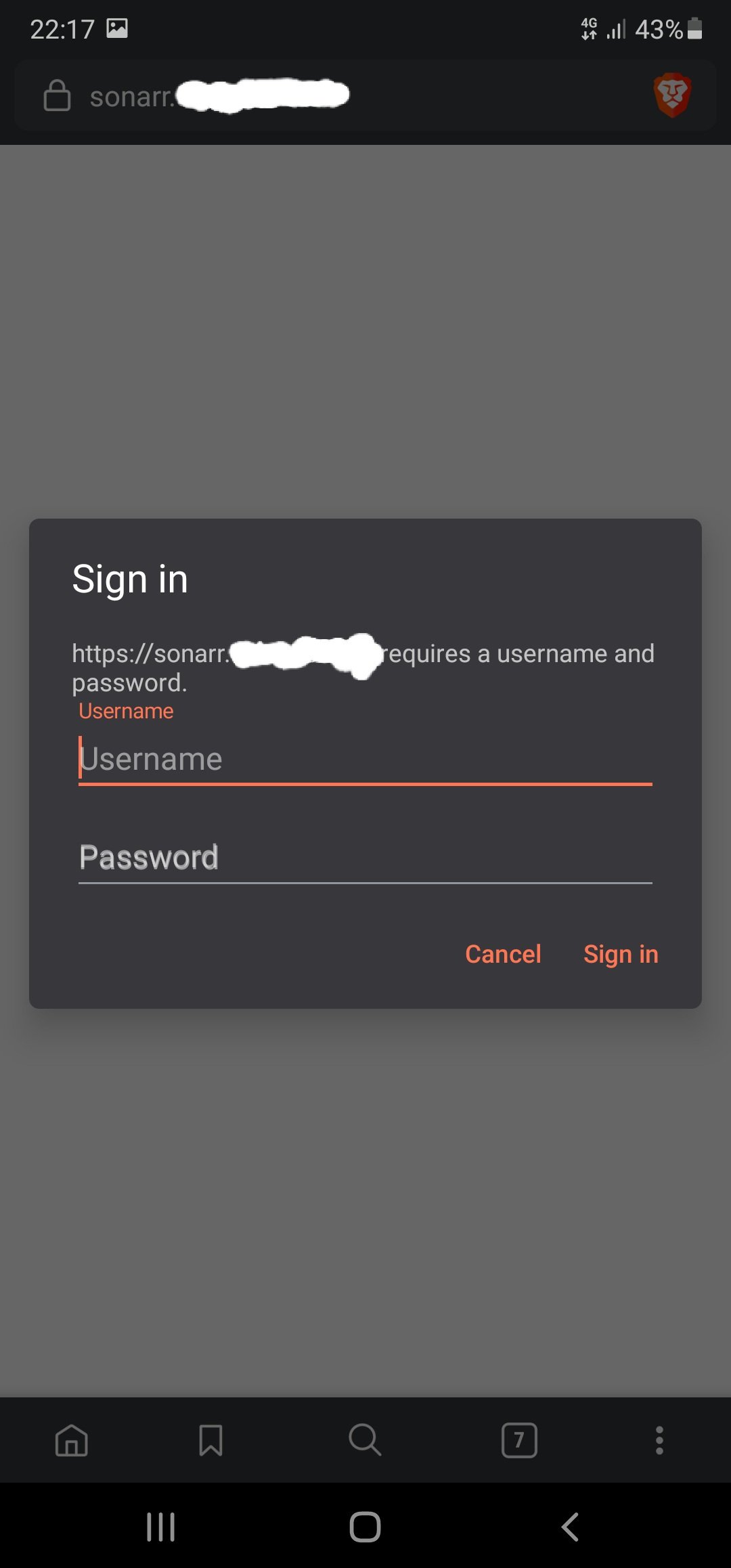

Sorry for all the posts but I'm still trying to beat my way through all of this and get it working....I dont know much about computers so just trying to figure all this out. BUT, its coming along....a little progress here and there and I appreciate you guys!
OKAY, So when you rename a configuration file to remove the ".sample" then restart SWAG, should it put another sample version of the same file back in? Where I now have two....the sample version and the new one without sample?
I went to the config files in Krusader and tried just right clicking and renaming, then going down to properties and renaming it there, then I tried to open with Kate and rename then save. In any case, once I restart SWAG it puts a sample version back in there so that I have both. Is that correct?  The reason I am questioning if I am doing this correct is because when I go to the subdomain in the browser instead of getting the apps GUI, I am getting this page.... That says "welcome to out server"
Any idea on what is the most likely problem that would be causing this page instead of the GUI?
Thanks for all your advice!
Edited by SPOautos
Link to post
That is perfectly normal, if there is no sample file, the container will create one upon restart, what's important is the conf file "without" the ".sample".
I note that the above url is now correctly forwarding to your Sonarr. Please redact the URL and enable authentication in settings, your Sonarr is exposed for anyone to access.
Edited by LoneTraveler
Link to post
I enabled authentication in Sonarr...thanks for that!  However, I'm still getting this same "Welcome to our server"  page. I even tried it from my phone so that I wouldn't be on the same internet connection as my server.  Are you able to pull it up???
Thank!
Edited by SPOautos
Link to post
Thank!
Not a problem.
It loaded for me (Dukes of Hazard) 😉, if it's still not loading for you I'd suggest restarting the container and clearing your browser cache, then try again.
Link to post
9 minutes ago, LoneTraveler said:
Not a problem.
I suppose it is browser cache like you said....on my phone when I use a incognito window it opened right up to the sonarr login.
Dukes of Hazard takes me back!  It feels like looking through a old photo album of the past. Love it!
This stuff is a lot to chew through for someone who hasnt done much more with a computer than email, browsing, Word docs, saving pictures   lol.  I'm in WAY over my head, but the forum and SI videos has been a HUGE help....slowly fighting my way through it all, seeing that login screen is like a light at the end of the tunnel  lol.....or maybe like the pile of dirt that I'm fixing to ramp 100' off of  LOL
I appreciate you checking it out for me! Thanks!
Edited by SPOautos
Link to post
Hahaha I know how you feel. I'm relatively new here myself, but you'll soon start picking bits up.
You've made a great start with Sonarr and following Spaceinvaderone's tutorial, so what I'd recommend is keep a copy of the files you have edited so that you can refer back to "what works", and build from there.
I've just recently finished reading this entire SWAG thread, I'd genuinely advise you to do the same in your spare time, there is a heap of useful information here and will put you in good standing to tackle your next unraid adventure. 👍
All the best.
