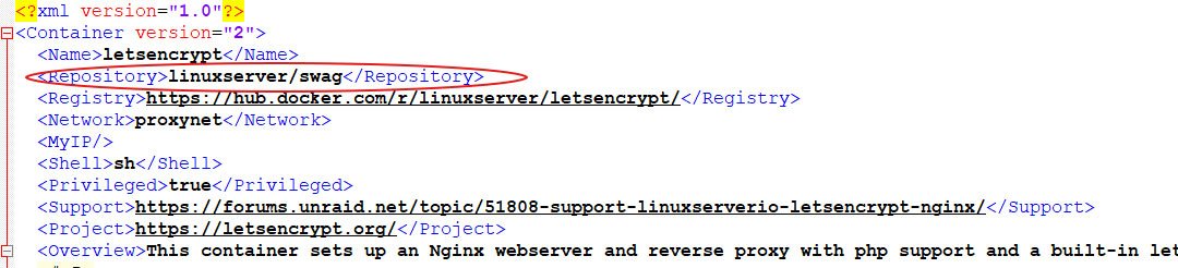

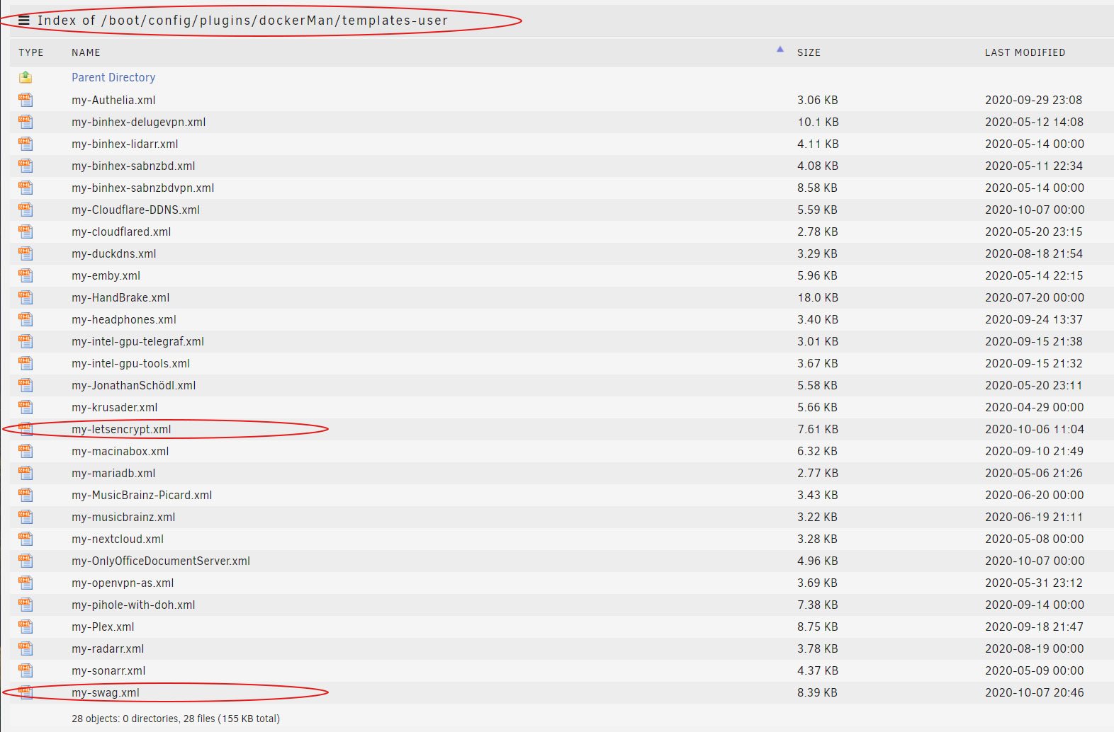

Mor9oth Posted October 7, 2020 Share Posted October 7, 2020 Quote Meanwhile, I found out that on the flash drive there is something like a cache of the container settings that also keeps the .xml of the deleted containers. Since I renamed the repository from "lets encrypt" to "swag" while also adding the new swag container, I guess something went wrong with the assignment. The renamed Let's encrypt: The original Swag: I guess because of the same name and because the my-letsencrypt.xml was the first file, it has priority. I found the XMLs on this Location on the Flash Drive: So in my opinion the fix must be to just erase the "my-letsencrypt.xml" file, right? Could someone please confirm this to me? Could someone please also explain a noob how to delete the my-letsencrypt.xml from my flash drive? 😀 Thank you for help! Quote Link to comment

Mor9oth Posted October 7, 2020 Share Posted October 7, 2020 Quote Well ... even removing the my-letsencrypt.xml did not work. Still the wrong icon! Quote Link to comment
Ryguy Posted October 7, 2020 Share Posted October 7, 2020 25 minutes ago, Mor9oth said: Edit the template. Click advanced settings and change the icon URL to https://raw.githubusercontent.com/linuxserver/docker-templates/linuxserver.io/img/linuxserver-ls-logo.png Quote Link to comment
Mor9oth Posted October 7, 2020 Share Posted October 7, 2020 Quote Edit the template. Click advanced settings and change the icon URL to https://raw.githubusercontent.com/linuxserver/docker-templates/linuxserver.io/img/linuxserver-ls-logo.png This was exactly what I have done. But It doesn't matter which Icon I put that way in. It does not change. Please take a look at what I have documented then you will see. Quote Link to comment

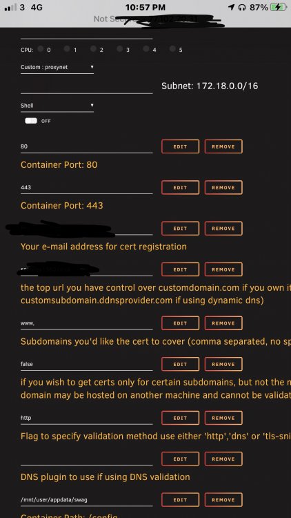

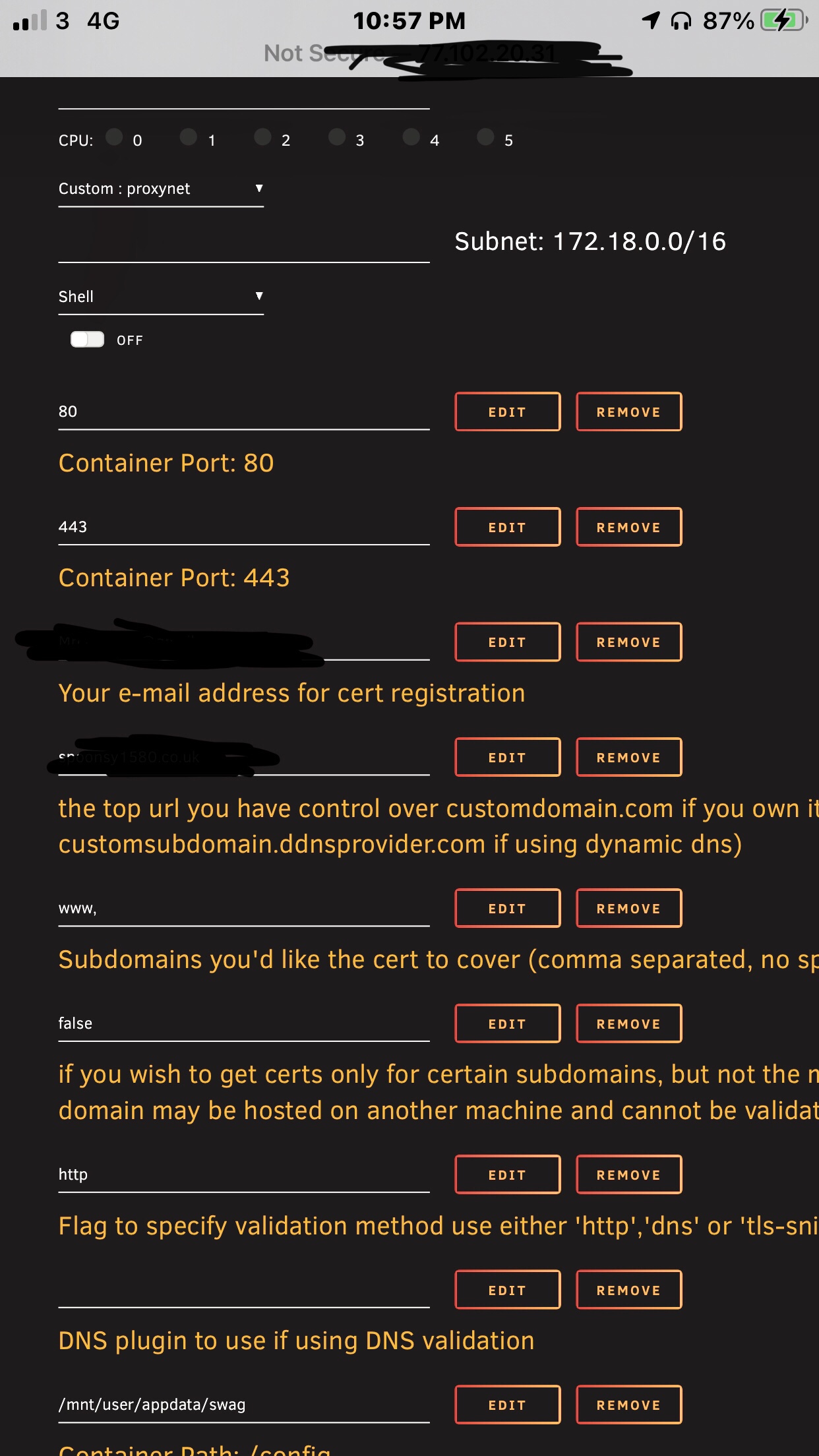

Spoonsy1480 Posted October 7, 2020 Share Posted October 7, 2020 Just trying to configure my server again after a mishap earlier, I had letsencrypt and changed to swag now I’m trying to start a fresh and I get this Saving debug log to /var/log/letsencrypt/letsencrypt.logPlugins selected: Authenticator standalone, Installer NoneObtaining a new certificateAn unexpected error occurred:The server will not issue certificates for the identifier :: Error creating new order :: Cannot issue for "lidarr": Domain name needs at least one dot (and 4 more problems. Refer to sub-problems for more information.)Please see the logfiles in /var/log/letsencrypt for more details.IMPORTANT NOTES:- Your account credentials have been saved in your Certbotconfiguration directory at /etc/letsencrypt. You should make asecure backup of this folder now. This configuration directory willalso contain certificates and private keys obtained by Certbot somaking regular backups of this folder is ideal.ERROR: Cert does not exist! Please see the validation error above. The issue may be due to incorrect dns or port forwarding settings. Please fix your settings and recreate the containerMy template isAny help would be grateful Sent from my iPhone using Tapatalk Quote Link to comment
aptalca Posted October 7, 2020 Share Posted October 7, 2020 39 minutes ago, Spoonsy1480 said: Just trying to configure my server again after a mishap earlier, I had letsencrypt and changed to swag now I’m trying to start a fresh and I get this Saving debug log to /var/log/letsencrypt/letsencrypt.log Plugins selected: Authenticator standalone, Installer None Obtaining a new certificate An unexpected error occurred: The server will not issue certificates for the identifier :: Error creating new order :: Cannot issue for "lidarr": Domain name needs at least one dot (and 4 more problems. Refer to sub-problems for more information.) Please see the logfiles in /var/log/letsencrypt for more details. IMPORTANT NOTES: - Your account credentials have been saved in your Certbot configuration directory at /etc/letsencrypt. You should make a secure backup of this folder now. This configuration directory will also contain certificates and private keys obtained by Certbot so making regular backups of this folder is ideal. ERROR: Cert does not exist! Please see the validation error above. The issue may be due to incorrect dns or port forwarding settings. Please fix your settings and recreate the container My template is Any help would be grateful Sent from my iPhone using Tapatalk The container thinks your url is set to "lidarr" Post a full log Quote Link to comment
Spoonsy1480 Posted October 8, 2020 Share Posted October 8, 2020 [s6-init] making user provided files available at /var/run/s6/etc...exited 0.[s6-init] ensuring user provided files have correct perms...exited 0.[fix-attrs.d] applying ownership & permissions fixes...[fix-attrs.d] done.[cont-init.d] executing container initialization scripts...[cont-init.d] 01-envfile: executing...[cont-init.d] 01-envfile: exited 0.[cont-init.d] 10-adduser: executing...-------------------------------------_ ()| | ___ _ __| | / __| | | / \| | \__ \ | | | () ||_| |___/ |_| \__/Brought to you by linuxserver.io-------------------------------------To support the app dev(s) visit:Certbot: https://supporters.eff.org/donate/support-work-on-certbotTo support LSIO projects visit:https://www.linuxserver.io/donate/-------------------------------------GID/UID-------------------------------------User uid: 99User gid: 100-------------------------------------[cont-init.d] 10-adduser: exited 0.[cont-init.d] 20-config: executing...[cont-init.d] 20-config: exited 0.[cont-init.d] 30-keygen: executing...using keys found in /config/keys[cont-init.d] 30-keygen: exited 0.[cont-init.d] 50-config: executing...Variables set:PUID=99PGID=100TZ=America/Los_AngelesURL=myipaddressSUBDOMAINS=www,EXTRA_DOMAINS=radarr,sonarr,plex,lidarr,nzbget,ONLY_SUBDOMAINS=falseVALIDATION=httpDNSPLUGIN=EMAIL=MyemailSTAGING=falseSUBDOMAINS entered, processingSUBDOMAINS entered, processingSub-domains processed are: -d www.myipaddressEXTRA_DOMAINS entered, processingExtra domains processed are: -d radarr -d sonarr -d plex -d lidarr -d nzbgetE-mail address entered: myemailhttp validation is selectedDifferent validation parameters entered than what was used before. Revoking and deleting existing certificate, and an updated one will be createdGenerating new certificateSaving debug log to /var/log/letsencrypt/letsencrypt.logPlugins selected: Authenticator standalone, Installer NoneObtaining a new certificateAn unexpected error occurred:The server will not issue certificates for the identifier :: Error creating new order :: Cannot issue for "lidarr": Domain name needs at least one dot (and 4 more problems. Refer to sub-problems for more information.)Please see the logfiles in /var/log/letsencrypt for more details.IMPORTANT NOTES:- Your account credentials have been saved in your Certbotconfiguration directory at /etc/letsencrypt. You should make asecure backup of this folder now. This configuration directory willalso contain certificates and private keys obtained by Certbot somaking regular backups of this folder is ideal.ERROR: Cert does not exist! Please see the validation error above. The issue may be due to incorrect dns or port forwarding settings. Please fix your settings and recreate the containerThis is my logSent from my iPhone using Tapatalk Quote Link to comment
saarg Posted October 8, 2020 Share Posted October 8, 2020 3 hours ago, Spoonsy1480 said: [s6-init] making user provided files available at /var/run/s6/etc...exited 0. [s6-init] ensuring user provided files have correct perms...exited 0. [fix-attrs.d] applying ownership & permissions fixes... [fix-attrs.d] done. [cont-init.d] executing container initialization scripts... [cont-init.d] 01-envfile: executing... [cont-init.d] 01-envfile: exited 0. [cont-init.d] 10-adduser: executing... ------------------------------------- _ () | | ___ _ __ | | / __| | | / \ | | \__ \ | | | () | |_| |___/ |_| \__/ Brought to you by linuxserver.io ------------------------------------- To support the app dev(s) visit: Certbot: https://supporters.eff.org/donate/support-work-on-certbot To support LSIO projects visit: https://www.linuxserver.io/donate/ ------------------------------------- GID/UID ------------------------------------- User uid: 99 User gid: 100 ------------------------------------- [cont-init.d] 10-adduser: exited 0. [cont-init.d] 20-config: executing... [cont-init.d] 20-config: exited 0. [cont-init.d] 30-keygen: executing... using keys found in /config/keys [cont-init.d] 30-keygen: exited 0. [cont-init.d] 50-config: executing... Variables set: PUID=99 PGID=100 TZ=America/Los_Angeles URL=myipaddress SUBDOMAINS=www, EXTRA_DOMAINS=radarr,sonarr,plex,lidarr,nzbget, ONLY_SUBDOMAINS=false VALIDATION=http DNSPLUGIN= EMAIL=Myemail STAGING=false SUBDOMAINS entered, processing SUBDOMAINS entered, processing Sub-domains processed are: -d www.myipaddress EXTRA_DOMAINS entered, processing Extra domains processed are: -d radarr -d sonarr -d plex -d lidarr -d nzbget E-mail address entered: myemail http validation is selected Different validation parameters entered than what was used before. Revoking and deleting existing certificate, and an updated one will be created Generating new certificate Saving debug log to /var/log/letsencrypt/letsencrypt.log Plugins selected: Authenticator standalone, Installer None Obtaining a new certificate An unexpected error occurred: The server will not issue certificates for the identifier :: Error creating new order :: Cannot issue for "lidarr": Domain name needs at least one dot (and 4 more problems. Refer to sub-problems for more information.) Please see the logfiles in /var/log/letsencrypt for more details. IMPORTANT NOTES: - Your account credentials have been saved in your Certbot configuration directory at /etc/letsencrypt. You should make a secure backup of this folder now. This configuration directory will also contain certificates and private keys obtained by Certbot so making regular backups of this folder is ideal. ERROR: Cert does not exist! Please see the validation error above. The issue may be due to incorrect dns or port forwarding settings. Please fix your settings and recreate the container This is my log Sent from my iPhone using Tapatalk The subdomains go in the subdomain field and not extra domain field. Quote Link to comment
aptalca Posted October 8, 2020 Share Posted October 8, 2020 Also, url should be a domain name, not ip address Quote Link to comment

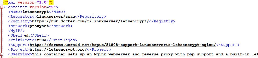

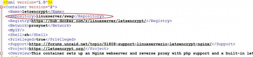

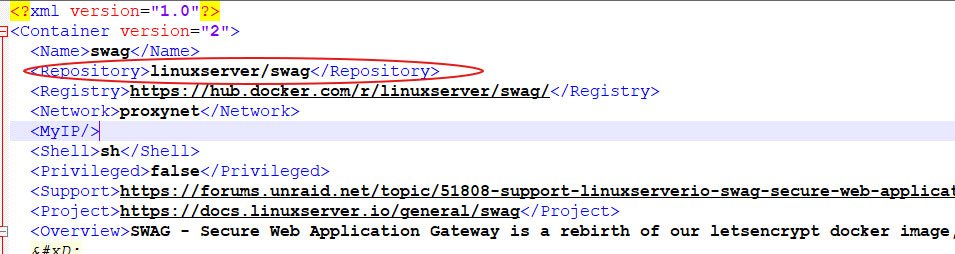

Mor9oth Posted October 9, 2020 Share Posted October 9, 2020 On 10/7/2020 at 10:53 PM, Mor9oth said: This was exactly what I have done. But It doesn't matter which Icon I put that way in. It does not change. Please take a look at what I have documented then you will see. Finally, I solved it. So for everybody who has the same Problems with showing up the old Let's Encrypt Icon here is the solution: Go to advanced view and copy the correct image-url to the clipboard Rename the Image-URL to something that does not exist and save it. Then you will see that the icon is missing Go back to the advanced view and paste the correct image-url At least this worked for me. But maybe the steps further (removing the old .xml) could also do have an impact on this. Here I documented everything that I did: Quote Link to comment
kuhnamatata Posted October 10, 2020 Share Posted October 10, 2020 13 hours ago, Mor9oth said: Finally, I solved it. So for everybody who has the same Problems with showing up the old Let's Encrypt Icon here is the solution: Go to advanced view and copy the correct image-url to the clipboard Rename the Image-URL to something that does not exist and save it. Then you will see that the icon is missing Go back to the advanced view and paste the correct image-url At least this worked for me. But maybe the steps further (removing the old .xml) could also do have an impact on this. Here I documented everything that I did: Yup, I had the same problem and had to delete the old my-letsencrypt.xml to get it to change the icon. Thanks for posting Quote Link to comment
