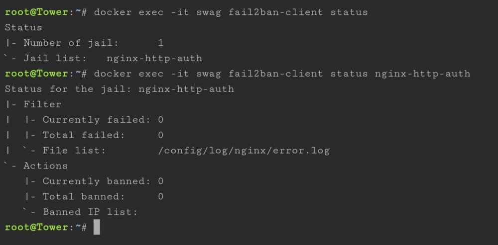

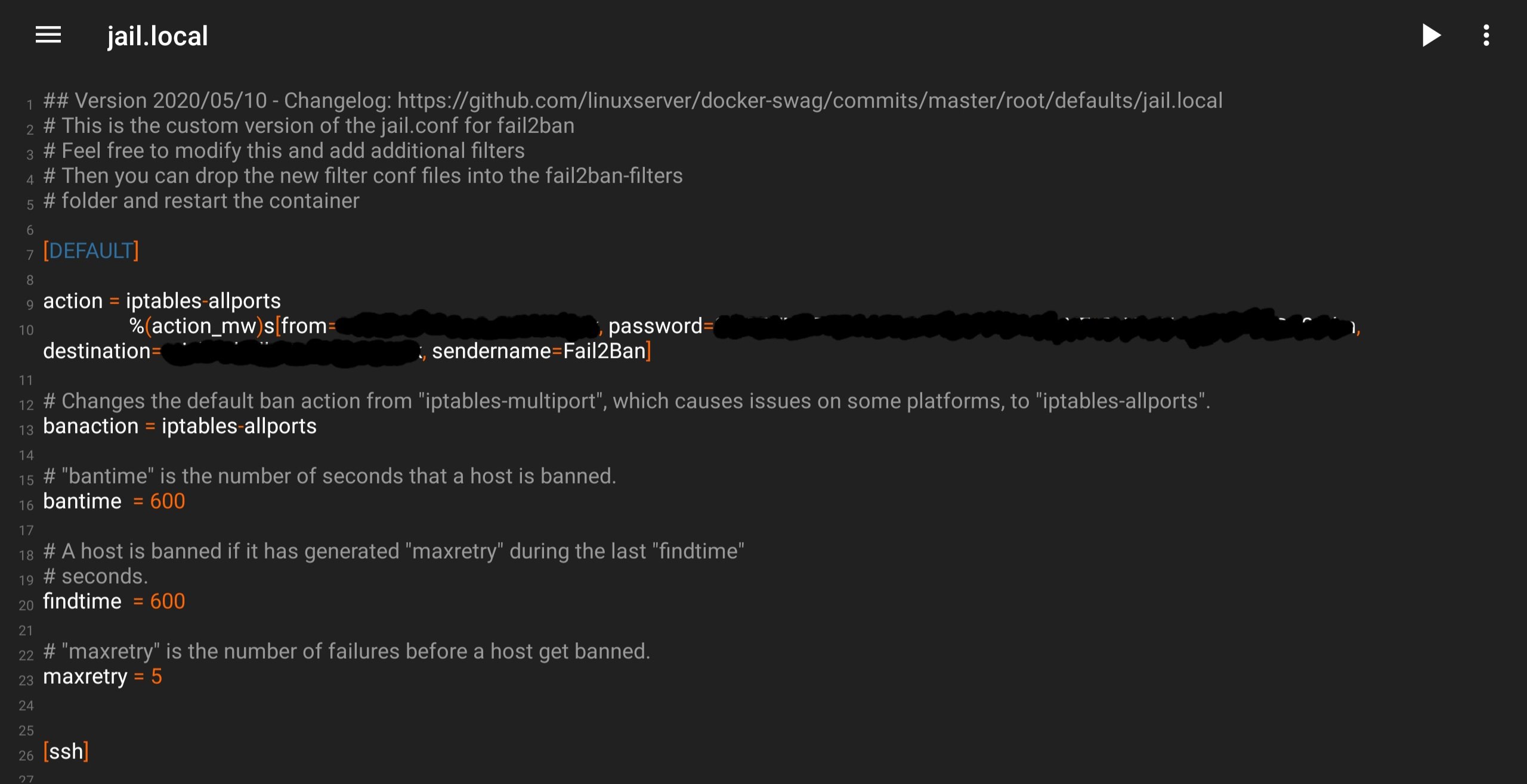

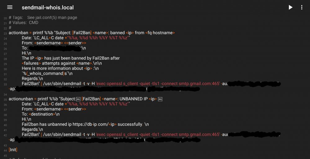

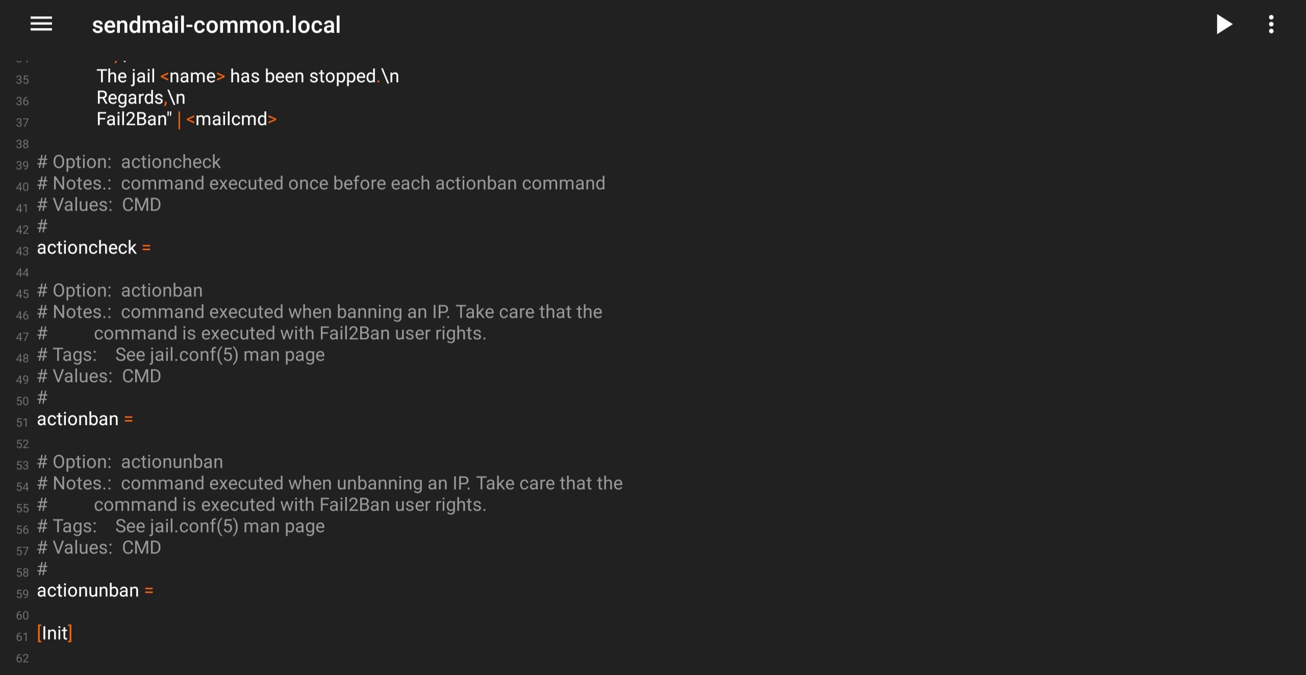

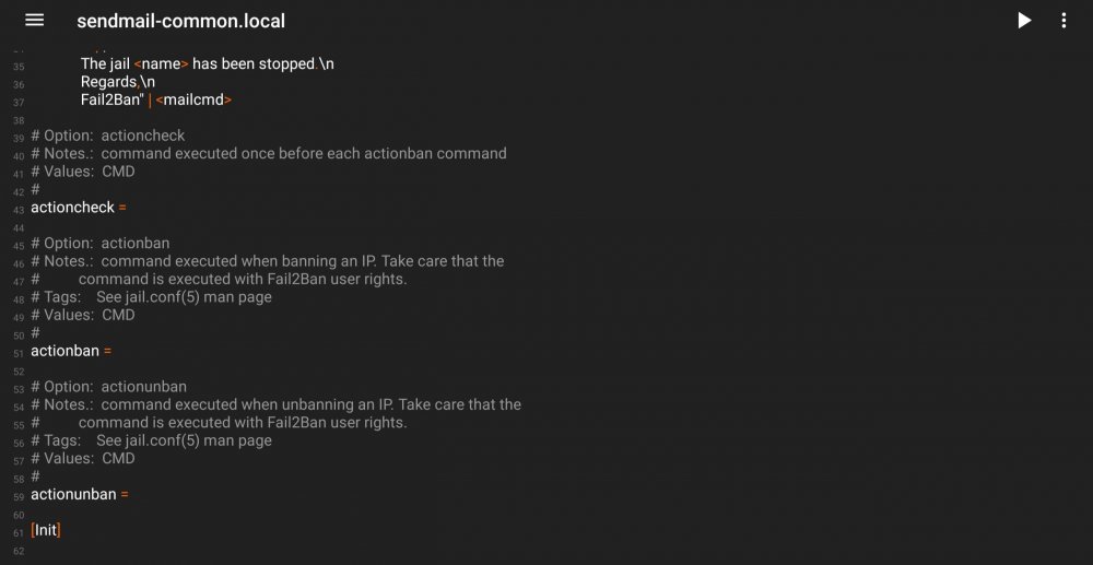

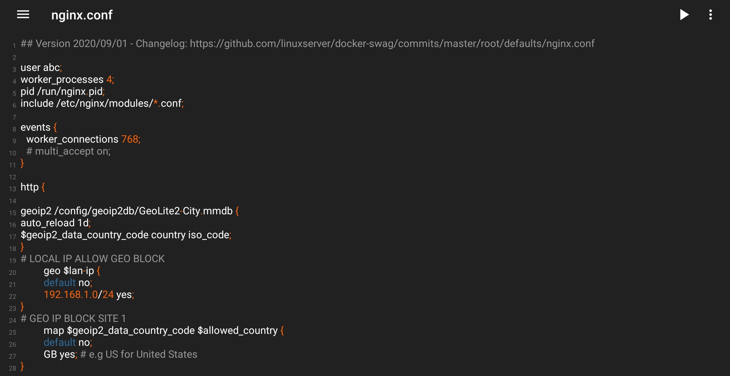

Hello,
I have just followed these two guides;
https://technicalramblings.com/blog/cloudflare-fail2ban-integration-with-automated-set_real_ip_from-in-nginx/
https://technicalramblings.com/blog/blocking-countries-with-geolite2-using-the-letsencrypt-docker-container/
Almost everything seems to be going fine, with no errors that I haven't been able to fix with all the support on this forum. I say almost, as when I try a VPN and connect to my server via another country, I'm still able to get through, I'm not blocked and the access is reported as the same as my "non-VPN" attempts in the logs?
I've registered with MAXMIND, entered the key and downloaded the GeoLite2.mmdb file, ensuring that it is saved in the right location. On a side note, sendmail-whois.local still needs some amendment by me, however I wanted to focus on actually securing my site before I continued attempts with notification.
I've attached four screenshots below of the amendments I've made to the various config files within SWAG, in the hopes someone can point out what I'm doing wrong.
Excellent work by the way on this container, its impressive how much work has gone in to it, including the SWAG support page.
In the meantime I'll continue to read through this forum for tips, I'm up to page 19 so far.
Regards.
Here is the current reported state of my jail list (if it helps);
***Edit - Whilst I'm trying to get to the bottom of my above problem I wanted to ask yourselves (@linuxserver.io @saarg @aptalca @CHBMB) a question as you clearly know what you are talking about (I'm up to page 72 of this thread, so much useful information!) What router would you recommend that works best with SWAG in a home setting? Pfsense or Ubiquiti? Apologies if this should be on its own thread, I just thought I would tag it on to my question above as my number one requirement of a new router will be that it fully supports and compliments SWAG.
Edited by LoneTraveler
On 9/16/2020 at 12:27 PM, LoneTraveler said:
Hello,
Regards.
All routers work with swag as long as it support port forwarding. If you want to use the domain inside the home network the router should support hairpin NAT/split DNS.
Both ubiquiti and pfsense works.
Edited by saarg
