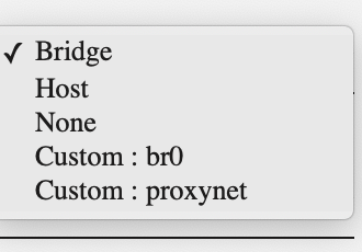

CryPt00n Posted November 29, 2020 Share Posted November 29, 2020 (edited) Hi, i´m using SWAG for multiple services now, but want to change the ports/give it an own ip. I want swag to have an own ip in my network, to resolve all my domains in my lan to it and dont have problems with ports (80,443). I´m also running a pi-hole as main dns in my network, but not on unraid, its on a pi 4. I created a own docker network for all services which have to use this reverse proxy like in the spaceinvaderone tutorial, but cant give the correct ip to the docker due subnet issues. I have 2 NICs in my system, the onboard one and a second PCIe NIC. I also tried to create a custom docker network by using macvlan, but then i couldnt enter my network informations like i need. Are I´m on the right way with this or is there a trick i can use to get this run? My NIC configuration: eth0 IP: 192.168.2.131/24 Gateway: 192.168.2.1 eth1 IP: 192.168.2.131/24 Gateway: 192.168.2.1 Available Network types: Routing: Available networks: Docker custom networks: Thanks Edited November 29, 2020 by CryPt00n Adding NIC informations Quote Link to comment

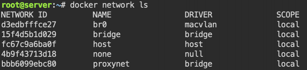

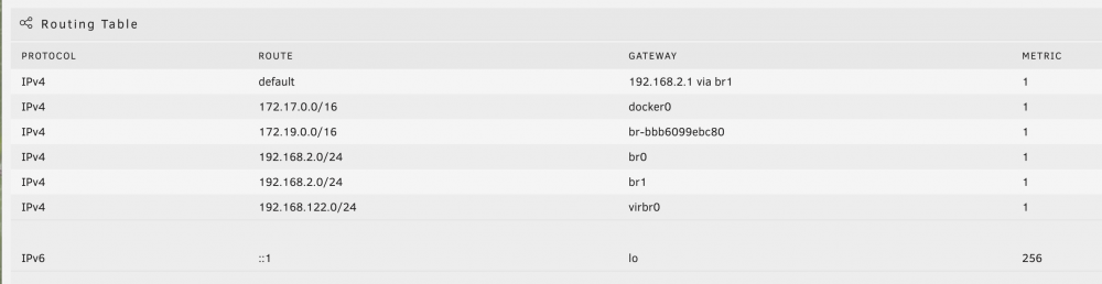

McFex Posted December 2, 2020 Share Posted December 2, 2020 (edited) The question which makes this post relevant in this forum is further down in bold. On 11/29/2020 at 9:36 PM, CryPt00n said: Hi, i´m using SWAG for multiple services now, but want to change the ports/give it an own ip. I want swag to have an own ip in my network, to resolve all my domains in my lan to it and dont have problems with ports (80,443). Hi guys and CryPt00n, I have kind of a similar setup as CryPt00n here (I quoted him mainly to connect the posts, since we might be on a similar way). Except it's not an SBC, but a Fujitsu I want to have as kind of a gate-server between router and unRaid server. I installed Cent OS 7 and on it docker and docker-compose. I am aware I'll have to open the ports on the centos firewall. Now I need to know how my docker-compose file would have to look like. I tried to translate the docker setup from unraid into a docker-compose.yml file: version: '2.1' services: swag: image: ghcr.io/linuxserver/swag container_name: swag cap_add: - NET_ADMIN environment: - PUID=1000 - PGID=1000 - TZ=Europe/Berlin - URL=mydomain.com - SUBDOMAINS=www,flexcloud,sonarr,radarr,hydra2,sabnzbd,tautulli,minecraft,documentserver,galacticraft - VALIDATION=http - EMAIL=my@email volumes: - /proxyflex/config:/config - /proxyflex/www:/config/www ports: - 443:443 - 80:80 restart: unless-stopped Is something missing? I also can't figure out what exactly my proxy_conf files would have to look like. Let's take nextcloud, for example: server { listen 443 ssl; listen [::]:443 ssl; server_name nextcloud.*; include /config/nginx/ssl.conf; add_header Strict-Transport-Security "max-age=15768000; includeSubDomains; preload;"; client_max_body_size 0; location / { include /config/nginx/proxy.conf; resolver 127.0.0.11 valid=30s; set $upstream_app nextcloud; set $upstream_port 443; set $upstream_proto https; proxy_pass $upstream_proto://$upstream_app:$upstream_port; <= put unraid server IP there?* proxy_max_temp_file_size 2048m; } } Could someone be so kind and tell me the correct configuration? For example what is the correct resolver IP if I host the swag container on the Fujitsu? * Which IP to put there? Unraid official IP? Or the IP unraid has in the network created by swag on the Fujitsu? How would I find that out? Or not unraid's IP at all but the nextcloud container's on unraid? I understand that the swag container and the other docker containers supposed to use the reverse proxy have to be in the network created by swag. How would I do that in unraid with an external swag installation? Simply check the networks on the Fujitsu and assign the corresponding IPs to the dockers on the unraid server in the docker setups? Or would I create the same network in unraid? How would I do that? I am fairly new to linux and unraid and docker, but I want to learn. I tried to be as clear as possible about my needs and hope someone will help me. Thank you in advance and cheers Edited December 2, 2020 by McFex Quote Link to comment
CryPt00n Posted December 2, 2020 Share Posted December 2, 2020 1 minute ago, McFex said: Hi guys and CryPt00n... Hi McFex, i got a solution for my problem on reddit, maybe it also helps you. I configured my nextcloud.subdomain.conf like this: server { listen 443 ssl; listen [::]:443 ssl; server_name cloud.*; include /config/nginx/ssl.conf; client_max_body_size 0; location / { include /config/nginx/proxy.conf; resolver 127.0.0.11 valid=30s; proxy_pass https://192.168.2.131:444; proxy_max_temp_file_size 2048m; } } So i just removed the whole variable things and added the ip/port of my nextcloud docker into it. Now it works fine for me. I think this should also work for your case. I also added my domain (cloud.XXX.de) into my dns so all my devices now connect by domain to the service. Doesnt matter if its inside my LAN or WAN. Quote Link to comment
McFex Posted December 3, 2020 Share Posted December 3, 2020 1 minute ago, CryPt00n said: Hi McFex, i got a solution for my problem on reddit, maybe it also helps you. Hey CryPt00n, thanks for sharing - I'll try that. My DNS is already setup, since I used to run swag on unraid. So there is no need for setting up an extra network in unraid? Why? (As I said, I want to learn ) Quote Link to comment
CryPt00n Posted December 3, 2020 Share Posted December 3, 2020 (edited) 16 minutes ago, McFex said: Hey CryPt00n, thanks for sharing - I'll try that. My DNS is already setup, since I used to run swag on unraid. So there is no need for setting up an extra network in unraid? Why? (As I said, I want to learn ) Hi McFex, i dont know exatly why no extra network is needed, just got this hint from a reddit user: Quote Creating a docker network for SWAG isn't a requirement, really. It's a step that can make configuring reverse proxies easier because most of them already have been setup and it's just a matter of enabling them. I just had to switch to a custom network (br1 in my case) to set an own ip for SWAG and change my config. Maybe someone more experienced could explain this network thing for you/us. EDIT: But one question: Why do you want to use a vm with CentOS for SWAG? You can just create a SWAG docker with own IP on unraid and open the ports just for this address. Same effect, less used Ressources. Edited December 3, 2020 by CryPt00n Quote Link to comment
McFex Posted December 3, 2020 Share Posted December 3, 2020 (edited) On 11/29/2020 at 7:38 AM, reyes136 said: I ran a test at this site https://whatismyipaddress.com/ds-check and it only shows IPv4 address, and says IPv6 not detected , IPv4/IPv6 Dual Stack Test. Does this mean that my provider is not using Dual-Stack or DS-Lite? Well, the site says: "...if only IPv4 is detected, then your ISP doesn't provide Dual-Stack yet". But I am not sure, if that means you are also not on DS-Lite. Dual-Stack and DS-Lite are NOT the same, btw: Dual-Stack means you are reachable from the internet via IPv6 and IPv4. DS-Lite means that you are NOT reachable from the internet via IPv4, because several users share one public IPv4 which then gets tunnelled through the IPv6 network of the provider to the different users. A better way to find out is to check in your router settings or write a quick mail to your provider. Edited December 3, 2020 by McFex Quote Link to comment
Retrogamer137 Posted December 3, 2020 Share Posted December 3, 2020 (edited) Hi there, I'm using swag to reverse proxy to my nextcloud and some other dockers. Since I use a duckdns subdomain and therefore generate a wildcard certificate I can't open my "main domian" XXX.duckdns.org because this is not covered in the certificate anymore. Is there any way to redirect incoming traffic from XXX.duckdns.org to one of the new subsubdomains I created and which work like nextcloud.XXX.duckdns.org? Sorry if this question might me stupid, but I don't know much about this. Edited December 3, 2020 by Retrogamer137 Quote Link to comment
Cytomax Posted December 3, 2020 Share Posted December 3, 2020 4 hours ago, saarg said: Doesn't look like you are using unraid, so go to our discord server or post on our discourse forum to get help. I went to the discord server and found an answer i thought i would post it here in case it helps anyone else out all i had to do was change set $upstream_app homeassistant; to set $upstream_app home-assistant; Quote Link to comment
McFex Posted December 3, 2020 Share Posted December 3, 2020 (edited) 6 hours ago, CryPt00n said: Maybe someone more experienced could explain this network thing for you/us. Hmm, I'm sorry I didn't think of it earlier, since I stumbled upon this a while ago and then forgot. https://docs.linuxserver.io/general/swag pretty much explains it all..., more or less . I haven't understood everything yet, but I'm on my way there... I have more questions, but I'm gonna ask them on discord. Thank you 👍 Edited December 3, 2020 by McFex Quote Link to comment
