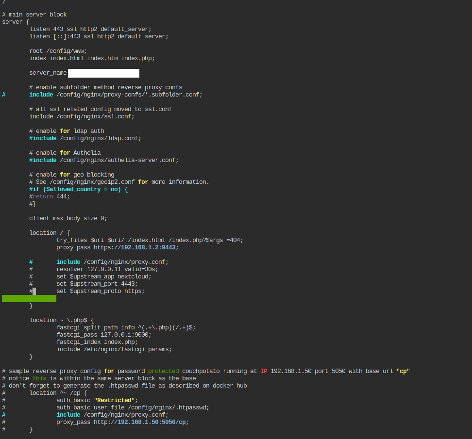

Most of my subdomains are setup and working with swag.  But how do I setup the main domain?  In the unraid template I set "only subdomains" to false and this seems to ahve worked because going to www.mydomain.com gives me an ssl cert, but right into this screen
I assume I need to edit the file "default" in  the site-confs folder but I tried that, replacing this text
location ~ \.php$ {
		fastcgi_split_path_info ^(.+\.php)(/.+)$;
		fastcgi_pass 192.168.1.102:8096;
		fastcgi_index index.php;
		include /etc/nginx/fastcgi_params;
With this which is used in my subdomain file (which works):
location / {
        include /config/nginx/proxy.conf;
        resolver 127.0.0.11 valid=30s;
        set $upstream_app jellyfin;
        set $upstream_port 8096;
        set $upstream_proto http;
        proxy_pass $upstream_proto://$upstream_app:$upstream_port;
        proxy_set_header Range $http_range;
        proxy_set_header If-Range $http_if_range;
    location ~ (/jellyfin)?/socket {
but it doesnt work.  The setup video only mentions setting up the reverse proxy for sub domains, not the main domain.

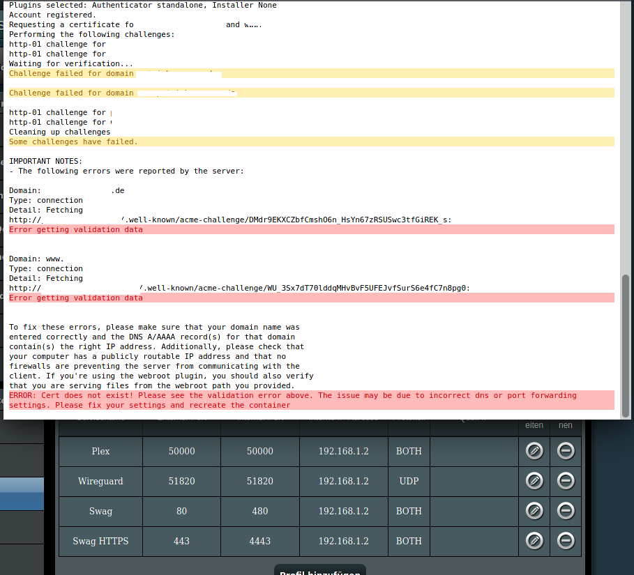

Hey community,
i add in nextcloud config.php trusted domains -> mywebsite.de
in the pictures you see my swag default config with the error of letsencrypt.
i don't understand why the port doesn't work.
(the blanc one is my website)
what do i wrong ? i just wanna use swag (not reverse proxy)
nxc: 192.168.1.2:9443
swag: 192.168.1.2:4443 ( is closed )
Solution: check my domain that he knows my ip

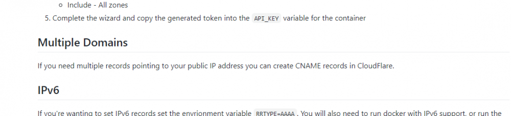

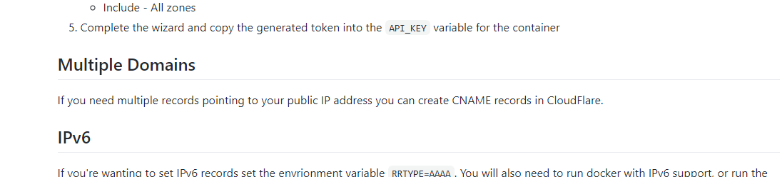

6 minutes ago, strike said:
Have you looked at the readme at github? I think it's mentioned somewhere else too and certainly in this thread. From the readme:
I did read the read me but it does not really mention anything about using a second domain or "-e EXTRA_DOMAINS" the only about multiple domains I see is this. Nothing about using a whole other domain. Just subdomains.
