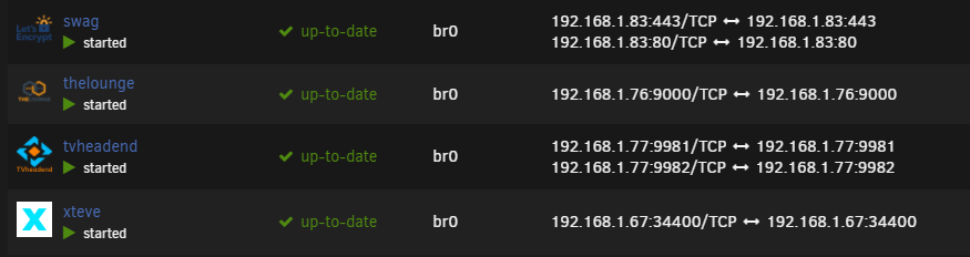

i personally dont use the "proxynet" feature, i use the custom:br0 with individual ip's

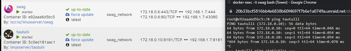

but may post a screen like this from your docker(s) around swag how this looks like.

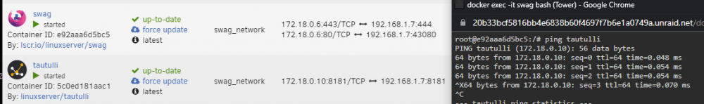

Heres an example with tautulli:
domain.com/tautulli works if tautulli.subfolder.conf looks like this:
set $upstream_app 172.18.0.10;
set $upstream_port 8181;
set $upstream_proto http;
proxy_pass $upstream_proto://$upstream_app:$upstream_port;
But if I have it like this I'm just getting 404 on domain.com/tautulli
set $upstream_app tautulli;
As you can see I'm still able to ping tautulli from my swag-container - and it resolves to the correct IP, so I'm not really sure whats going on here.
