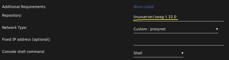

errantlabour Posted November 22, 2022 Share Posted November 22, 2022 1 hour ago, Urbanpixels said: my swag is refusing the run with the below error: An unexpected error occurred: AttributeError: module 'certbot.interfaces' has no attribute 'IAuthenticator' Had to force version 1.32.0 to get it working again. I just found this issue too. Forcing previous version seems the only fix for now. Has been flagged on github so hopefully a fix won't take too long https://github.com/linuxserver/docker-swag/issues/297 1 Quote Link to comment
Germy_Lizard Posted November 22, 2022 Share Posted November 22, 2022 6 hours ago, Urbanpixels said: Had to force version 1.32.0 to get it working again. Hey there, was wondering how you were able to accomplish that? New to Unraid. Thanks! Quote Link to comment
MarcoYuen Posted November 23, 2022 Share Posted November 23, 2022 8 hours ago, Germy_Lizard said: Hey there, was wondering how you were able to accomplish that? New to Unraid. Thanks! You can specify the image version in the Repository field. Quote Link to comment

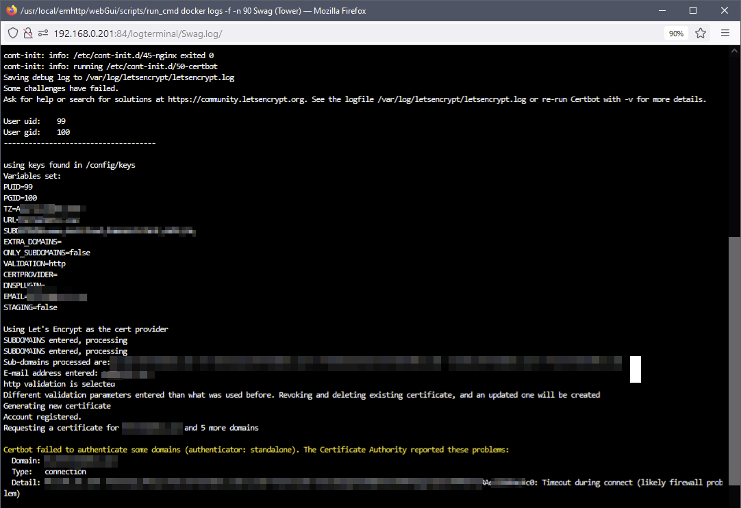

JM Benoit Posted December 8, 2022 Share Posted December 8, 2022 (edited) Hi All, First time posting. Normally I struggle through solutions, but I have hit a bit of a wall. Long story short Swag was working normally with several dockers including OpenVPN up until the day my router failed. I have since purchased and setup a new router (w/ port forwarding) but I cannot get Swag to work properly. So far I have tried the following checked SWAG access via local IP - CONFIRMED checked port forward is working correctly by checking swag logs turning p.forward on and off - CONFIRMED deleted app data and restarted swag created new docker network So far it looks like swag is running but I cannot get the swag splash page / or docker to load when using a web address. Swag log attached. Any tips, pointers, direction is appreciated EDIT: Log now shows this error repeatedly ginx: [emerg] cannot load certificate "/config/keys/cert.crt": BIO_new_file() failed (SSL: error:02001002:system library:fopen:No such file or directory:fopen('/config/keys/cert.crt','r') error:2006D080:BIO routines:BIO_new_file:no such file) Thanks John Swag Log .txt Edited December 8, 2022 by JM Benoit Quote Link to comment

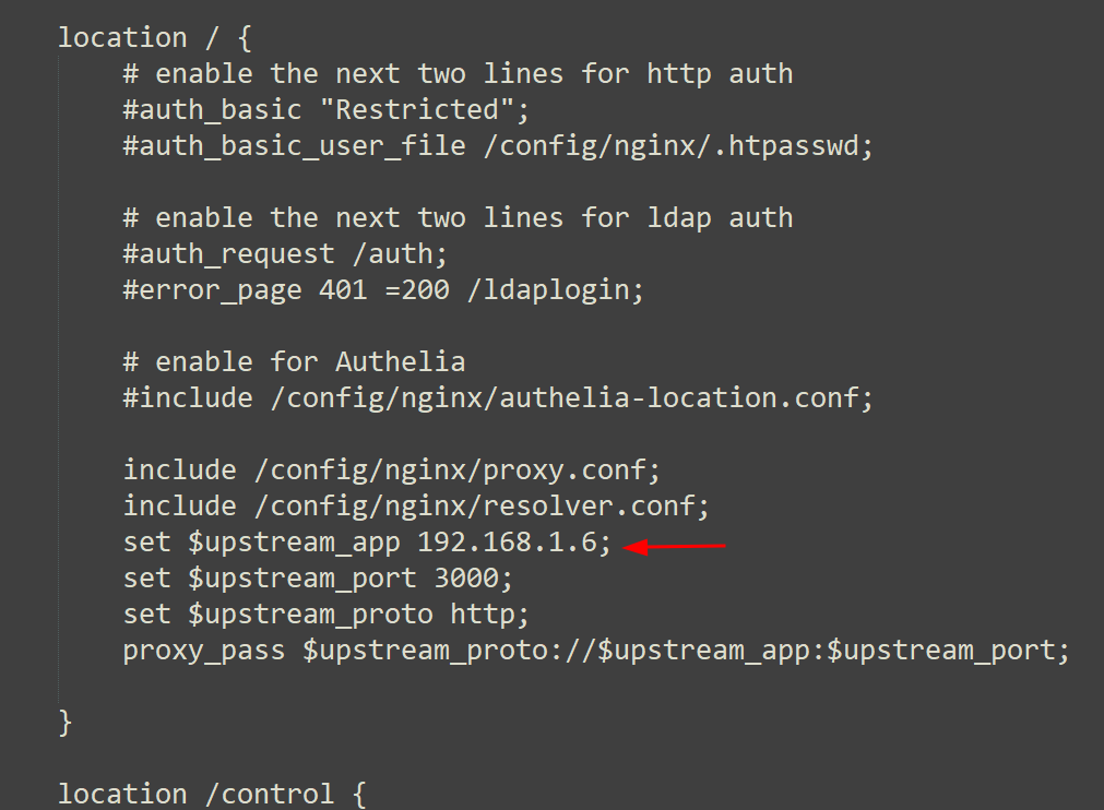

talmania Posted December 8, 2022 Share Posted December 8, 2022 I'm hoping someone can help me with my thought process and see if I'm off base or what I'm thinking is possible with my current swag configuration: It's working perfectly for all my various containers on Unraid---however I have a new use case where I want to reverse proxy to another host on the local network (completely separate network outside the dockernetwork I'm using). Routing is going to be a problem no? My goal is to reverse proxy external traffic looking for server1.myhome.com to hit SWAG and then proxied to server1 internal IP address and port. My guess is that the routing from the docker network to the local area network (which unraid sits on as well) is going to the problem? Would I use the subdomain template to reverse proxy this request? Thanks for any advice and insight! Quote Link to comment
alturismo Posted December 9, 2022 Share Posted December 9, 2022 8 hours ago, talmania said: Thanks for any advice and insight! to make it short, yes this works, may rather just use the LAN IP instead NAME in the proxy conf here a sample running adguard on a sep mashine 1 Quote Link to comment
talmania Posted December 9, 2022 Share Posted December 9, 2022 12 hours ago, alturismo said: to make it short, yes this works, may rather just use the LAN IP instead NAME in the proxy conf here a sample running adguard on a sep mashine Thank you! I optimized my search and actually found your response earlier in this thread with a similar question. It was EXACTLY what i needed and helped immensely. Thank you very much for helping! 1 Quote Link to comment

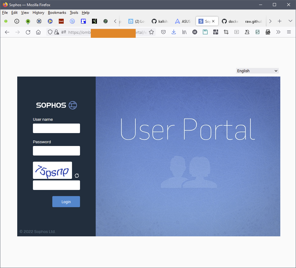

hernandito Posted December 20, 2022 Share Posted December 20, 2022 (edited) Hi guys. I have a mystery that I cannot resolve. For ages my Swag as been performing perfect. But I have ran into an isue. I have my own domain being managed by No-IP.com. Their portal currently lists my external IP properly for my domain and subdomain. In Swag, I have my domain and subdomains. Starting last week, when trying to login with https://mydomain.com, I get a certificate warning. If I ignore the warning I get this: I have no clue what this is. Name and passwords don't work. I don't have anything Sophos installed. At one point I called No-Ip with the issue, they did not know what was causing this. They said my external IP did not match that of something from my ISP. They suggested I get a new external IP. I called my ISP, they said that to change IP, I needed a new cable modem from them. I got the new cable modem and it worked. Five days later, I am getting the same Sophos thing again!! In Swag docker setup, I edited my sub-domains. When relaunching Swag, it says new LE certificates are needed (as it should) and that it will generate them. Then validation fails (see image). Swag docker is still running on my server. But I cannot get to my web site even with the internal IP address...!! Then on my browser I try https://mydomain.com; I get the same Sophos portal login screen!! This is telling me that, somehow, the domain is being directed someplace else. Obviously this is why it cannot pass validation. I get the same result if I try to do this from my home internet connection or when I am at work. At one point (when the problem first happened), I swapped my router and had the same result. What is causing this??? Google did not help... Has my domain been hijacked? How is it being re-routed? Thanks, H. P.S. I was at least able to get my internal web URL working by restoring my appdata backup. Using the certificates prior to me editing the docker configuration. This will fail once the certificates expire. I still cannot get in from the outside. Edited December 20, 2022 by hernandito Quote Link to comment
